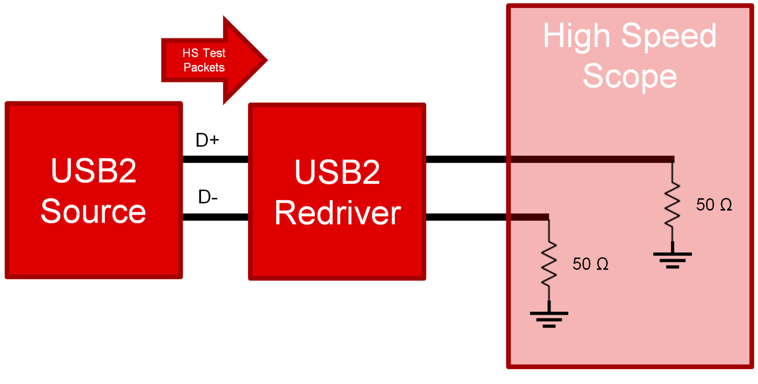

  • Hi SHH,
    You should leave the test PC connected to the HS scope with 50 Ohm termination. I believe when the test fixture is in INIT it is connected to a USB device. USB devices will not turn on high speed termination when Host is in test mode due to lack of HS enumeration.
  • Hi Malik,
    Would you please draw a draft to show how to connect the 50ohm termination?
    BR,
    SHH
  • Hi SHH,
    That 50 ohm termination should be provided by the High Speed Scope. See attached image for reference.
