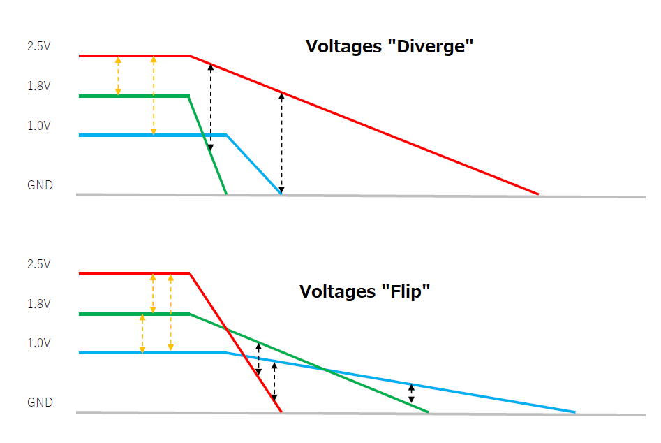

In two-supply mode, the DS states there are no requirements for which line (2.5V, 1V, I/O) is powered in what order...
But should care be put into things such as voltage rails "diverging" or "flipping?"
(See the below image for details)

  • Hi Nikhil,
    By diverge, I mean:
    If you shutdown the power rails at the same time, but the supplies have different ramp-down times, you end up with a gradually increasing voltage difference between the rails (as shown in the above image as "diverge"). In such a case, would this "increasing" voltage difference between the rails ever cause an issue for the DP83867IS?
    By flip, I mean:
    If you shutdown the power rails at the same time, but the higher voltage rail has a steeper ramp than a lower voltage rail, then (as shown in the above image) the higher voltage rail could end up at a lower voltage than a rail that was supposed to be at a lower voltage. IE: in the image, see how the blue 1.0V rail starts lower than the 2.5V rail, but during ramp down, there is a time where it has a "higher voltage" than the steeply ramped down 2.5V rail?
    In summary...
    I know that for three-power mode, there is a diode between the 2.5V and 1.8V rails, which (to keep current from flowing through the diode and into the system) you need to keep reverse-biased. This means that for three-power mode, "voltage flipping" of the 2.5V and 1.8V can cause current to flow into the system and may cause issues.
    But for the two-power mode, are there any internal diodes or ways for current to flow between the 2.5V, 1.0V and I/O rails?
    The datasheet does say that for two-power mode there is no specific order for which power supply is powered first, but is there no specification on these timings whatsoever?
    Sorry if this is a little long...but hopefully it gets my concern across.
    Darren
  • Hi Darren,
    Thanks for the detailed description. There is no diode between 2.5V, 1.0V, and IO rails. In two supply-mode, you will not see any issues with one supply back-driving the other.
