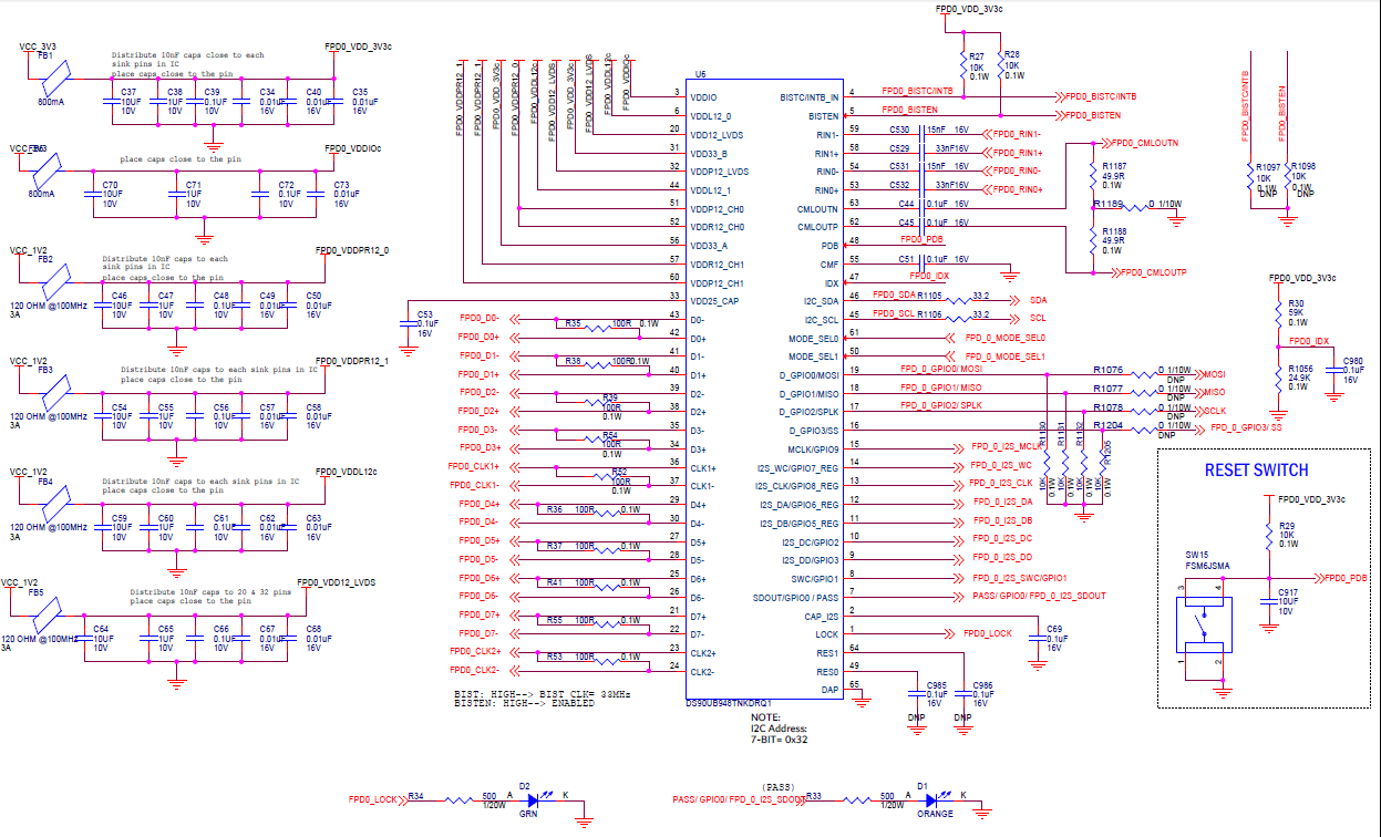

Regarding this DS90UB948-Q1 deserializer, I have designed FPD III to OLDI deserializers for LVDS, RGB, HDMI signals.
Totally three different deserializers in my design, for three serializers inputs (DS90UB947-Q1 for LVDS; DS90UH949A-Q1 for HDMI; DS90UB921-Q1 for RGB) which are coming from a vehicle dashboard silver box unit.
I am attaching the schematic of my design and would like to have your review comments and/or any suggestions.
Thanks in advance.
Pradeep. S
  • Hi Pradeep,
    I will review the schematic and get back to you within one week.
    Charley Cai
  • Hi Pradeep,
    1. You shouldn’t tie BISTEN to 3.3V by default otherwise the device will stuck in BIST mode. Please DNP the R28 and populate R1098.
    2. Suggest using 100nF on RIN+ and 47nF on RIN- for compatibility with all three serialziers.
    3. I didn’t see I2C_SCL and I2C_SDA pull up from attached schematic. Could you confirm that they are pulled to 3.3V or 1.8V?
    Charley Cai
  • Hi Charley Cai,
    Thank you very much for your valuable comments!!
    I will implement the comments in schematic.
    And, I2C SCL & SDA are pulled up to 3.3V, but is not shown in this schematic page.

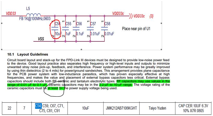

    BTW, I have arrived to a quick query when referring to the layout guidelines and Eval schematics.
    In Datasheet, It suggests power input pin caps must be at least 5 times the input supply used (in 10.1 Layout Guidelines section). But we observed from the EVAL board schematics that for bulk cap (C54) 10uF, 6.3V part is used for power rail VDD pins as shown in attached image.
    As of now, I have chosen the capacitor voltages about 3 times the power rail voltage. Is it okay?
    Please suggest your opinion about this.
    Thanks & Regards,
    Pradeep. S
  • 3x time should be ok.
    Charley Cai
