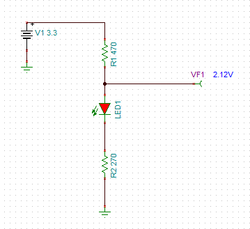

    I'm pretty sure the reason you are seeing 2.1V on the line and 3.3V when you remove the P82B96 is because you are measuring the voltage at net name SDA and net name SCL and not net name SDA_B and SCL_B. The reason for the high signal being 2.1V is likely because of the LED and 270 ohm resistor to GND. You effectively have a resistor divider between the 470 ohm pull up, LED and 270 ohm pull down. If you want to generate LEDs for SDA_B/SCL_B you should use an NFET and tie the gate to the SCL_B/SDA_B to make the connection high impedance and get rid of the resistor divider.
    Here you can see the source of the 2.1V issue.

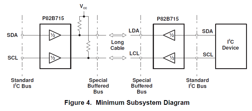

    The second thing I see which could be causing a problem is you are only using one P82B715, this device is meant to be used in a pair like the datasheet shows:
    If you only use one of them with a 470 ohm pull up resistor, in the worst case you are allowing 7mA as your IoL at 3.3V and 10.6mA at 5V when the master/slave pulls low. This could be enough to break/damage the NFET of your master/slave on SDA and SCL. Using two P82B715s allow for them to take the large current hits instead of the master/slave.
    My recommendation is to remove the LED and pull down resistor and then size up the pull up resistor to be ~2k on both sides and slow your clock frequency down if you can to make communication a bit easier (pull ups don't need to be strong when you make your I2C clock slower).

    I'm using P82B715 on both at Master(MCU) & Slave(Inclinometer) ends, so there should not be any I guess. We have replicated the connections of P82B715  at Slave, similar to that of master

    "I'm using P82B715 on both at Master(MCU) & Slave(Inclinometer) ends, so there should not be any I guess. We have replicated the connections of P82B715  at Slave, similar to that of master"
    Your picture shows the mcu is connected directly to the daughter board P82B715. I just want to verify, your actual connection is:
    MCU------P82B715-->------1M Cable-------<-P82B715-------Inclinometer
    ^^Is this correct?^^
