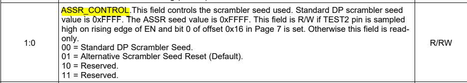

    Ok, so according with the datasheet register 0x5A bits 1:0. mention that what is changing is the seed value (wich by the way is the same for both modes)  not enable or disable R/W.
    Could you tell me which bit is not able to read/write when TEST2 Pin is tied to ground?

    You are saying that the TEST2 pin must be pulled high to enable register read/write.
    The only bits that are blocked by this are the following:
    ASSR_CONTROL. This field controls the scrambler seed used. Standard DP scrambler seed value is 0xFFFF. The ASSR seed value is 0xFFFF.
    This field is R/W if TEST2 pin is sampled high on rising edge of EN and bit 0 of offset 0x16 in Page 7 is set. Otherwise this field is readonly.
    00 = Standard DP Scrambler Seed.
    01 = Alternative Scrambler Seed Reset (Default)
    10 = Reserved.
    11 = Reserved.
    This doesn't say that it disables ASSR, it only says that a different seed is used, and it is the same.
    Could you please explain? My hardware does not have TEST2 accessible and I need alternatives.

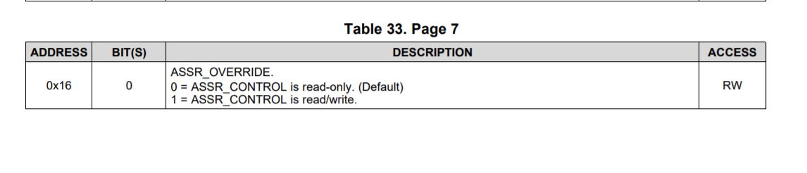

    ASSR_OVERRIDE is on Page 7 Register 0x16
    When TEST2 is low, ASSR_OVERRIDE is read-only. When TEST2 is high, ASSR_OVERRIDE is read/write.

    ======Page 7======
    <i2c_write radix="16" count="1" addr="0x2D">FF 07</i2c_write>
    /> ======ASSR Control to RW from R-only. TEST2 pin must be high at rising edge of EN pin ======
    <i2c_write radix="16" count="1" addr="0x2D">16 01</i2c_write>
    /> ======Page 0======
    <i2c_write radix="16" count="1" addr="0x2D">FF 00</i2c_write>
    /> ======enhanced framing enable. NO ASSR ======
    <i2c_write radix="16" count="1" addr="0x2D">5A 04 </i2c_write>
