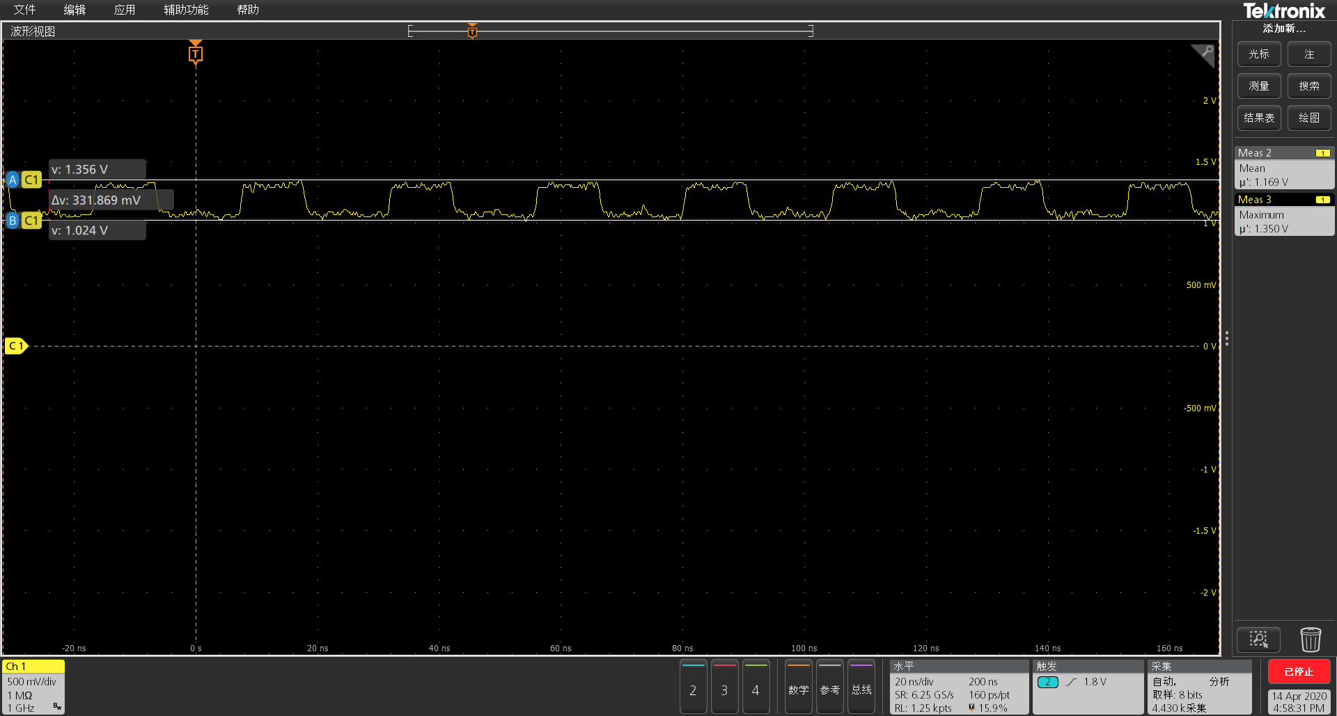

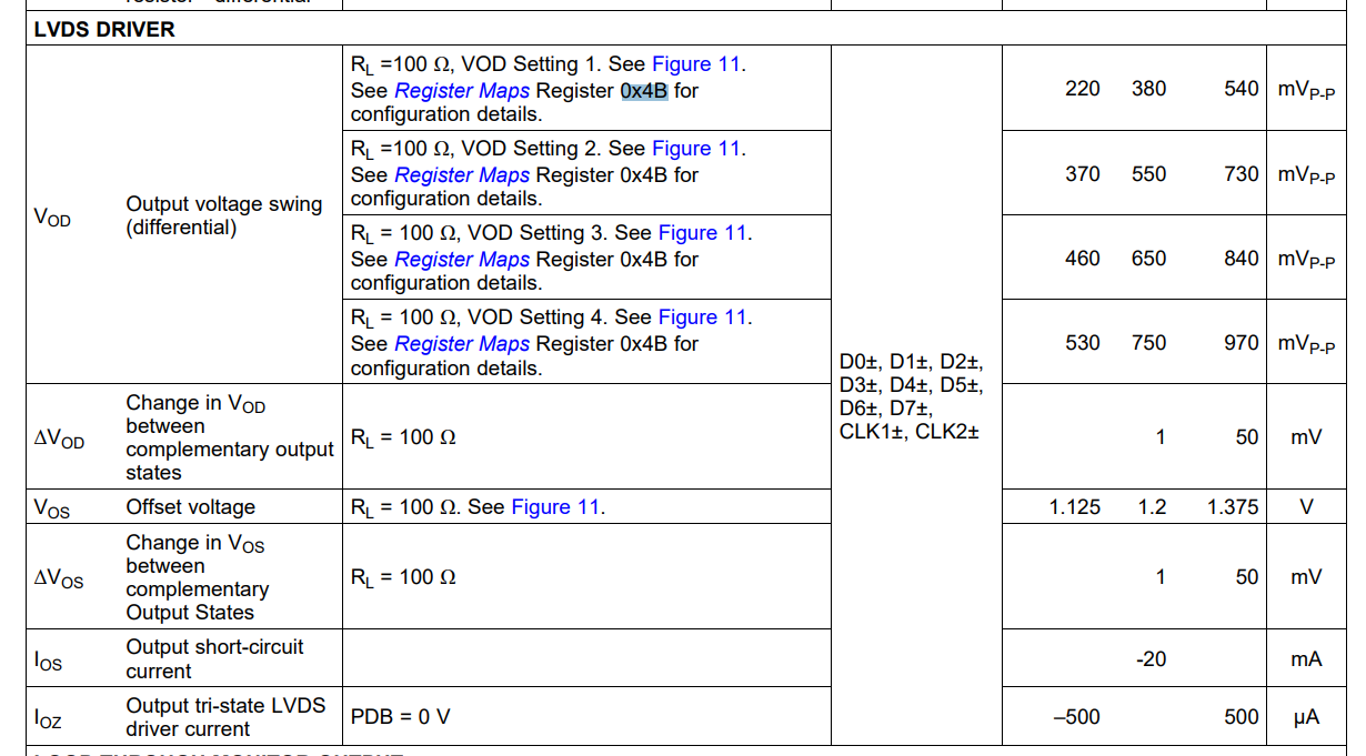

Related to the last question, we improved the swing amplitude after setting, but we found that this change changed the value of Vos (from the original 1.1V to 0.8V, SPEC = 1.125 ~ 1.375V).

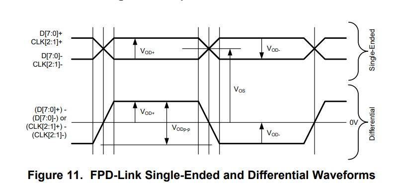

    The LVDS drivers output there signal with a single ended common mode voltage of 1.2V.  This is called VOS in the datasheet. To meet the the input differential voltage then set the VOD setting to the highest level.

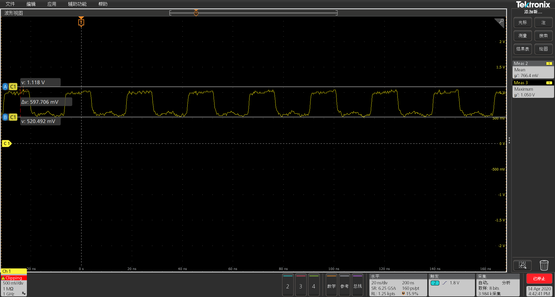

    Whether 0x4B bit [7: 2] = 0x00 or = 0x02 will cause the change as shown below.
    If not, which of the 0x4B default bits caused Vos to change, can the detailed configuration be shared?
    Thank you
    Aihua.
    Figure1.
    Figure2.

    When you are measuring this are you terminating the + and - lanes together using a 100 Ohm terminating resistor? What type of probe are you using?
    Michael W.
  • Hi Michael,
    We have used a 100 ohm resistor in the terminal. The probe model for testing the above waveforms is Tektronix TPP1000 1GHz Probe 300V CATII 3.9pF / 10Mohm. Usually, the probe for testing differential signals is TDP1500 Differential probe 1.5GHz (Range 850mV ~ 8.5V)

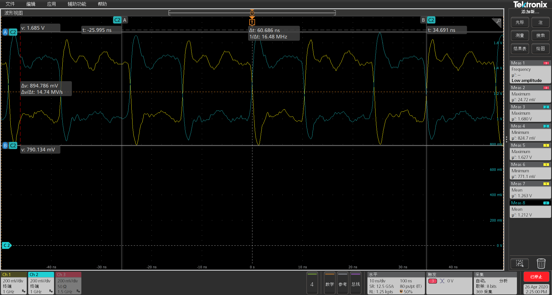

    We gave the following instructions to the software,
    step1. 0x34[7:0]=00000001 //选择port0
    step2. 0x4B[7:0]=00001011
    step3. 0x34[7:0]=00000010 //选择port1
    step4. 0x4B[7:0]=00001011

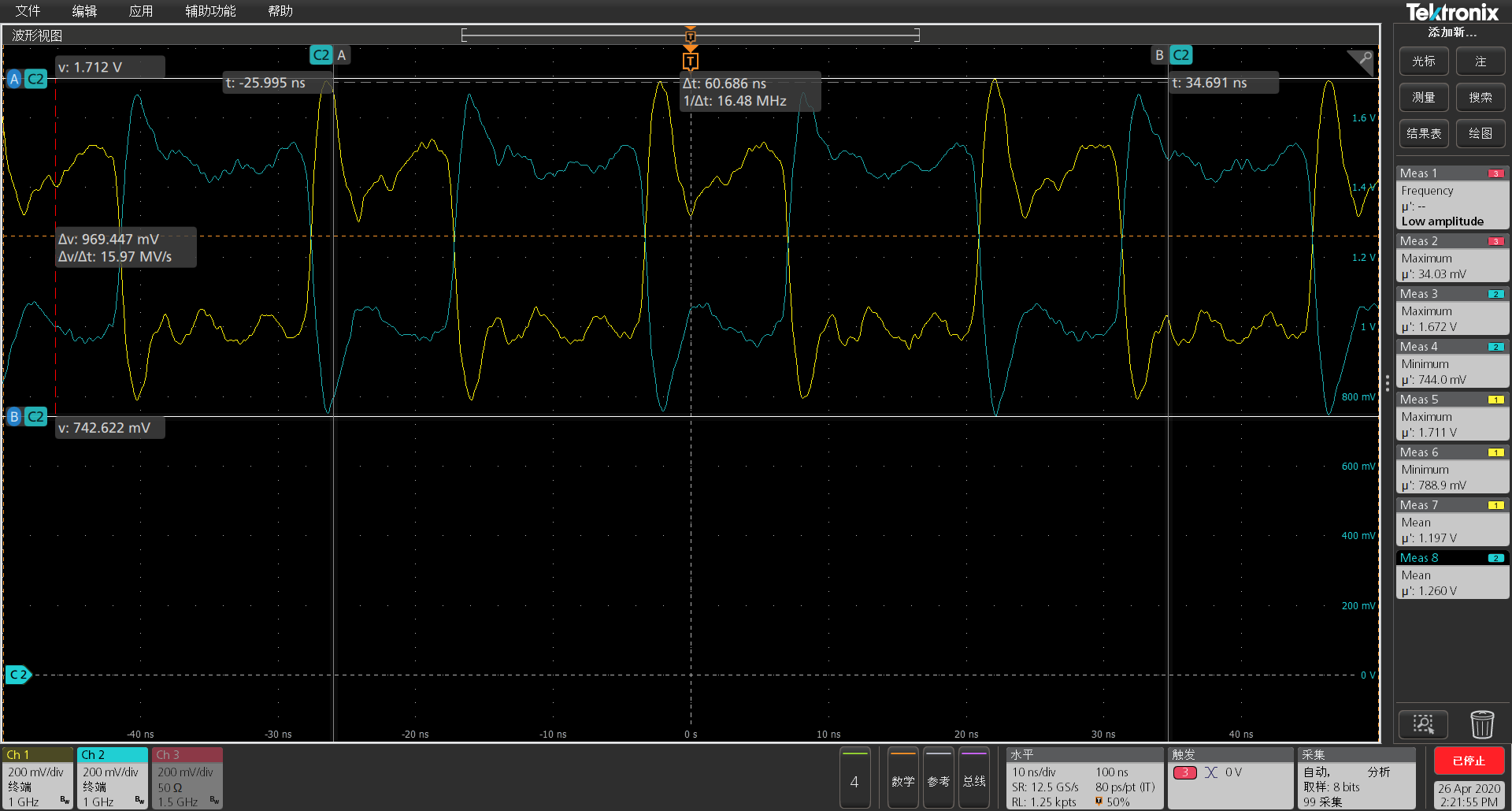

    and the picture is the result of the final test:
    948 CLK1
    948 CLK2
    948 D3
    please see if this is possible.
    Aihua.
  • Hi Aihua,
    "Will the reserved bits be overwritten when 0x08-> 0x03?"
    No this is fine.
    in the two pictures you attached the common mode voltage is ~1.2V which is correct.
