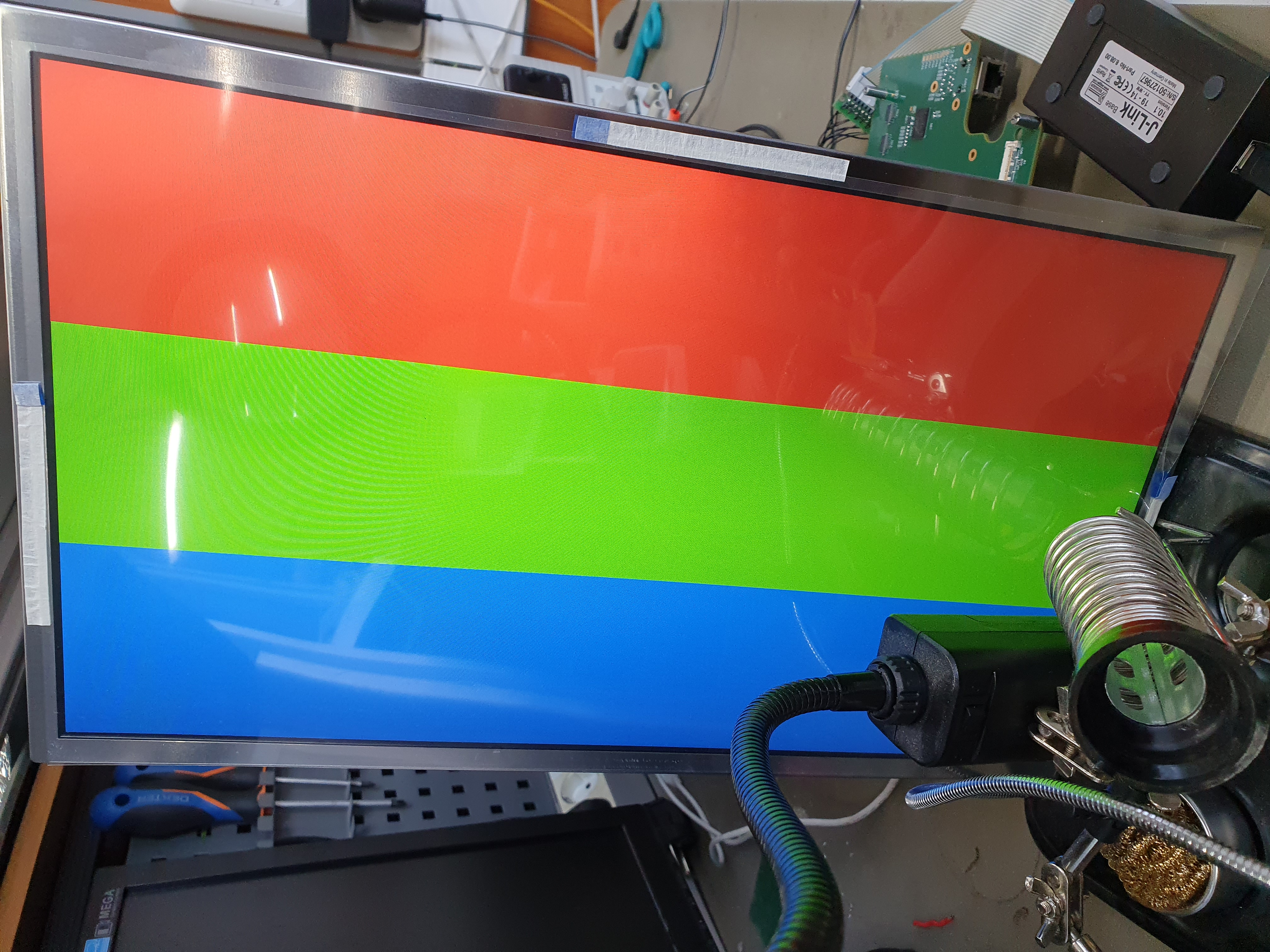

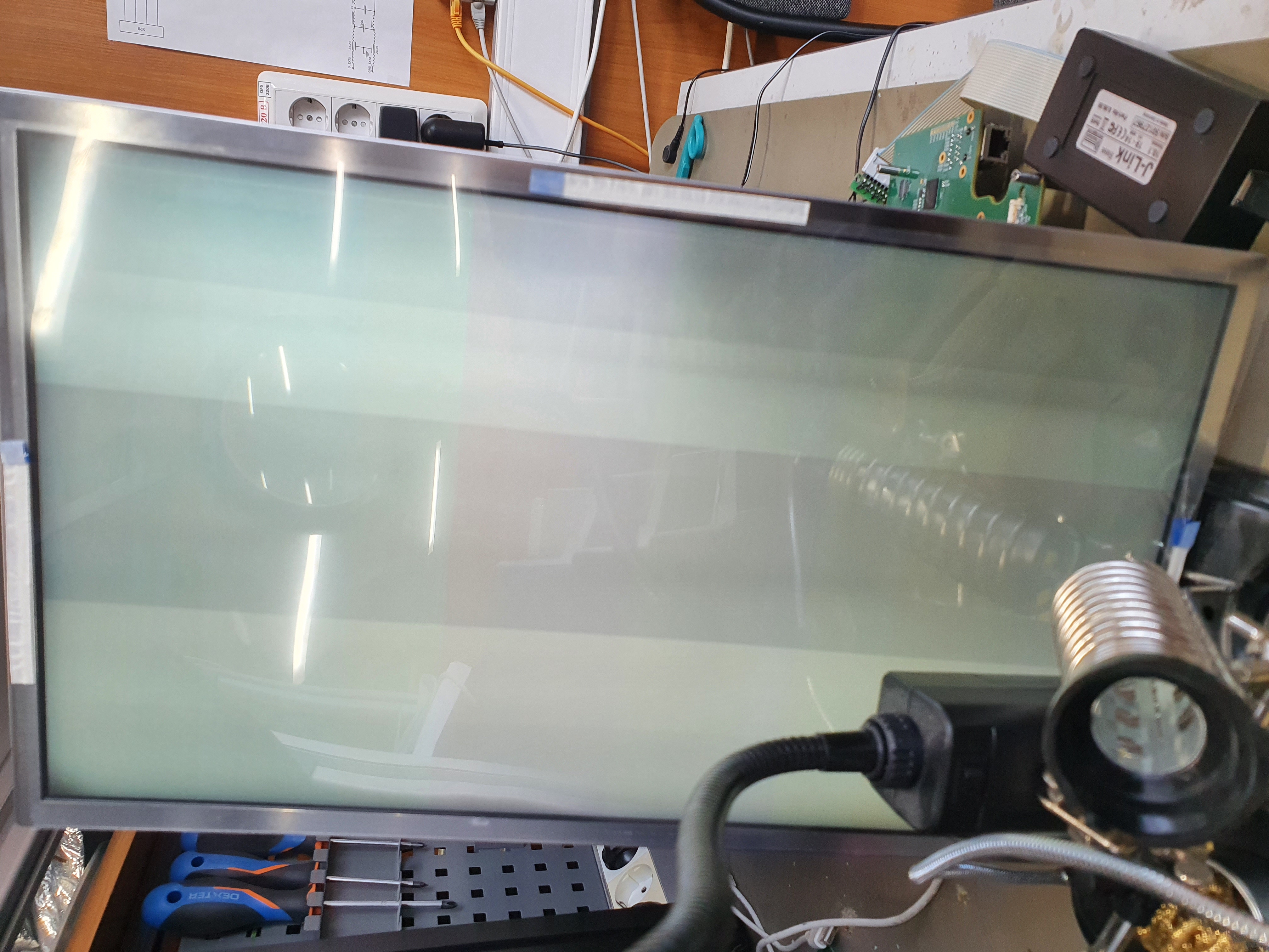

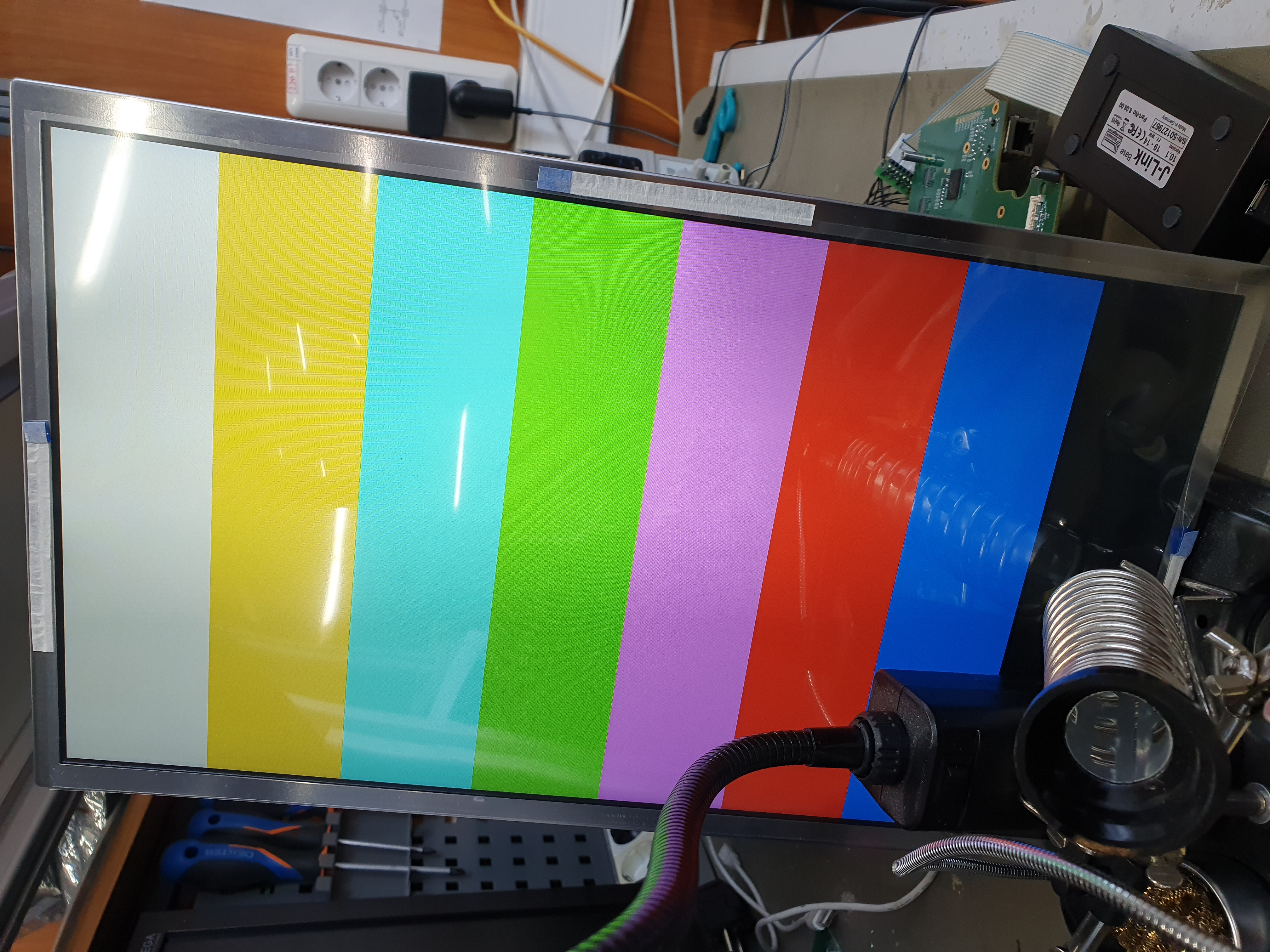

  • 1. Yes, I enabled the color bars, and they appeared on the screen. For horizontal 8 colors pattern - that's ok:
    But for vertical 8 color bars I see only 5 instead of 8, and some offset:
    How can I fix it? 18bpp mode enabled.

    1.62G, and it is works at 2.7G now. I solved my signal integrity problem and Semi-Auto Link Training is successful for both rate - 1.62G and 2.7G.
    I launched my panel at a speed of 2.7G and enabled the color bars.
    I see, that vertiсal bars are all ok, but when I enable horizontal bars I see flickering noise. Сan you tell me which video registers are configured incorrectly?
    Can I be sure that everything is okay with the physical lanes?
    UPD:
    I checked on all color bar patterns, and the problem only appears on the 8-color horizontal bars (COLOR_BAR_PATTERN = 0x4) or 8-grayscalse bars pattern (COLOR_BAR_PATTERN = 0x5). Other patterns display correctly
    1. Vertical 8 bars - ok
    2. Horizontal 3 bars - ok.
    3. horzontal 8 bars - fail. Somethings whrong ?
    It seems to me that color patterns 4, 5 work differently than patterns 0, 1, 2, 3, 6, 7. Since patterns 4,5 correctly displayed earlier at a speed of 1.62G, while others did not. But now, at speed 2.7G, all patterns are displayed correctly, except for 4, 5
