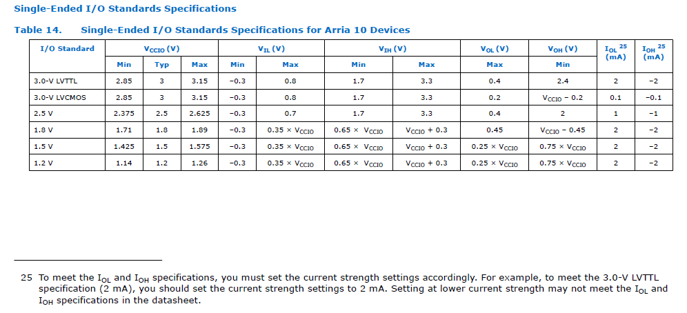

We would like to have an Ethernet communication on our board. Our selected FPGA is Intel Arria-10 and we would like to use TI PHY DP83867E.
IO communication needs to be at 1.8 voltage level. But there is an incompatibility on IO levels at 1.8V level.
Maximum input low the TI PHY can accept is 0.2 × VDDIO which is 0.36V, on the other hand FPGA Outout Low(max) can go up to 0.45V at 1V8 level.
So basically Arria-10 can send 0.45V signal and thinks it is low but for TI Phy this is not a low signal.
My first question will be, maximum input low for TI chip 0.2xVDDIO is accurately tested?
Do you have any suggestion for solution?
