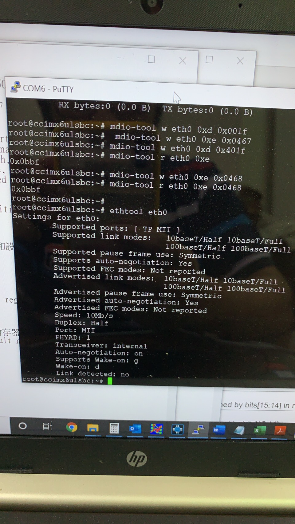

In 100BASE-FX mode, the DP8382 pin 9,10,11,12 is need a capacitively coupled to the SFP?
I not sure has something wrong for the circuit, would you help me check the circuit?

The SGMII interface pins need to be capacitively coupled if the SFP does not provide coupling capacitors internally.
The register write to 0x0468 does not appear to be valid, please follow the Read Post Increment operation in section 8.4.2.7 of the DP83822 datasheet. Please share register data for 0x00, 0x01, 0x0A, and 0x10.

I fixed the circuit to add the DNP callout and share the register data for 0x00, 0x01, 0x0A, and 0x10.
Please reference the attached.
Now I'm confirming with SFP engineer the coupling capacitors internal in the SFP If they did not provide in the SFP, which pins need to add capacitively coupled, is all the RMII connect pin?

I confirmed with the engineer the SFP provides coupling capacitors internally.
please help me check the register, thank you very much.

The problem is 0x00 register must disable Auto-Negotiation.
