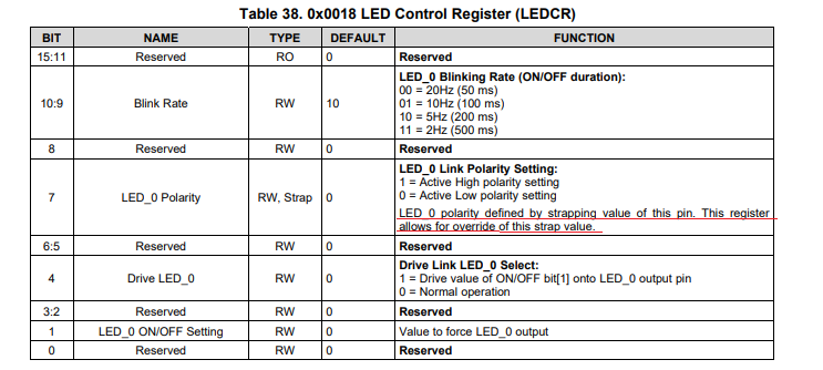

Datasheet shows below for table 38 : 0x0018 LED Control Register. The LED_0 polarity (bit-7) explanation seems boot strap can adjust the polarity. Is it correct? (Is it typos?)

Hi Nagata,
That is correct. The polarity will be based on how you are orienting your LED, however you may manually change it using register writes as well.
