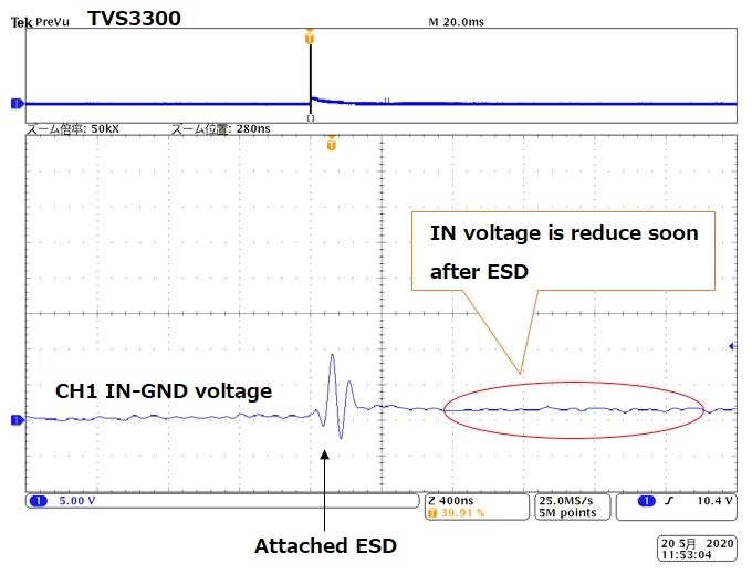

My customer run ESD test and compare the result among TVS diode and TVS3300.
Test Condition:
TVS diode test result
TVS3300 test result :
IN voltage of TVS3300 reduce soon after attaching ESD. The voltage of TVS diode keeps about 40V after attaching ESD.
Could you please give me advice why the voltage of TVS3300 reduce soon?
I guess the parastic diode in TVS3300 is small and it discharge much faster than TVS diode. Is it correct?
