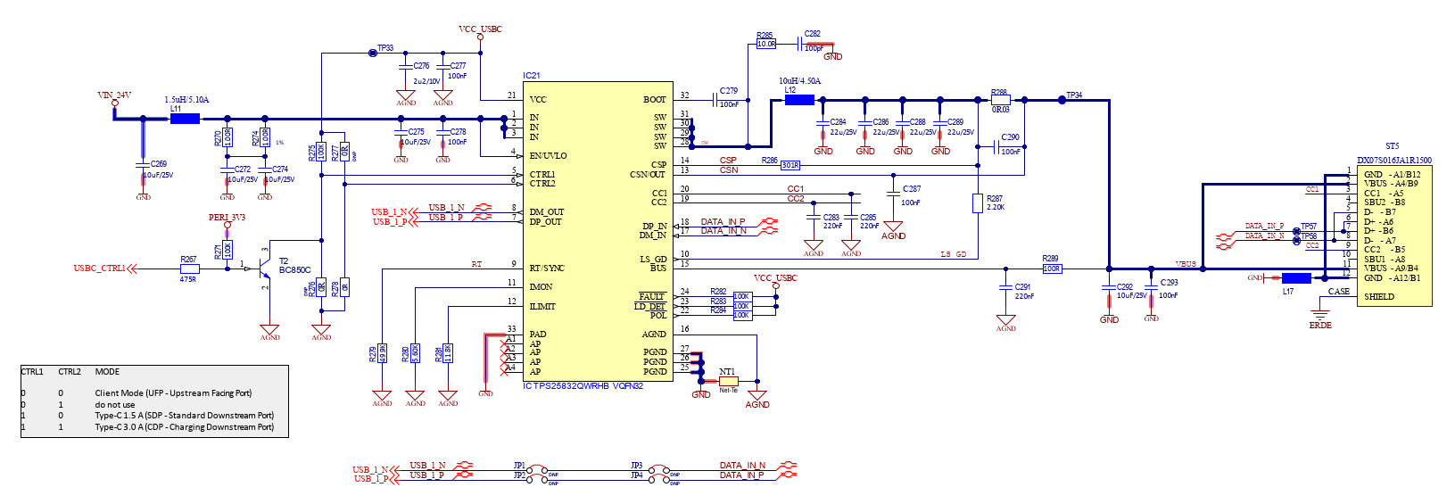

Unfortunately, setting CTRL1 and CTRL2 lines to LOW is not working for client mode.
We have now a design and tried this to download our software to the processor. But the processor is not connecting to computer. By shorting DPM_OUT and DPM_IN pins with JP1 - JP4 it works.
It seems, TPS25832 disconnects the DPM_OUT from DPM_IN pins.
This is how we implemented the controller:
USB_CTRL1 line is connected to processor. When the processor is empty there is a 100k pull-down resistor. So the setting on CTRL1 and CTRL2 is LOW.
I think, we have to use another USB-C controller for this purpose.
Can you recomend one?
Dani

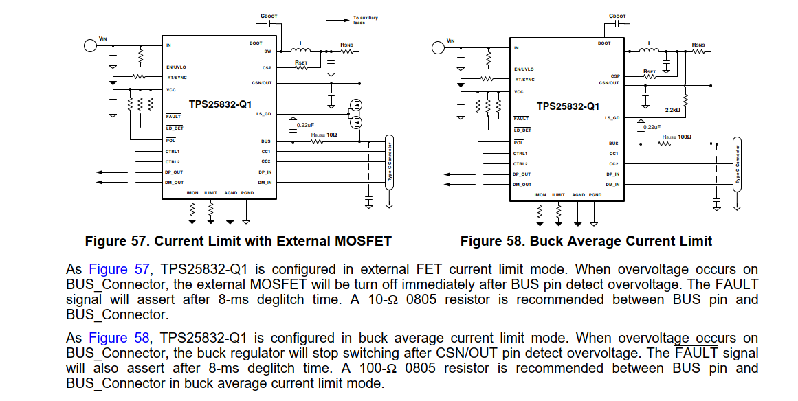

  • Hi Michael,
    Why should R289 be 20kohm?
    Datasheet says 100ohm without FET and 10ohm with FET.
    So in Buck Average Mode, the TPS provides the 5V all the time except when overvoltage is detected?
    I measure 0V at VBUS when nothing is attached to USB-C connector with CTRL1 = HIGH / CTRL2 = LOW and also with CTRL1 = LOW / CTRL2 = LOW.
    I thought the TPS is only providing 5V to VBUS if the correct device is connected with CC1/2 pins on the device side of the cable?
    Unfortunately I can't add the FET on my PCB now, this has to be done in the next revision of the Layout.

  • Hi Michael,
    No as in the title, the schematic and the datasheet I posted, we use the TPS25832-Q1.
    I switched the resistor now to 20kohm.
    So with CTRL1 and CTRL2 LOW TPS25832 is not providing 5V (USB cable not attached at startup). This is correct and the behaviour I want, because we than plug an USB-Cable from PC to the TPS25832 and providing 5V from PC. This is for client mode and we dont use the 5V from PC.
    But in this case we need the datalines connected to the processor to download our software.
    But this don't happens.
    The other case when CTRL1 = HIGH and CTRL2 = LOW, we use to connect USB-Devices to the TPS25832. Then we need 5V provided by TPS25832.
    My plan is when booting the processor, the TPS25832 is set to client mode. And after bootet up, we switch to the USB-C mode by setting CTRL1 to high.
    Is this even possible to switch the CTRL1 line from High to Low when TPS25832 is powered and running?
    I tested the TPS25832 now also with an USB-device attached.
    In both cases (client mode and device mode) TPS25832 provides 5V to the BUS after attaching a device. So also in client mode, when an USB-device is connected the TPS25832 provides 5V.
