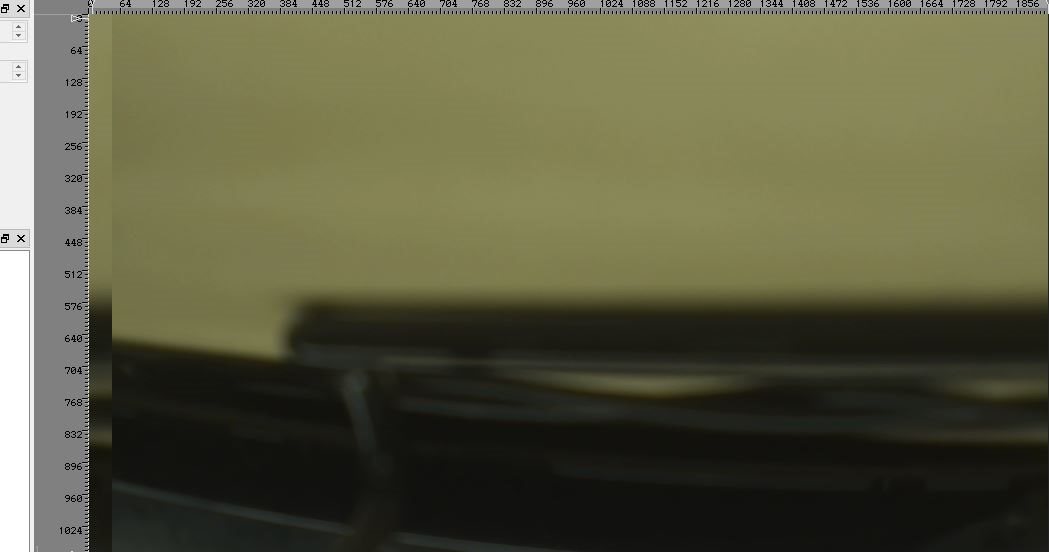

DS90UB954-Q1: When 0x7c register is configured 0xc0, split screen will appear, otherwise, black screen will appear
Part Number: DS90UB954-Q1

    1. in fact  ,if set the  0x7c (serializer  953 csi mode.),high probability occurrence split .
    if do not set 0x7c,low probability occurrence split .but maybe have dark screen. means no output.
    2. when split  read the value as follows
    [0xdB  0x4d 0x4e]   data is  [0x7b, 0x33, 0xfd]
    and 0x7A = 0xf
    some advice?
    thanks

  • Hi Nick
    ok,let us focus on the settings.
    I test the setting again.
    if set the  0x7c [c0] (serializer  953 csi mode.), first open , it must be split.
    if do not set 0x7c,first open,it do not have split.
    why?
     from  datasheet  can see on csi mode ,no matter whether 0x7 is set or not, it should not work.(means set or not ,do not affect the output)
    in fact ,it affect the output on csi mode. why?
    by the way ,if do not set 0x7c,low probability occurrence dark screen( means no output.)
    thanks

  • Hi Nick
    ok, in fact,we do not config 0x7c in csi mode(953),
    test the AEQ is ok,meet the requirements.
    However, there also will be occasional split . how to check it ?
