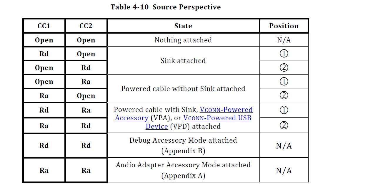

Hi Team,
My customer is using HD3SS6126 and output connector wold be type C USB 3.0. They want the USB host can work with the cable orientation detection. They want to use CC pins(High/Low) to switch HD3SS6126. Following is block diagram planning would be and need your help to see if workable or not.
( The output is fixed for 5V/0.9A.)
