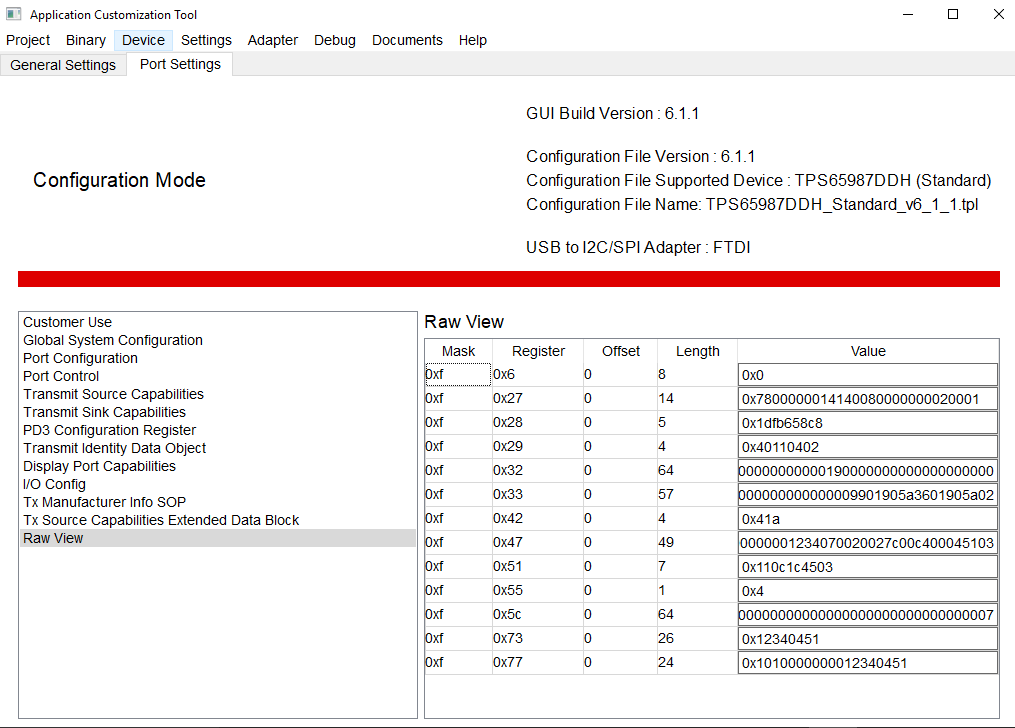

  • Hi Adam,
    Pls. Help on previous post. Also find attached set of registers which customer wants to write and they are not to.
    blob:null/08035898-dcd6-4ad2-afd3-2c37ddca6fea
    Mitesh

  • Thanks Adam,
    There are few registers they are not able to write or modify, can you guide us for the same?
    Here is the attachment.
    Mitesh
    Would you be able to elaborate more? Which registers are they unable to modify?
    Also are they modifying these registers using the GUI or their embedded controller?
    If they are using the embedded controller, would you be able to share a I2C capture of their communication?
  • Hello Adam;
    Myself Chirag Solanki; working on this project. Mitesh Patel (TI) is supporting us for the USB PD configuration issues and requirements for this design.
    Regarding your query; we would like to write the few registers such as 0x37 Auto Negotiate Sink; which is not available in GUI list of registers as shown in above image. We want to update this register for the for few parameters such that ANSinkMinRequiredPower or AutoComputeSinkMinPower field while flashing the file into SPI Flash. So we would like to know how can we update the registers which are not part of GUI; that is accessed during the Power On event ?

    You are currently using the standard project template. If you wish to acces the auto negotiate sink register, you must use the advanced GUI template. This is done by clicking Project -> New Project and selecting one of the advanced templates based on your requirements

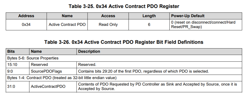

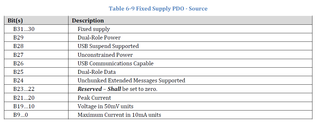

    Only issue is w.r.t. current, they are not able to detect 60 watt and above PD source. If you can point which exact registers need to program may be current or power registers?
    Mitesh
    The current capabilities of the charger can be determine by the active contract PDO register. I've also included how to decode this register based on the Type-C spec
