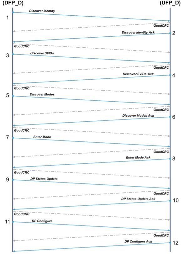

    Do you have a way to capture both the CC and the AUX log file for me to review?
    David
  • Hey David, thanks I don't think I have that capability, but I just talk to our PD SW guy and he said the PD controller's default programming as a PD source will actually not do alt mode negotiation, so until I get a PD config that basically tells the device at the other end of the type C cable to get into DP alt mode this interface will not work.
    In the mean time, you are confident that bypassing TUSB1064 will be acceptable?
    Should there be any series capacitance or pull up / pull down on SBU1/SBU2 on my board to just let the DP display provide the pulls?
    Below is the DP Alt Mode negotiation flow diagram.
    You could let the TS3USBCA420 or the TUSB1064 handle the AUX/SBU switching, but not both. As long as the SBU/AUX switching correctly followed the DP Alt Mode spec and the SBU/AUX switch electrical characteristics in the datasheet are met, then I don't see an issue.
    Per the DP spec, the AC coupling caps and 100k pullup/pulldown should be inside the SOURCE. The AC coupling caps and 1M pullup/pulldown should be inside the SINK. The only thing you would need is 2M pulldown on SBU1 and SBU2.
    David
  • Okay thanks,  I made a new configuration for our TPS65987 device and it successfully negotiated alt mode with the type C laptop it was connected to.  Now I can charge the laptop and have the laptop spit out USB3 AND DP.  and I can see the laptops extended screen on a DP monitor connected through my board with TUSB1064 on it (SBU1/SBU2 bypassing TUSB1064).
