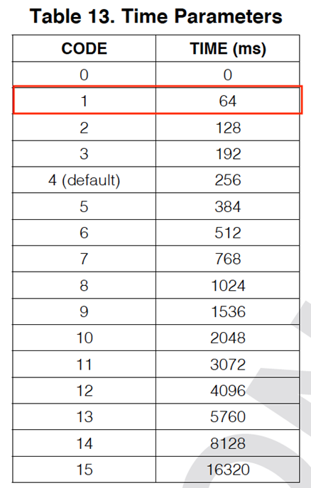

As title, if we set
A1,C1=0;B1,D=64mS
the maximum frequency1000/128=7.8125Hz? it could be more high?

Hi Henry,
You are correct in saying the maximum frequency is around 7.8 Hz. What switching frequency were you looking for? I could potentially find a more suitable product.
