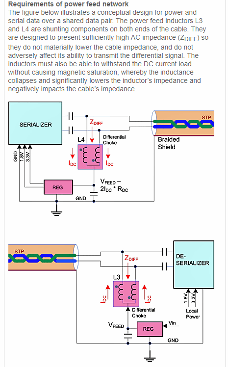

  • Similar concept as Power-over-coax can be used to couple power to STP or STQ. Same twisted pair (the pair that carries the data) can be used as shown above
    You can find more details and info in this EE times article done by the FPD-Link team
    https://www.eetimes.com/combine-power-feed-and-data-link-via-cable-for-remote-peripherals/#
    Vijay
  • Suppose I use concept of power over one of STP in STQ connected to  Port1, Secondary Port2 is used for backchannel, so no need for PoC filter to cover backchannel band in Port1 STP.
    What is PoC filter schematic I can use for my case with 3.36Gbps?
    Article you provided as well as DS90UB913A-CXEVM & DS90UB914A-CXEVM consider case with 1.5Gbps, where only mutually coupled inductors are used to inject power in STP.
    My case 3,36Gbps is closer to  TIDA-020003 with 4Gbps.
    So, can I use above schematic with replacing L5 to (10uH or 4.7uH) mutually coupled inductors   to have impedance of PoC filter > ~20X100Ohm =2kOhm? or it should be modified assuming no backchannel in this STP?
    Thank you.
  • When you use dual link mode, back channel will also be superimposed on both links so you would need to consider the effect of the back channel and forward channel.
    The inductor value should be modified accordingly.
    Charley Cai

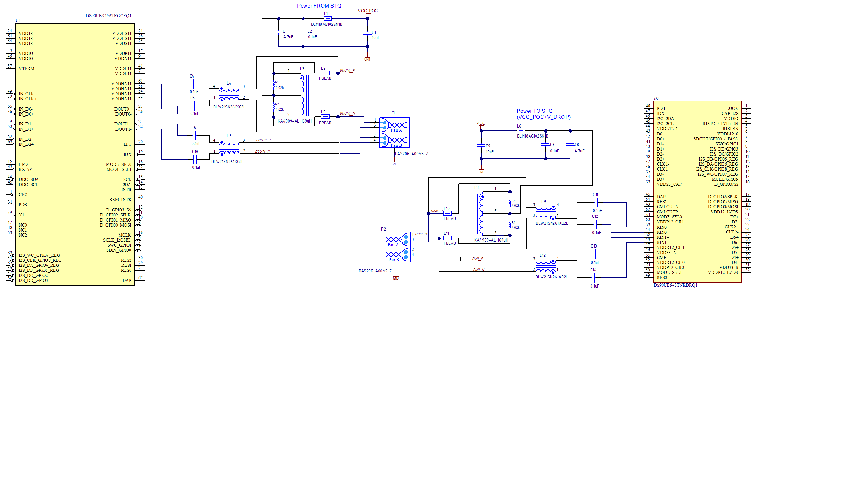

  • I just realized that I didn't past picture I referred .
    So, is it OK to take this schematic of PoC as basis and values of ferrite beads, inductor and just replace L5 with mutually coupled inductors to implement power over STP?

  • Hi Vijay
    Could you please revise roughly schematic of PoC, the case is:
    1. PCLK 175-192MHz,  3.06-3.36Gbps per link, Nyquist frequincy 1,53-1,68GHz, forward channel bandwidth 153-1680MHz
    2. STQ, one pair is for PoC
    I consider to use KA4909-AL as L2
    Thank you.
  • Hello Sergey
                What is the switching frequency of the power switcher? I believe it should couple into the lines AFTER the CM choke but before the connector. Do you have the Impedance curves for L2? You still need to ensure Impedance curves meet our specs at low frequencies to keep the impedance as close to 50 ohms as possible. Also how does the parasitic impedance of L2 look like at Nyquist?
    Vijay
  • Hi Vijay,
    1. Regarding power supply.
    In my case the only device to be powered is Serializer DS90UB949: 1.1V(300-510mA), 1.8V(25-50mA), 3.3V(60mA).
    Perhaps I'll use V_PoC ~5V.
    There is a wish to use only LDOs for all of voltages and such way to eliminate power switching effect to high-speed lines, as it's realized in DS90UB949-Q1 evaluation module where Vin for all LDOs is 5V, but I think it's too much power dissipated on 1.1V LDO TPS74701DRC (3.9V*510mA=2W). Isn't it?
    https://www.ti.com/lit/ug/snlu169/snlu169.pdf?ts=1592683504143&ref_url=https%253A%252F%252Fwww.ti.com%252Ftool%252FDS90UB949-Q1EVM
    Thus  probably will use buck with switching frequency less than back channel band.
    For   DS90UB949 it's stated as:
    The back channel contains the I2C, CRC, and 4 bits of standard GPIO information with a line rate of 5, 10, or 20 Mbps
    So, switching frequency should be less than 2,5MHz, Correct?
    2. Regarding PoC filter
    Below is modified schematic which is compilation from all TI sources.  Where L2 is Bias Injection Choke – KA4909-AL https://datasheet.octopart.com/KA4909-AL-Coilcraft-datasheet-68298598.pdf
    I think impedance curve includes parasitic capacitance.
    L3 is CM choke. Is it mandatory to use CM choke in case of power over STP?
    L5,L6.
    In several TI sources it's mentioned that inductors usually are not sufficient to filter above 1 GHz and ferrite beads used instead, see https://www.ti.com/lit/ug/tidueb1/tidueb1.pdf?ts=1592562750003&ref_url=https%253A%252F%252Fwww.ti.com%252Ftool%252FTIDA-020003
    Also they mentioned that first element connected to line should has smallest footprint allowable to reduce parasitic capacitance using antipad on PCB. With ferrite bead footprint it can be realized.
    That is why I placed FB, but have not selected which one.
    Do you agree with such approach?
    Thank you.
  • Hello Sergey
    My concerns are as follows:
    1. Yes , your switching frequency should be less than 2.5MHz so you do not interfere with back-channel signal. I am assuming the power is being applied in a Common-mode way. So a CM choke might not let the power through to the other side. So this is something you need to simulate or otherwise verify that the power is making its way to the other side of the cable. So you may try placing the CM choke right AFTER THE ac coupling caps and put the power feeding network after the choke close to the connector.You need to ensure power is being applied in a common-mode way on both + and -
    2. Looks like the Impedance specifications may be met but you also need to ensure that the S21 characteristics of the network are good upto Nyquist.,that the network is not attenuating the high speed signal in any way
    Hope this is clear
    Vijay

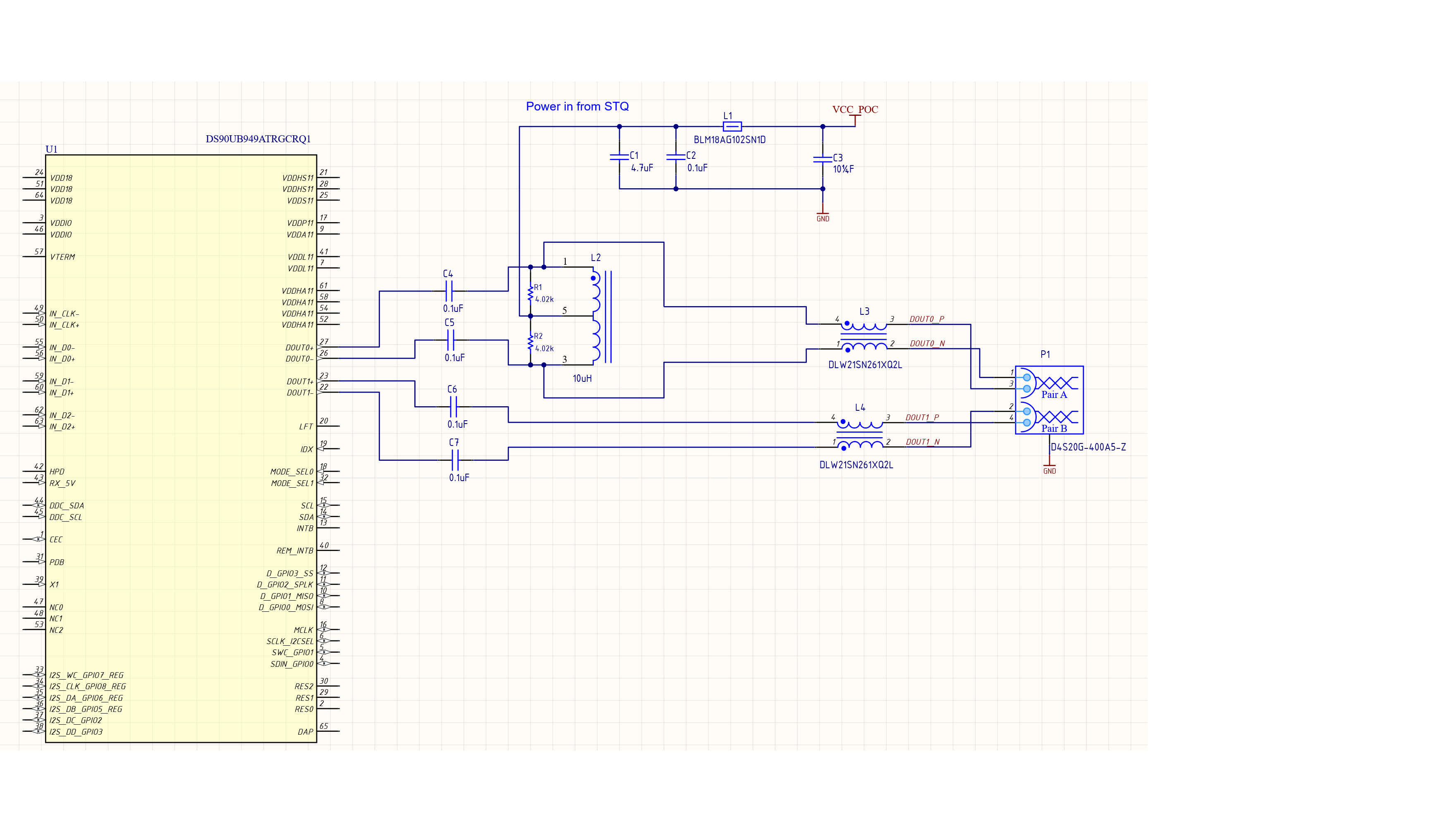

  • Hello Vijay,
    I think you meant something like shown below. Let me know and I close the case.
    Thank you.
  • Sergey
            Yes. This is what I meant. Like I said above please do take into consideration the factors I brought up and as always, if there is a question or issue, let us know
    Vijay
