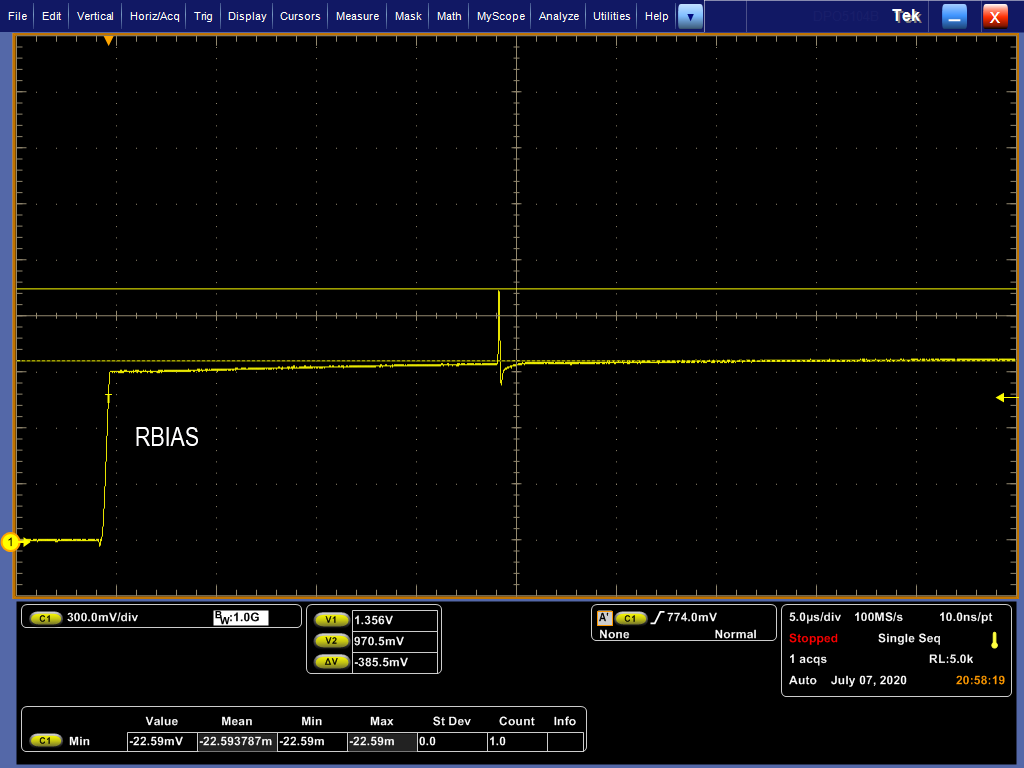

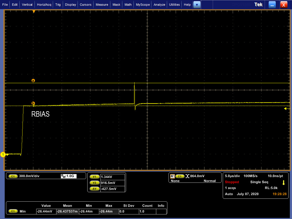

    RBIAS pin: On this pin I have a 4.87 kohm resistor connected, and nothing else. I captured the voltage on the RBIAS pin when the PHY was first being powered on.
    RBIAS Voltage Normally:
    RBIAS Voltage During Observed Issue:
    In both cases, there is an initial voltage spike observed, but it quickly stabilizes to 1V and doesn't change from that value.

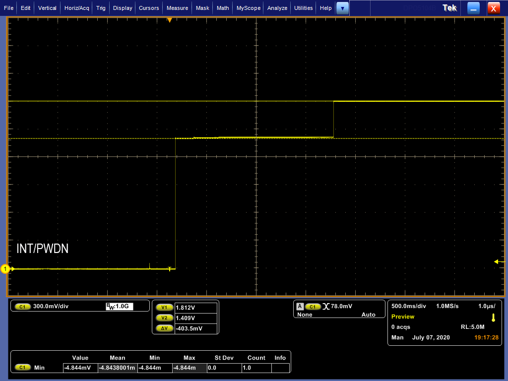

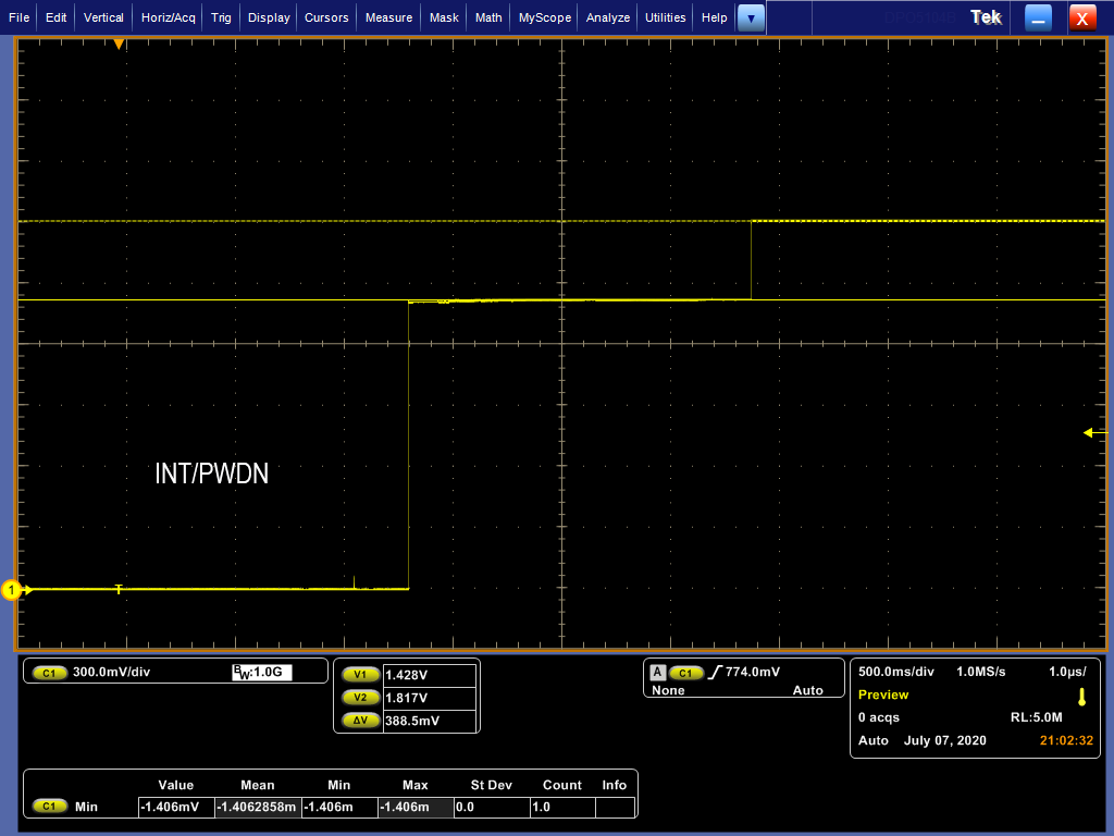

    INT/PWDN_n Pin: On this pin I have a 10 kohm resistor pulling the signal high and a GPIO pin from the board's processor driving this pin (once the processor powers on and is initialized). I captured the voltage on this pin when the PHY was first being powered on.
    INT/PWDN_n Voltage Normally:
    INT/PWDN_n Voltage During Observed Issue:
    In both cases, the voltage sits at 1.4V for a couple seconds before going all the way to 1.8V, but again, I don't see any significant difference between these two measurements.

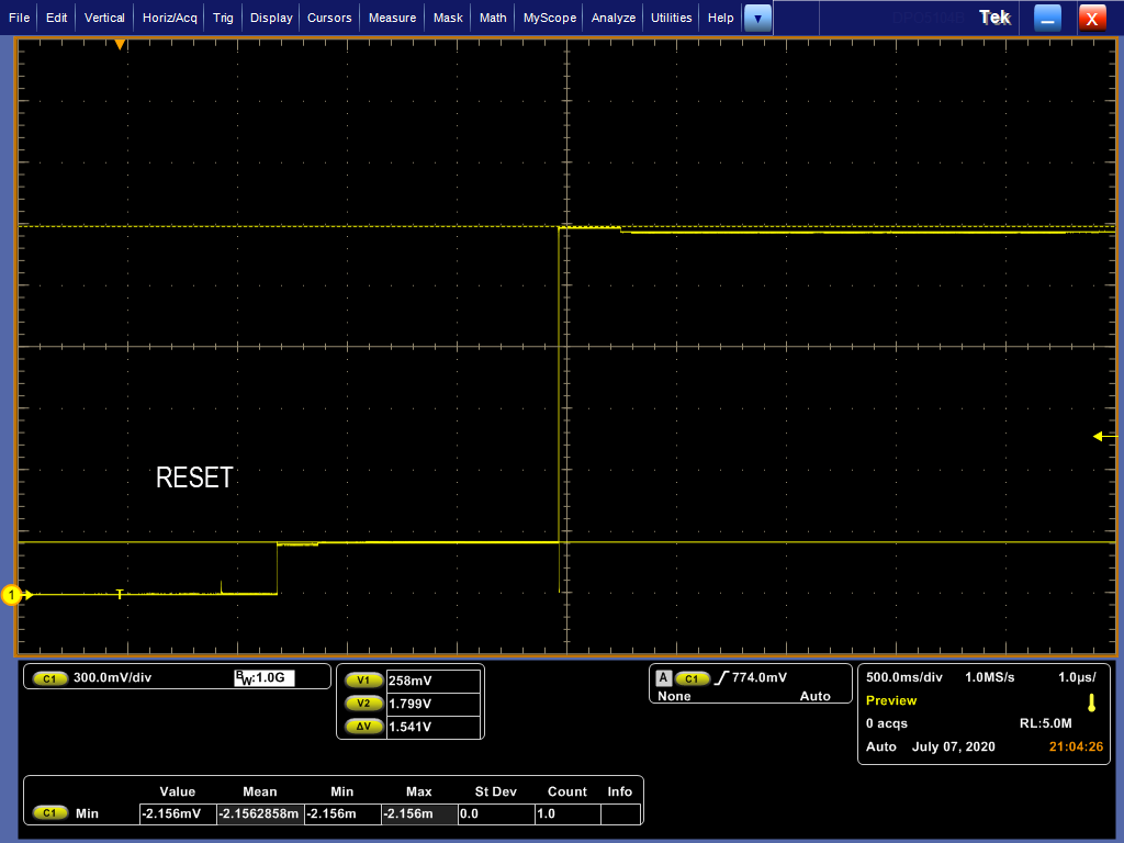

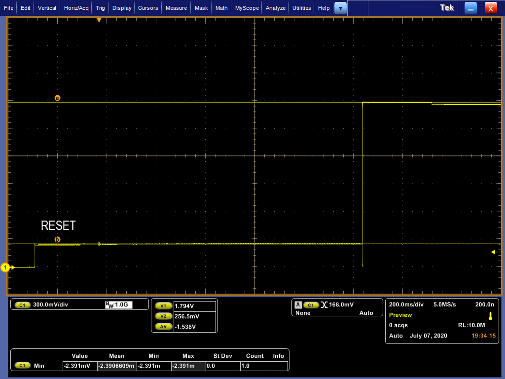

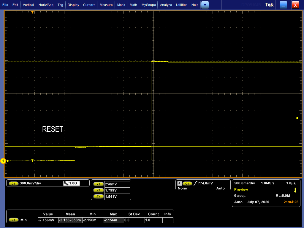

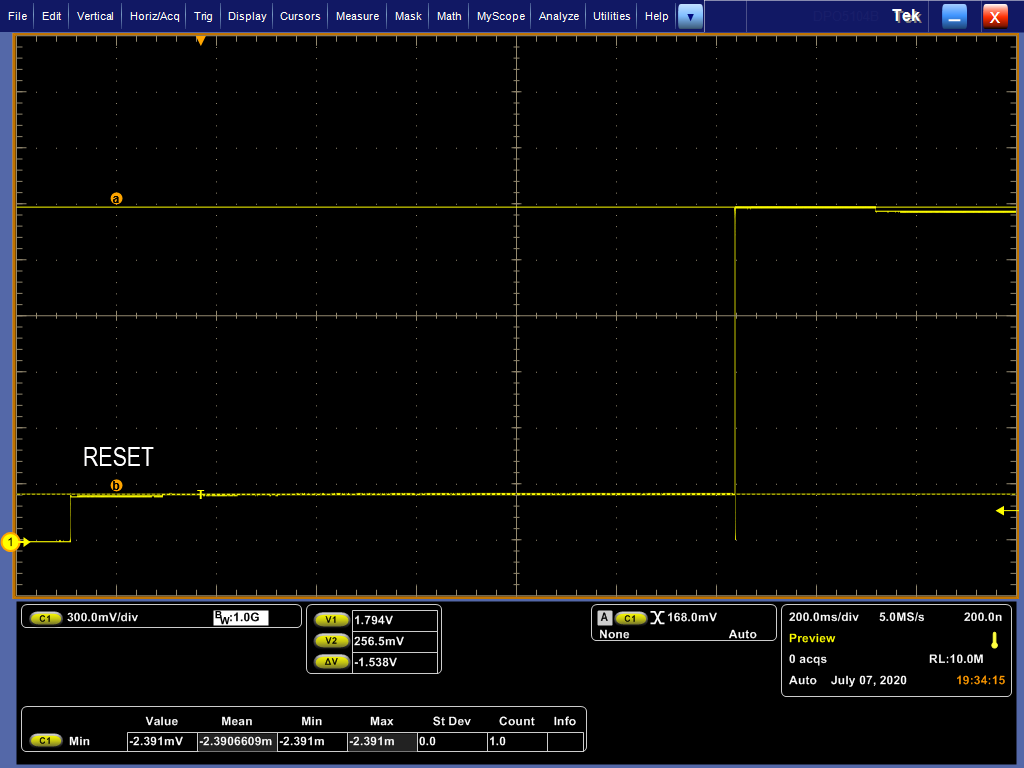

    RESET_n Pin: On this pin I have a 1.96 kohm resistor pulling the signal low and a GPIO pin from the board's processor driving this pin (once the processor powers on and is initialized). I captured the voltage on this pin when the PHY was first being powered on.
    RESET_n Voltage Normally:
    RESET_n Voltage During Observed Issue:
    In both cases, the voltage sits at 0.25V for a couple seconds before going all the way to 1.8V, but again, I don't see any significant difference between these two measurements. Additionally, a few seconds after this occurs, the processor pulls the reset line low for 2ms, and that also looks identical in both situations.

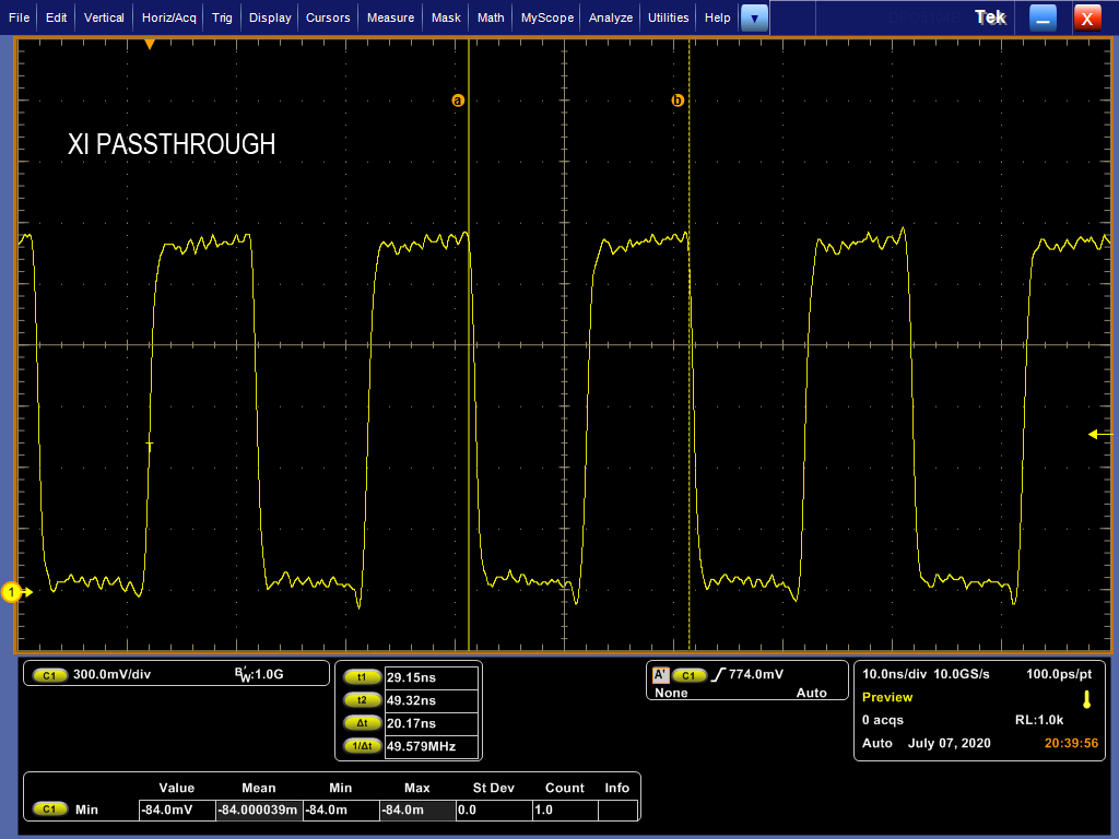

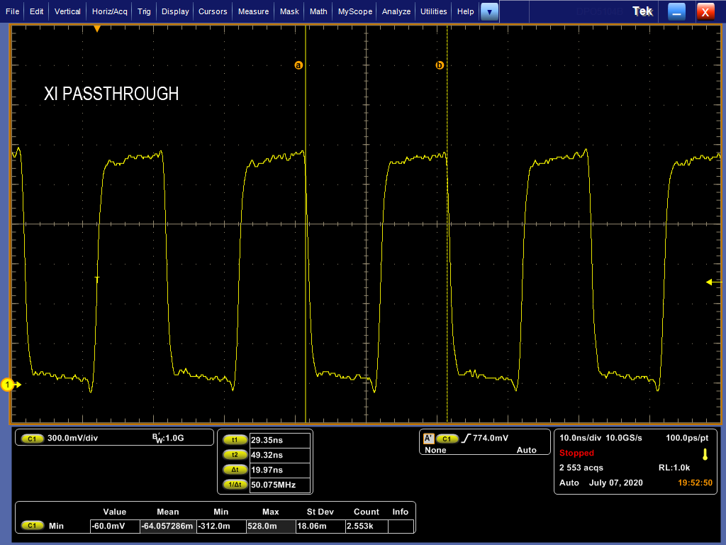

    XI Clock: I brought out the XI clock to GPIO1 and measured it on that pin. Because it does not come out of that pin by default, I was unable to capture the voltage when the PHY was first being powered on, and instead captured the steady-state behavior of the clock in both situations.
    XI Clock Voltage Normally:
    XI Clock Voltage During Observed Issue:
    The clock signal looks the same to me in both situations.

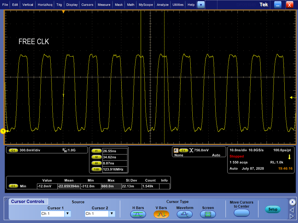

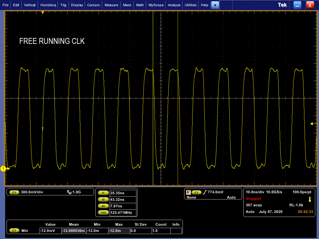

    Free Running Clock: I brought out the free running clock to GPIO1 and measured it on that pin. Because it does not come out of that pin by default, I was unable to capture the voltage when the PHY was first being powered on, and instead captured the steady-state behavior of the clock in both situations.
    Free Running Clock Voltage Normally:
    Free Running Clock Voltage During Observed Issue:
    The clock signal looks to same to me in both situations.
    I will see if I can get an eye diagram of clock signals. In the meantime, please let me know if this helps and if I can capture any other data that might be useful in diagnosing this issue.
    Thanks for sharing the data. This data looks clean.Lets see if we can catch some glitches or bad pulses in eye diagram of 25MHZ clock.
