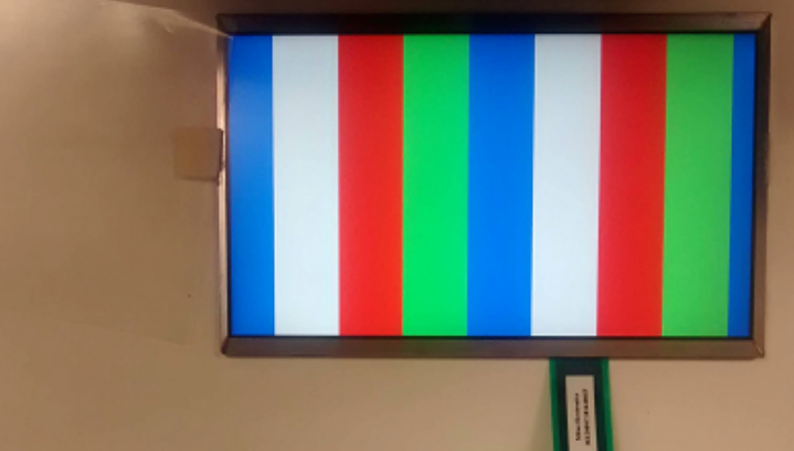

Hello sir,
one of my customers is using SN65DSI84 and met the following issue: part of the panel has color issue to show two different colors in this part. May i ask for the reason?
Thanks for your support!

  • These settings look okay. Can you try enabling the test pattern to see if there's still a color issue? The test pattern can be enabled with the DSI-Tuner by checking the "Test Pattern" box and regenerating the settings.
    The test pattern should look like this:
    I.K.
  • It looks like there's some discoloring with the test pattern too. Can you try changing CHA and CHB to Format 1 with the test pattern and see if this changes the color (please include another picture)?
    I.K.
  • the  register  0x18  value   changed fram  0x6c  to 0x6f  ,but  the color  as well as old.
  • register  0x18  value   changed fram  0x6c  to 0x6f
  • the white color is  normal  changing CHA and CHB to Format 1 with the test pattern.
  • That is interesting. The test pattern looks correct after you changed it to Format 1. According to your panel datasheet though it should be Format 2 like you had originally. The information in the panel datasheet may be incorrect.
    Can you keep it in Format 1 (0x18 = 0x6F) and turn off the test pattern and go back to displaying video from your DSI source? Does the color still look incorrect?
    I.K.
  •     the result  as this picture when keep it in Format 1 (0x18 = 0x6F) and turn off the test pattern and go back to displaying video from your DSI source
  • Okay now it looks worse than before.
    Can you check if there are any error bits in register 0xE5 being set? Clear this register by writing 0xFF to it before reading it.
    Also, are you seeing this issue on multiple units? Do any units show the color correctly?
    I.K.
  • 1. Read back all resisters and confirm they were correctly written    --OK
    2. Write 0xFF to register 0xE5 to clear the error registers, then read register 0xE5,the value is 0x00
