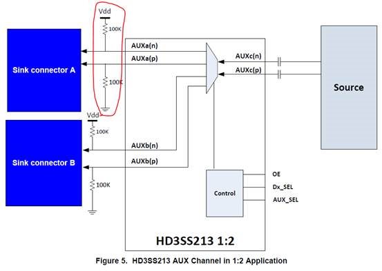

My customer has some questions regarding HD3SS213-TI and would like to consult with TI, thank you! !

4. Why is the in-place detection circuit on AUX placed close to the Sink end? Can it be placed on the Source side?

    4. No, 100k pullup/pulldown has to be on the sink per the DP spec requirement.
