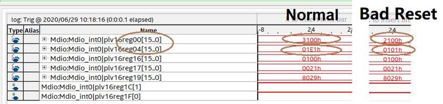

 I am writing to you for  DP83620 Reset Issue.
  • Issue: Sometimes it will be failed when reset the PHY. The PHY Status Register (PHYSTS) is 0x0004 that "Link not established".
  • Debug step by step, and find the difference of registers between device is in normal reset operation and the device after a bad reset.
When a bad reset, the Auto-Negotiation Disabled and ANAR bit [7:5] all show not supported.
Can you help to find root cause according to these difference?
