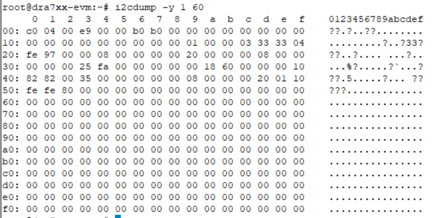

Hi Experts,

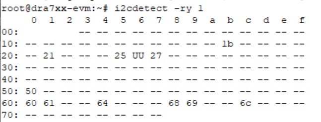

I am trying to connect OV10635 camera to the TDA2x5777EVM board, in the process I am supposed to use SAT0089-SAT0088 components. After connecting the multi-des board to the EVM, I am able to find the following I2C devices:
1)    6 – Deserializers (0x60, 0x61, 0x64, 0x68, 0x69, 0x6c)
2)    3 – GPIO expander chip (0x27, 0x21, 0x25)
3)    1 more device (0x50)
I2C Devices
After setting the pass through all bit (0x21 to 0x97) and Serializer Alias (0x07 to 0xb0), the Deserializer register reads as below
DES Register Values
After doing these setting, I am not able to see the Serializer 913 in the I2C bus.

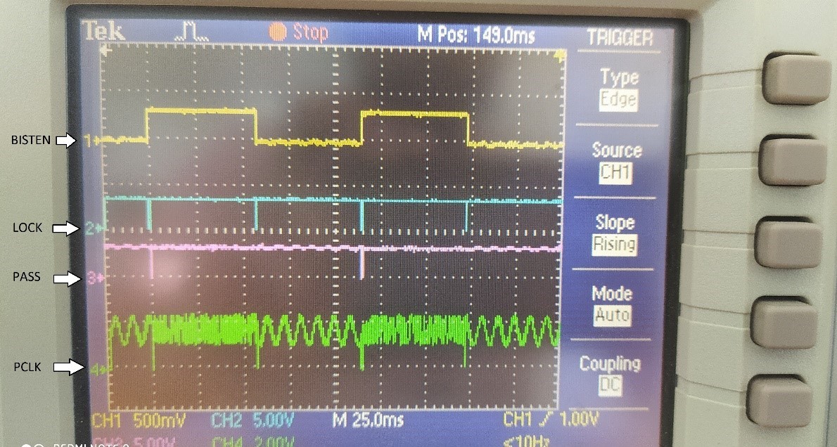

With the help of I2C expander, I also conducted the BIST to check the Serializer communication. Expander setting are as follows:
#i2cset -y 1 0x27 0x00 0x0f
#i2cset -y 1 0x27 0x12 0xf0         -> enable bist
#i2cset -y 1 0x27 0x12 0xe0         -> disable bist
Below are the BIST results.
BIST
BIST results are pass, but I couldn't see serializer.

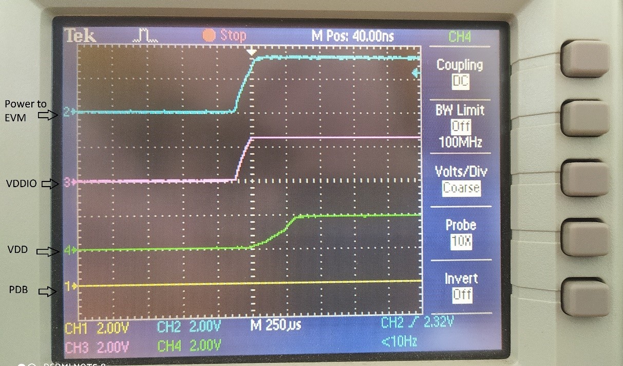

Captured the power-up sequence of the deserializer to check the characteristics, and I found those are as per datasheet
Power Up Sequence
Please help me to establish a communication with the Serializer and in turn to the camera.

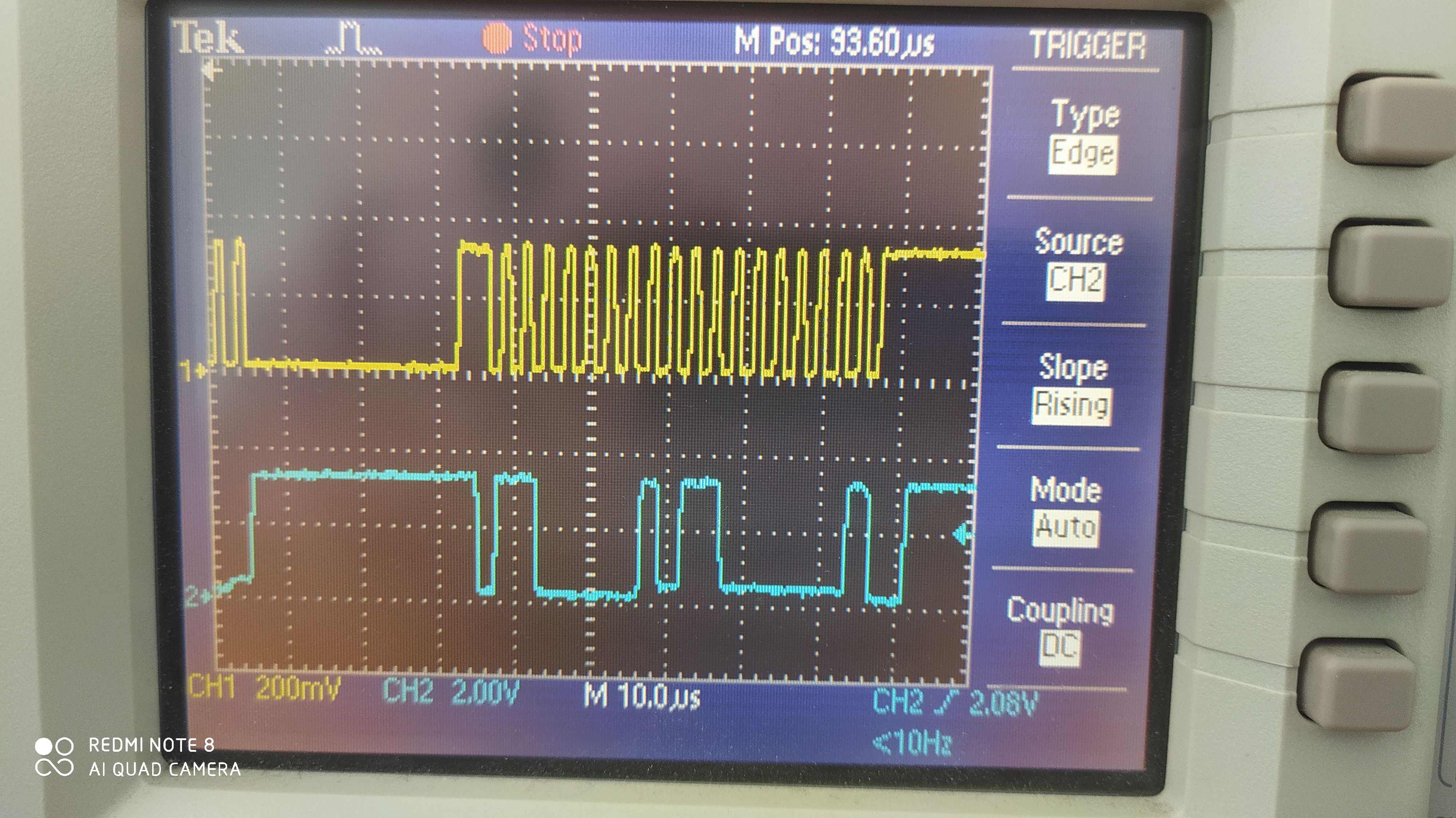

    There is a forward channel communication from SER -> DES, so the SER ID register(0x06) in 914 is updated with 0xb0 value. After setting the alias address in the register 0x07 with 0xb0, if I try to read the value from the 913 SER (7 bit address) using below utility
    I get this error "i2cget: read failed: Remote I/O error".
    While measuring the I2C signals during the Serializer read, I am not getting the acknowledgement signal from serializer.
    Below is the I2C signal for Serializer read: (No Acknowledgement)
    SER I2C Read
    Below is the I2C signal for Deserializer read: (Acknowledgement is coming, image 2 shows read value from 914 DES register)

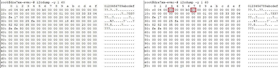

    On the 914, try enabling the Auto Ack bit (bit 2) and the I2C pass through bit (bit 3) of the General Configuration 1 register (0x03). Also, try setting the serial alias to a 7-bit value between 0x09 and 0x17. Then try to access the serializer.
    Once you have configured this, please send another register dump for the 914.
    Carrie
  • Hi Carrie,
    I2C pass through bit of General Config register 1 (0x03) is set by default, I have set the Auto Ack bit of GC1 register (0x03).
    Also I have set the Slave ID registers and Slave Alias registers along with SER ID registers and SER alias registers.
    DES_Reg_Values
    But still I couldn't access the Serializer.

  • Good afternoon,
    Try disabling “I2C Pass-Through All” bit (0x21[7]) on the 914A and then use 7-bit addressing to access 913A registers.
    Carrie
  • Hi Carrie,
    I have disabled "I2C Pass though all"bit and tried with SER alias 7-bit address as 0x58 and 0x59. Still I couldn't access 913A registers. PFB the register values of 914
    DES Register Values
    With Regards,
    Subramaniyan
  • Hello Subramaniyan,
    Read the default loaded alias from register 0x07. Instead of setting it to 0xB0, try using this value to access the serializer.
    Carrie
  • Hi Carrie,
    The default value of the serializer alias register(0x07) is 0x00, with serializer 913A connected to deserializer 914A. Hereby I attach the text file with default values of all registers read from 914A. I was setting the value of 0xb0 and 0xb2 after going through the I2C over DS90UB913/4 FPD-Link III with Bidirectional Control Channel (snla222) application report.
    Note:
    In datasheet also against the 0x07 register, it is mentioned that value of 0x00 would disable the communication to the remote serializer.
    Subramaniyan

    Please send the serial address and serial alias read from each deserializer after device configuration.
    Carrie
  • Hi Carrie,
    As at present we are concentrating on the Serializer, I haven't set the slave address registers and slave alias registers. I have set only the General Config 1 register (0x03) for acknowledgement, and  Serializer Alias register (0x07).
    SAT0089 board has 6 FPD ports, I have connected 4 Serializers against the DES 0x60, 0x64, 0x68 and 0x6c. DES 0x61 and 0x69 are not connected to SER. Below images show the register values, default against modified. Modified Values are boxed in red color.
    914A - 0x60:
    DES_1_0x60
    914A - 0x64:
    DES_2_0x64
    914A - 0x68:
    DES_2_0x68
    914A - 0x6c:
    DES_2_0x6c
    Please let me know, if I have to furnish some more details.

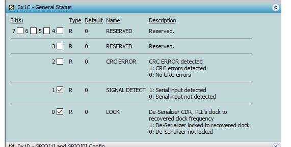

    Based on the register dumps of the deserializers it looks like the serializers are properly locked and communication should be available through the link. If you are still not able to access the serializer then the issue may be related to the SW stack of TDA. Have you contacted Spectrum Digital regarding this issue? Because they may have more familiarity with this system and SW to bring the board up
    Casey
  • Hi Casey,
    Still I couldn't see the serializer in I2C bus. I am able to see the deserializer in the I2C bus but not the serializer, kindly enlight me how the SW stack may affect only the serializer.
    If register dumps of 914A are okay, can you please share some I2C command that should allow me to communicate to the SER 913A and modify SER registers.

  • Subramaniyan,
    The register dumps that you provide indicate that the SER/DES are properly locked and the I2C aliasing configuration is correct. So it seems that the only remaining issue would be related to the processor SW, otherwise from the SERDES perspective we don't see any reason why the SER should not be accessible. Do you have access to a USB2ANY or Aardvark module that can be connected directly to the I2C bus to bypass the system SW and run isolated testing of just the FPD-Link devices?
    Casey

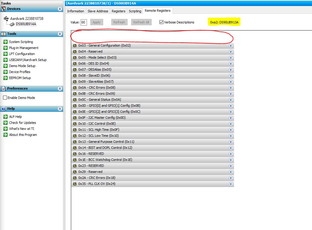

  • Hi Casey/Carrie,

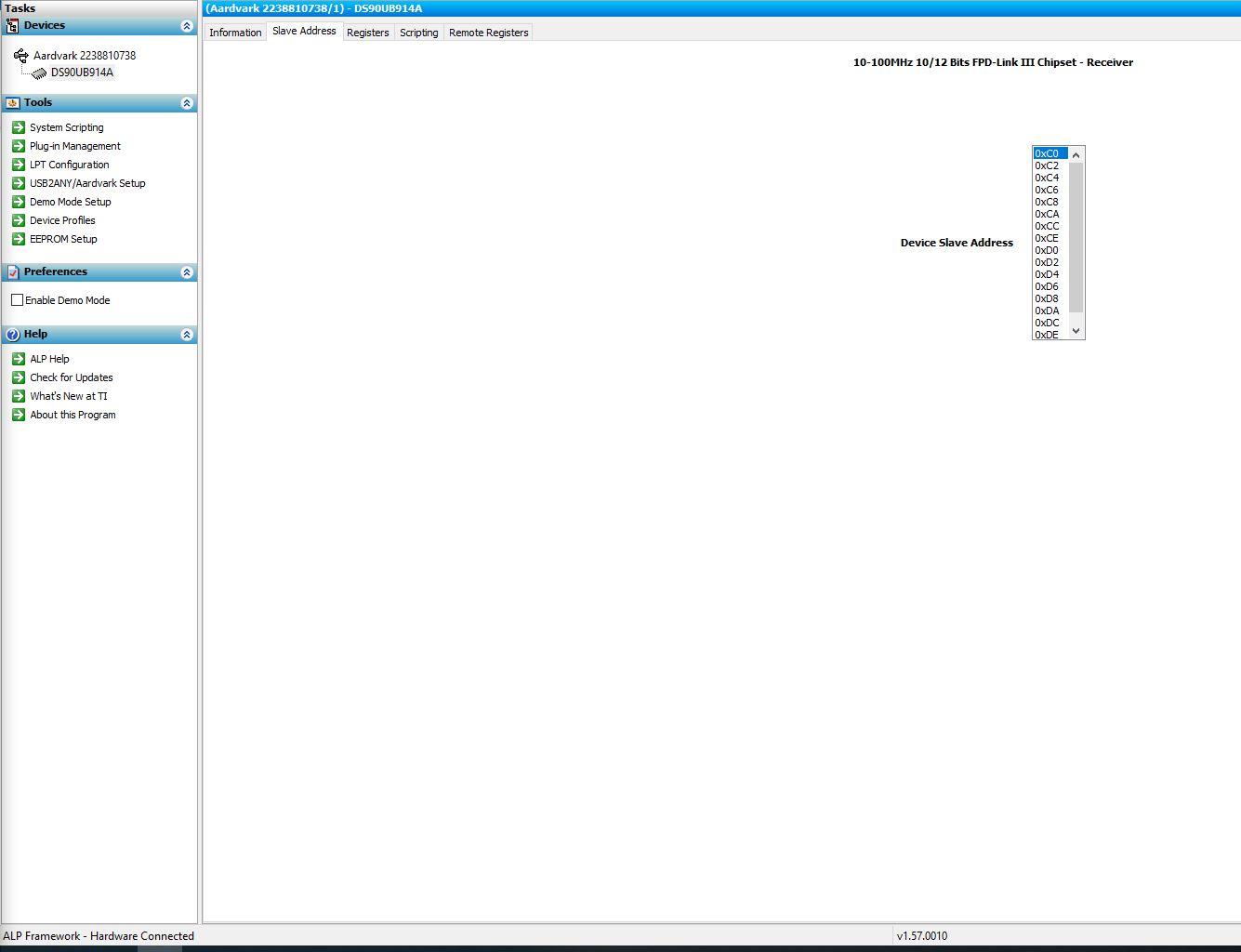

    I have tried with ALP, still I couldn't read or write 913A registers. Kindly see the below steps which I have followed and let me know anything am missing with:
    1) Connected the hardware with Aardvark adapter then to the Win 10 machine through USB. I have validated status bar and it read "ALP Framework - Hardware Connected"
    2) Selected "DS90UB914A" from the defined ALP Devices under the Aardvark setup
    3) Then selected the first deserializer (0xC0) from the slave address list
    Slave Address List
    Some observations in the ALP tool:
    1) "Information" tab is empty and doesn't have any detail on it
    2)  In the "Registers" tab, I am able to see and modify the register values. Have modified the SER Alias Register to 0xA2 value. Register dump is as follows:
    Register Display - ALP Nano 1 - DS90UB914A, Connector 1
    Register Data Name
    0x0000 0xC0 I2C Device ID
    0x0001 0x04 Reset
    0x0002 0x00 General Configuration 0
    0x0003 0xE9 General Configuration 1
    0x0004 0x00 EQ Feature Control 1
    0x0005 0x00 EQ Feature Control 2
    0x0006 0xB0 SER ID
    0x0007 0xA2 SERAlias
    0x0008 0x00 SlaveID[0]
    0x0009 0x00 SlaveID[1]
    0x000A 0x00 SlaveID[2]
    0x000B 0x00 SlaveID[3]
    0x000C 0x00 SlaveID[4]
    0x000D 0x00 SlaveID[5]
    0x000E 0x00 SlaveID[6]
    0x000F 0x00 SlaveID[7]
    0x0010 0x00 SlaveAlias[0]
    0x0011 0x00 SlaveAlias[1]
    0x0012 0x00 SlaveAlias[2]
    0x0013 0x00 SlaveAlias[3]
    0x0014 0x00 SlaveAlias[4]
    0x0015 0x00 SlaveAlias[5]
    0x0016 0x00 SlaveAlias[6]
    0x0017 0x00 SlaveAlias[7]
    0x0018 0x00 CRC Errors THRESHOLD
    0x0019 0x01 CRC Errors THRESHOLD
    0x001A 0x00 CRC Errors
    0x001B 0x00 CRC Errors
    0x001C 0x03 General Status
    0x001D 0x33 GPIO[1] and GPIO[0] Config
    0x001E 0x33 GPIO[3] and GPIO[2] Config
    0x001F 0x04 Mode and OSS Select
    0x0020 0xFE BCC Watchdog Control
    0x0021 0x17 I2C Control 1
    0x0022 0x00 I2C Control 2
    0x0023 0x00 General Purpose Control
    0x0024 0x08 BIST Control
    0x0025 0x00 BIST ERROR COUNT
    0x003C 0x00 OSC OUT DIVIDER SEL
    0x003F 0x10 CML OUTPUT ENABLE
    0x0040 0x82 SCL High Time
    0x0041 0x82 SCL Low Time
    0x0042 0x00 CRC Force Error
    0x004C 0x00 SEL Register
    0x004D 0x20 AEQ Test Mode Select
    0x004E 0x07 EQ Value
    General Status Register 0x1C, shows the detect and lock condition of SER to DES
    SER Lock Condition
    3) In "Remote Registers" tab, I can see the Alias address and the SER name at the opening pane. But I couldn't see any of the SER register values. On trying to read the register using arrow button, the name vanishes as shown in the below image
    SER Remote Registers
    Kindly help me to solve the issue and connect to the SER and Slave.
