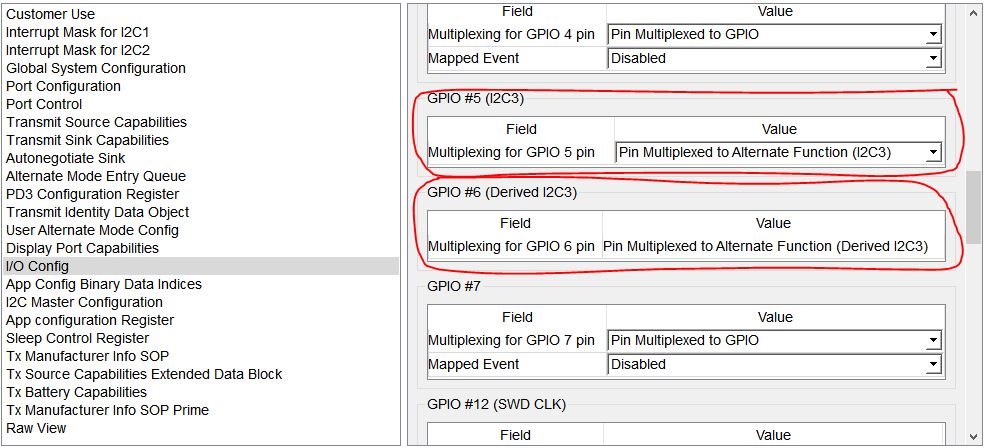

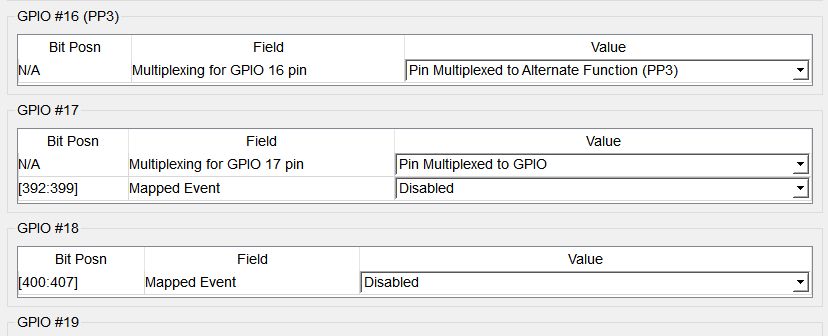

In Application Customization Tool , i have set I2C3 as master in reg 0x27 then in I/O config register 0x5C I set GPIO 5 and 6 as I2C3 and GPIO 18 as "Output Enabled without Even" with a pull up. As suggested by https://e2e.ti.com/support/interface/f/138/t/921863 .

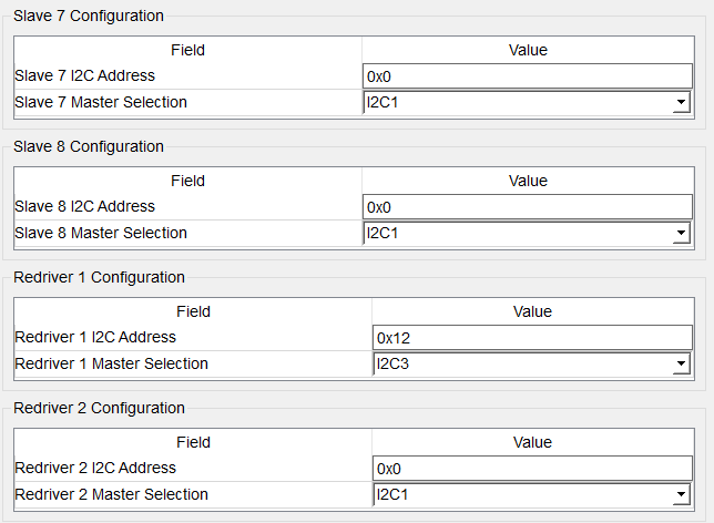

The next thing I have to do is set up 0x64 register and i can choose up to 8 slaves and 2 redriver configurations. As im using the I2C3 to set up a redriver ,so I want to use one of these .

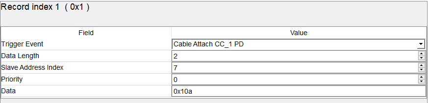

For example redriver 1 configuration. But when i go to I2C Master Events table to fill out record index i can't choose the redriver config. In the slave address index i can choose from -2 to 7. What should i choose to select the redriver 1 configuration ?
