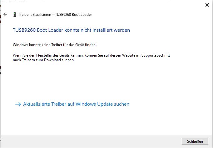

Hi Iliya,
Did you install the Flashburner with admin privileges? If not, I would uninstall the flash burner and reinstall with admin privileges. You could also try running the Driver_Inst application in you installation location similar to the following: C:\Program Files (x86)\Texas Instruments Inc\TUSB926x_Burner.
Hi Malik,

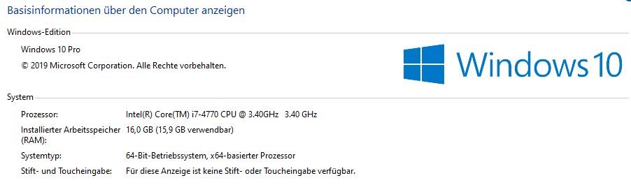

I have tested with Admin privileges with it have dont work.
I have test paralel on oder PC with Win 10 and the burner works without problem.

Hi Iliya,
Glad you were able to flash your EEPROM. You should not run into issue if TUSB8042 is behind a USB Hub, it should still work. Do you need flash burner for linux?
