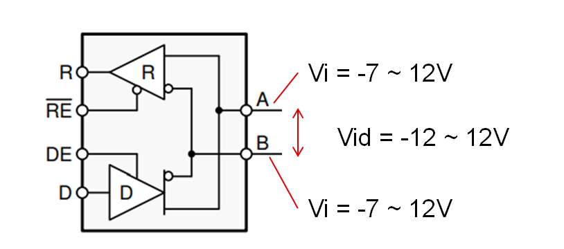

HI,
Could you please let me know the relation between VI and VID?
Is blow block correct?
Nagata.

Nagata-san,
Your figure is correct.
VI is an input voltage at a pin with respect to ground. When it appears in the Recommended Operating Conditions table it is referring to "bus pins" (e.g., A and B). This would be equivalent to the "VA" and "VB" parameters that appear elsewhere in the datasheet.
VID is the differential input voltage, meaning the voltage at A with respect to B.
