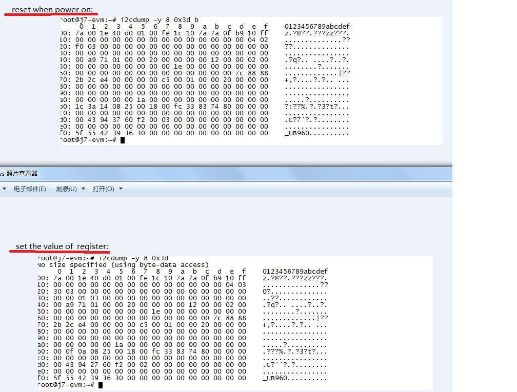

I  want to  configure CSI Port 0 to generate a test pattern,but  it  cannot work  well,I see the py script

  • I  do it in  the tda4evm  board,the register like this :

    I checkout the value of the register "0x35" is still 0,so  I think it does not work well.
    what's wrong with me?
  • Hello Zhangsc,
    We will look into these register settings and plan to follow up on Monday
    Casey
  • Hello Zhangsc,
    Register 0x35 only indicates valid data on the TX port if there is incoming serializer data. It does not get set during successful pattern generation.
    Register 0x02 should be set to 0x3E, which will enable output without active receiver lock.
    The value in register 0x04 indicates that there isn’t a valid refclk provided to the REFCLK pin (pin 5). A 25 MHz LVCMOS-level oscillator (100 ppm) is recommended. The refclk has to be detected before CSI-2 output can be produced.
    Set register 0x20 to 0xF0 instead of 0x30 to disable all RX ports.
    Make sure that you’re selecting a TX port using register 0x32 (CSI_PORT_SEL) before enabling or configuring that port.
    Can you please send me the pattern parameters (frame rate, data type, resolution, etc) so I can verify register configuration for your pattern generation?
    Carrie

  • Hello Zhangsc,
    Based on these settings (data type RGB888) your pattern generator registers look fine. Just change the line period to 0x0B92 (2,962). If your CSI-2 TX data rate is 800 Mbps, set CSI_PLL_CTL[1:0] to 0b10 and reset the CSI-2 timing parameters. The default values for these parameters are compliant with MIPI standards for 800 and 1600 Mbps.
    To verify successful pattern generation, a CSI-2 analyzer can be connected to the deserializer.
    Carrie
  • The value in register 0x04  is 0xD0, My refclk is right?
    BIT 4 is 1
    1 : REFCLK frequency between 12 MHz and 64 MHz
  • Hello Zhangsc,
    For 960 the REFCLK should be between 23-26MHz. You can check the measured frequency in register 0xA5. Can you verify that it meets those frequency requirements?
    Casey
