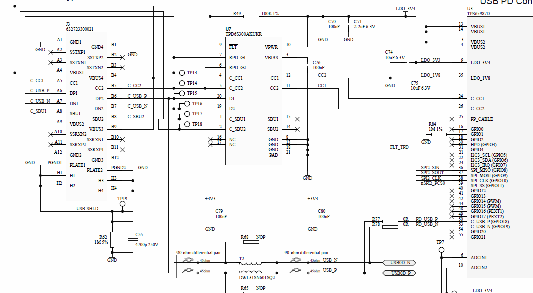

With my design that uses the TPS65987D (device) I am using it to source power to a host using a USB-C cable. In addition the design sinks audio from an attached host device.
So far the design is able to provide power as well as receive audio from hosts that have a USB-C port, e.g. an Android phone that has a USB-C port. It is also able to only receive audio from a laptop which has a USB-C port. The design only sources 5V up to 2A so it is not able to charge the laptop.
Part of the requirements of the design is to provide power to an iOS device (e.g. iPhone) using a USB-C to Lightning cable. Additionally the design needs to receive audio from the attached iOS device. So far the design is able to source power to the iOS device via the USB-C to Lightning cable but not receive audio.
To summarise, from a power point of view our design is DRP and prefers power source. For data we want to be a device (UFP). Also we're not using the SSRX, SSTX pins but just the DP, DN pins.
The design has the following configuration.
  • Using an external SPI flash to store the patch bundle config
  • SPI_MISO is 1, and ADCIN1 is 0.24
Following is the relevant portion of the schematic from our design:
I've also attached the project file exported from the Application Customization Tool.
So my question is, is there anything that we may be doing wrong? Are there any errors in the configuration for the TPS65987D? Any tips, suggestions on how to proceed would be greatly appreciated.

    "It is also able to only receive audio from a laptop which has a USB-C port. The design only sources 5V up to 2A so it is not able to charge the laptop."
    >>> Please share PD trace for further debug.
    "Part of the requirements of the design is to provide power to an iOS device (e.g. iPhone) using a USB-C to Lightning cable. Additionally the design needs to receive audio from the attached iOS device. So far the design is able to source power to the iOS device via the USB-C to Lightning cable but not receive audio."
    >>> I'm not sure whether iPhone can act as USB host while its getting charged. Does Audio work if you configure TPS65987D as Sink only device?
    Please note that TPS65987D  do not control DP/DM.
    Prajith.

    I tried configuring the TPS65987D as a UFP only device but unfortunately the iOS device is not sending audio over the lightning port.
    I did a bit more digging and it seems like the iOS device is not enumerating with our device. When I tried a laptop with a USBC port our device (with the TPS65987D and same UFP only config) enumerates  with the laptop. So it seems something is not quite correct with either the iOS device or the USBC to Lightning cable.

  • Hi Prajith,
    We were able to get some information from Apple and they mentioned that when the USBC to Lightning cable is plugged in, the cable turns the iOS device into a UFP. So this finding is consistent with what you said before that the iOS device cannot charge and provide audio at the same time with the USBC to Lightning cable.
    Thank you so much for your support. With these issues resolved our design is complete and working well.
