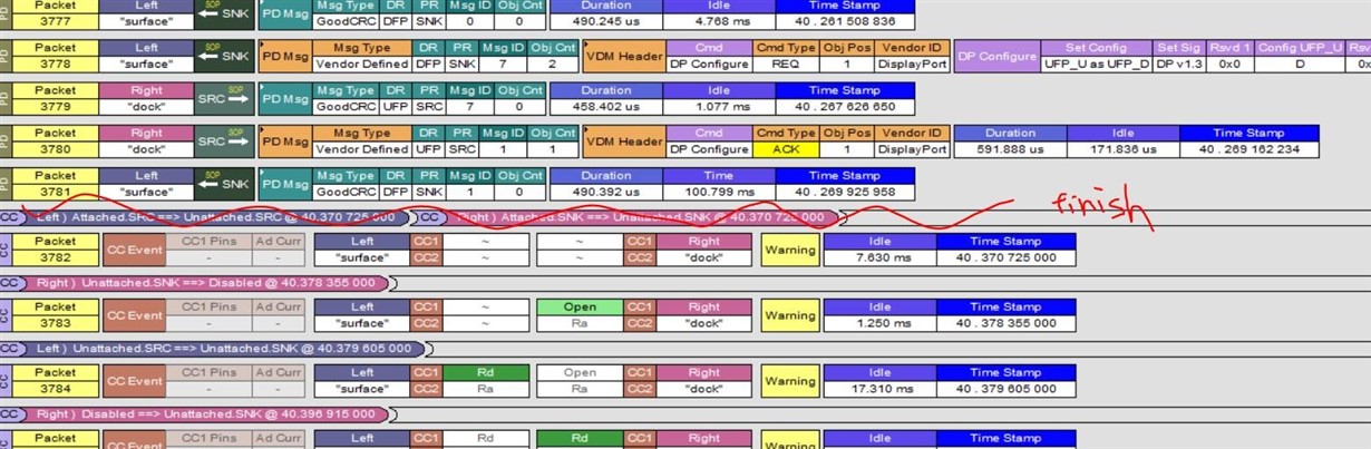

  • Hi Peter,
     Your new setting let the dock be power sink always without PR swap. Please check the log as attached. Thanks.
    GaryNo PD Charing log_20200817.zip

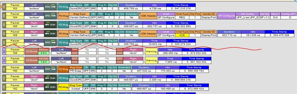

  • Hi Gary,
    I have updated the project file to initiate as source and verify it on my setup.
    I can see the PR_SWAP and enter into DP mode.
    Please try this.
    Peter

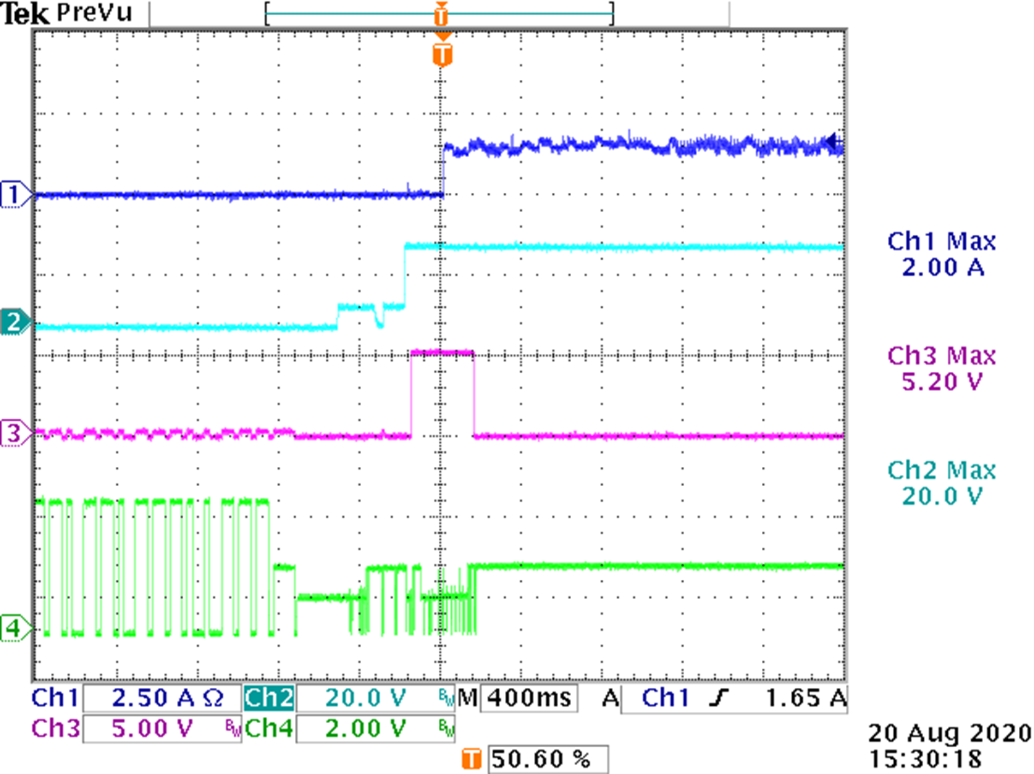

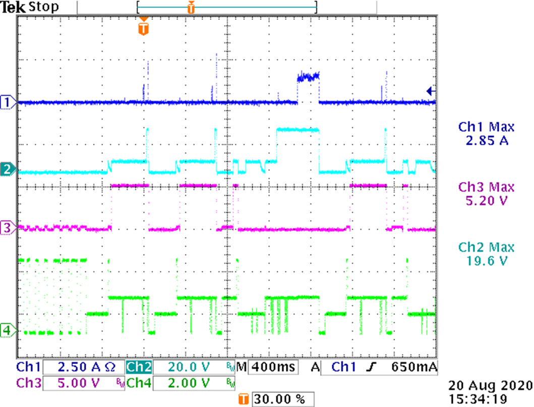

     We test the customer board and Surface go 2 again and we think maybe our PD disconnect connection due to protection...
    1. Surface go 2 can be charge in high battery power (>85%)
    2. If we short Rsense in PPEXT path, we can charge surface at any time.
    3. All type-c docks using TI solution in customer have issue to charge surface go 2, but thunderbolt dock works ok.
     We can't see abnormal in waveform about I/V/CC in our test. Would you please helping to check any problem in connection and we can try to cover it from FW setting? Thanks for your kindly help.
    Failed connection in current dock.
    Good connection with TI TBT dock
    Snapshot file
    20v.zip
    Gary
  • Hi Gary,
    So this is a separate issue from your previous thread, correct?
    From the scope captures, it shows a current limit condition occurs and when you short Rsense it's basically not sensing the current limit and allows you to charge.
    From the debug register file, it shows the PD is using PP_EXT 20V 3A PDO to source the max 2.25A RDO, so why it hits current limit is something to debug further. When the VBUS current is below 2A VBUS stays at 20V, but there's also time it doesn't like the last cycle. What signal is channel 3?
    Can you send the project file and PD log?
    Peter

  • Hi Gary,
    I talked to Jeffery and confirmed the FW is setting the OCP based on RDO operating current, so you need to set the Surface sink operating current to what it needs e.g. 2.25A instead of 0.75A.
    Peter
