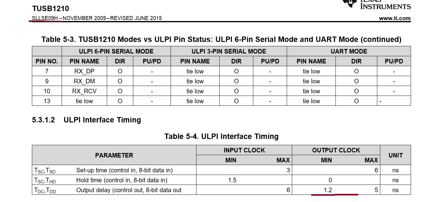

Hi expert,
From following E2E session,
"TI comment"

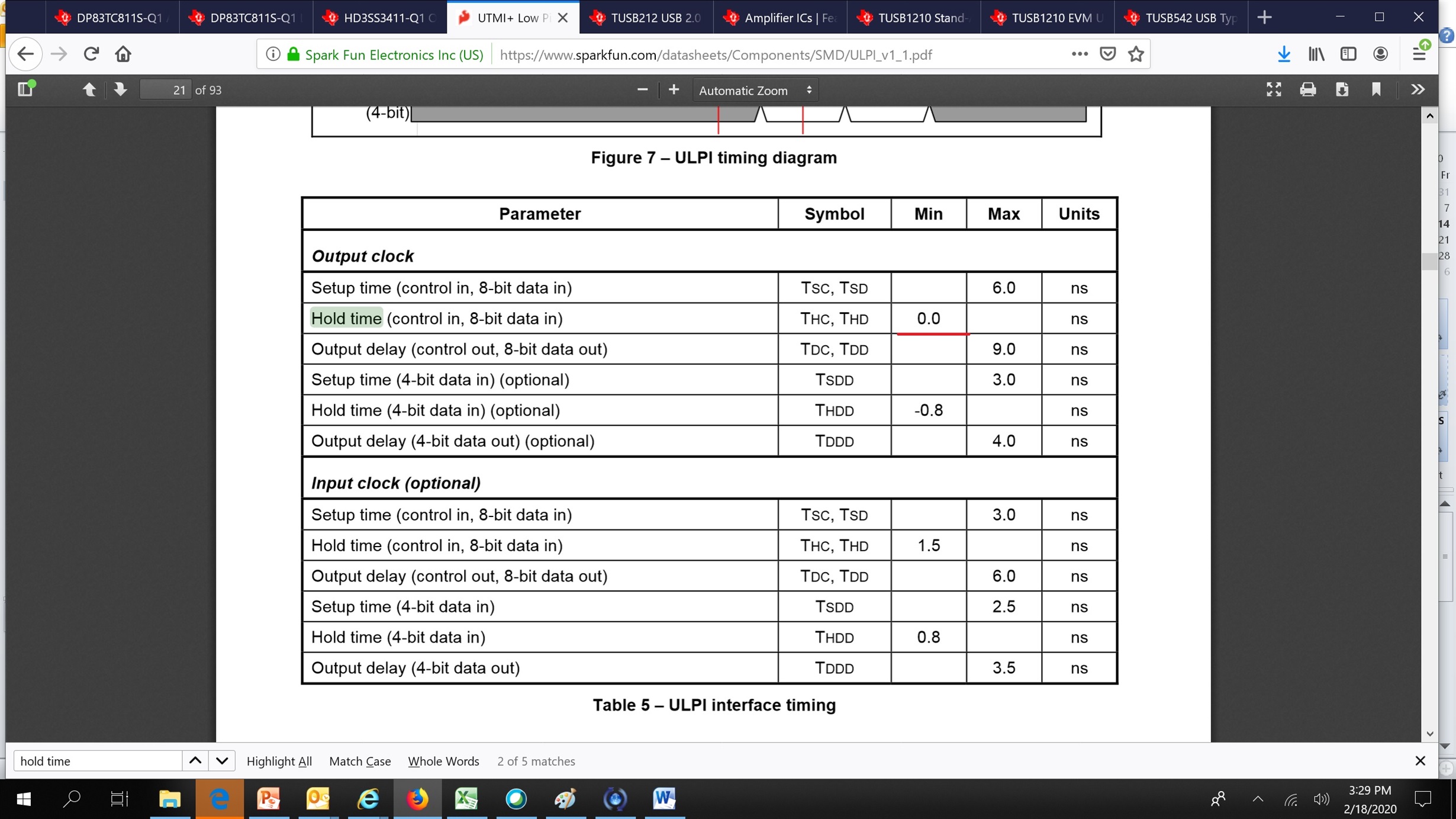

yes, you are right referring to the missing specs on the table 6.6, but on the features summary of the device (page 6 of the datasheet) you can notice that the TUSB1210 is fully complaint with the "UTMI+ Low Pin Interface (ULPI) Specification Rev. 1.1", therefore you shouldn't be worried about it.

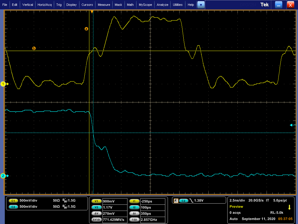

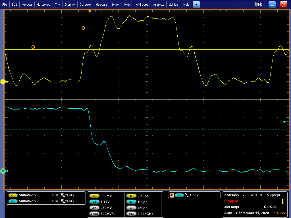

However, TDC, TDD Min = 100ps Max < 9ns
Output clock mode minimum spec is over 1ns(ULPI)
Is it meaning, TUSB1210 cannot meet ULPI specification?
Muk
