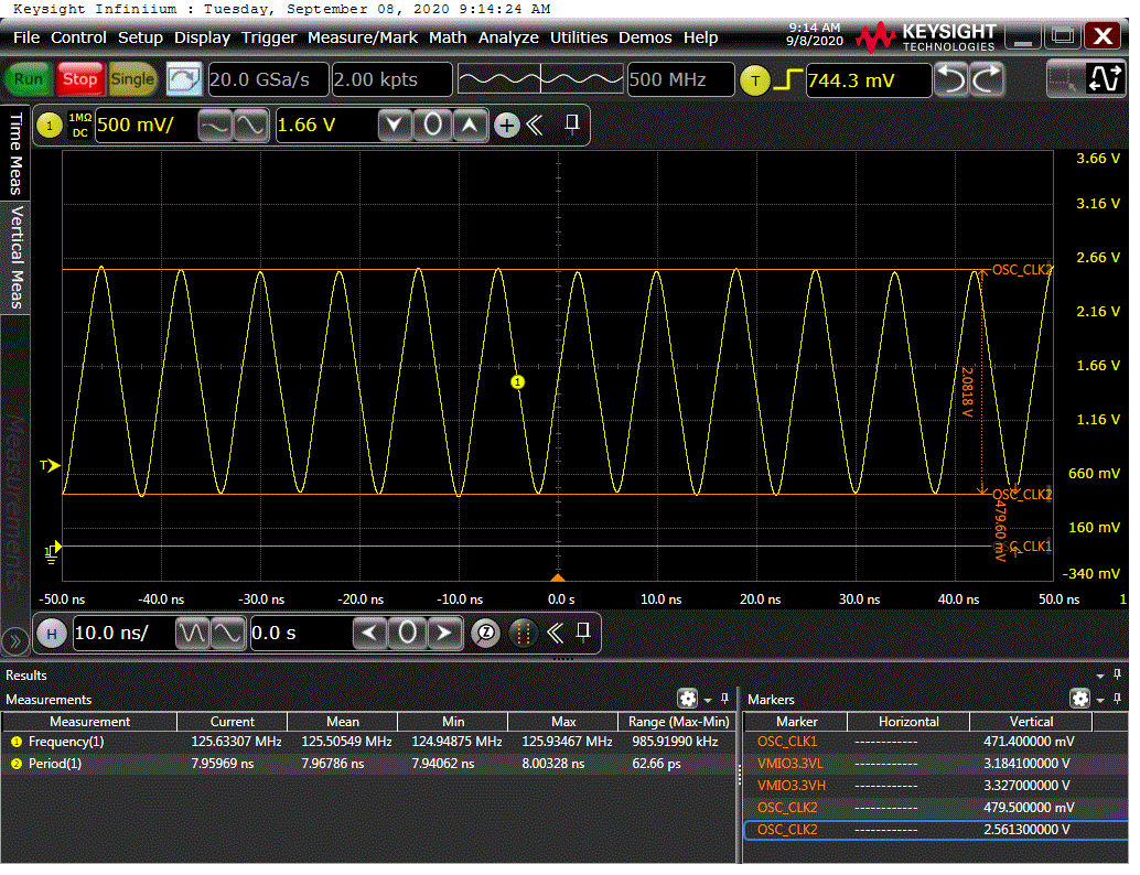

    The XI oscillator signal is in following screen shot:
    By the way, the probe is passive with 1Mohm impedance.
    Jimmy
  • Hi Jimmy,
    Ok I am still unsure if this signal is still passable or not as we typically see square waves on rxclk
    Can you share with me the details of the failure you are seeing?

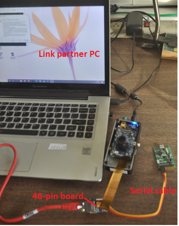

  • Hi Cecilia,
    We use Keysight MSOS404A oscilloscope to measure the RX_CLK. and we could not observe the square waveform of RX_CLK signal although the scope has 4GHz bandwidth, and 20GS/S. Do you mind to let me know what kind of scope you use to observe the square waveform of RX_CLK?
    We use PC ethernet port as a link partner to test our new designed GigE board. We have two similar designs, one uses TI DP83867IRPAP (64pin) device, the other uses DP83867IRRGZ (48pin) device. Under same test condition, the 64-pin one is successful to communicate with PC, while the 48-pin one fails to communicate with PC.
    Then we use  MSOS404A scope to do the trouble shooting and found out the 64pin device RX_CLK signal is within the spec (VoL = 0.479V), as shown in following scope screen shot:
    While the 48-pin device RX_CLK clock is out of the spec (VoL = 0.735V), as shown in following scope screen shot:
    We don't know what attribute to this RX_CLK signal out of spec since this signal is directly output from PHY to MAC. We made a comparison test between our two designs using the scope for other signals, including +3.3V, +2.5V, +1.1V (64pin)/+1.0V(48pin) and their power ramp sequence, 25MHz oscillator in and out of the device and CTX_CLK signal from MAC to PHY. And we did not observe difference among those signals.
    Could you shed a light for us with regards to this 48pin device RX_CLK signal? Why its VoL out of spec (Spec value VoL =0.6V MAX)?
    Jimmy

    There is something abnormal on our 48 pin device board. We use TI Launch PAD tool and USB-2-MDIO GUI and tried to read PHY register value, but failed at the first step. We could not even find available PHY ID on the 48pin device board while scanning it using USB-2-MDIO GUI. We guess it is relating to RX_CLK signal which is out of the spec.
    We made same operation on 64-pin device board, everything is OK, and PHY ID and register Read/Write are all successful.
    By the way, the resistor strap configuration on both board are the same. On 48pin device board, pin 33 (RX_D0) is pulled to GND through a 1K resistor, and pin 35 (RX_D2) is tied to VDDIO_3.3V via a 1K resistor. On the 64-pin device board, pin 44(RX_D0) is pulled to GND through a 1K resistor, and pin 46 (RX_D2) is tied to VDDIO_3.3V via a 1K resistor. The 64-pin PHY ID is 12 (0x0C) which is matched with the resistor strap configuration.
    We could not provide you with the 48-pin PHY register value. But we can send you the 64-pin device PHY register value if you want to take a look of it.
    Jimmy

  • Hi Jimmy,
    In slide 4 you mention that you are measuring oscilaltor out signal on OSC1 pin 3. What pin is this on the PHY? Is this the CLKOUT pin, pin18 on the PHY? I would like to also review the CLKOUT pins of both the 64 pin package ad the 48 pin package as I do not see that in the scope shots.
    Also on slide 7 Is there a reason why the VMIO3.3V does not pull up to the 3.3V directly like the 64 pin package? Is there a difference in how its powered?

    It is marked wrong in slide. The signal is the PHY clock output on pin 18 of 48-pin design. I rescope it on 48-pin design board now, as below
    In our original 48-pin design, there is no reset chip in reset circuitry. A reset chip is added to 48-pin board later, which address the powerup reset delay and more aligned with 64-pin design. Please see the attached file which shows the difference before and after the reset chip is added.
    VMIO3.3V.docxPlease let me know if you have further question about those scope traces.
    Jimmy

  • Hi Cecilia,
    We do use different RJ45 connectors for 64-pin and 48-pin designs. The main reason of having 48-pin design is to have small ethernet communication board such that it can be placed into our small camera box. With regards to pin2 (VCC) of RJ45, it is no longer connected to VMIO+3.3V, the zero ohm resistor is removed. Regarding strong pull down resistor (1K ) on GPIO pins, we just want to make sure the strap voltage at 0V (MODE1).
    We use a laptop ethernet port as the link partner to test ethernet communication for both 48-pin and 64-pin designs. All are the same in the test except for (PHY chip package, RJ45 connector, and the board mounted those components). The question is back to very beginning, why RX_CLK is out of data sheet spec for 48-pin design although the input signals (power, and clock) to PYH chip is almost the same as 64-pin design. Another question we face to 48-pin design is why a stable PHY_ID could not be obtained.
    Thank you very much for your time and help.

  • Hi Cecilia,
    We see the link when we run the test with 48-pin board, but it fails the communication.
    As for the poll down resistor on 48-pin design, we just refer to the 64-pin design since the 64-pin design works and it is used for a while in our organization.

  • Hi Cecilia,
    Just Let you know that the scope trace will not be available for your review next two weeks since the scope is sent out for calibration.
    However we do make a progress and the 48-pin board can communicate with its link partner PC under certain condition (with a serial debug cable attached J1 connector of the board).. It is a kind of strange but we guess it is relating to either RX_CLK issue or board signal integrity issue, especially at the time of power up.
    By the way, we do did an experiment with shorting earth GND and electrical GND, but no help.
    Jimmy
  • Hi Jimmy
    Thank you for the updates. Please share the captures at your most convenient time.
    That is interesting that you are able to see communication. Can you describe in more detail how you are connecting a cable to the jumper. What pins have you connected together and what was the reason for testing it like this?
    Cecilia
  • Hi Cecilia,
    The serial cable (three wires, RX, TX, GND) is attached to 48-pin board as shown in above picture. While PHY register values are dumped via SMI bus using the SW tool developed by our SW team, we have to use Xilinx SDK environment to get the PHY register values, which is the reason we made this kind of test.
    REgards,
    Jimmy
  • Hi Jimmy do you have a schematic for this?
    I'd like to see how this is working together for the data communication.
