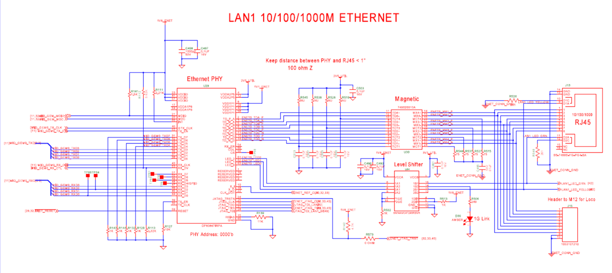

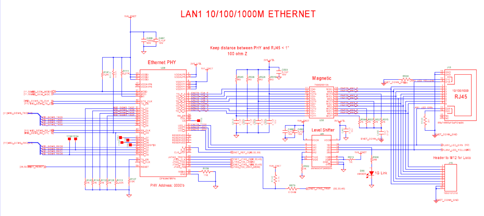

The customer is having trouble with getting the DP83867IRPAPT to pass ethernet certification at 1GB. They tested several chips from multiple lot codes and the only chip that passed certification testing and had the register that changed the output was one they removed from an evaluation board and soldered onto the board.
All the chips function fine, but won't pass certification at 1GB
Also, they write to the register and can read back what they wrote, but the output does not change.
