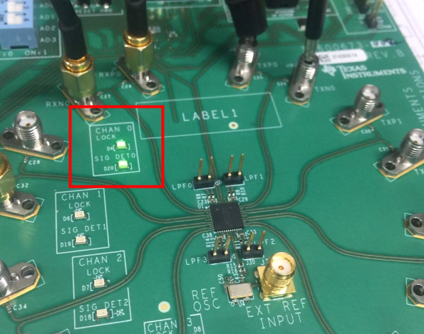

  • Hi Andysss,
    Reviewed your register settings and it seems device is locked and thus we should be able to output I/Q clock as noted in table 6 of the data sheet. Let's do this:  First please make sure channel 0 is locked and then set reg 0x09[5]=1'b1. Further, try settings reg 0x1E[7:5]=3'b010. You can also try setting reg 0x09[7:0]=0x49.
    Regards,, Nasser
  • Dear Nasser,
    I'm sure  there is a singal locked in channel 0,the Locked LED is on and Reg 0x02=0xDC
    I have tested set Reg 0x09[7:0]=0x20 or 0x09[7:0]=0x49, 0x1E[7:0]=0x49,but can't output the clock
    Is there any other Reg need to setting?

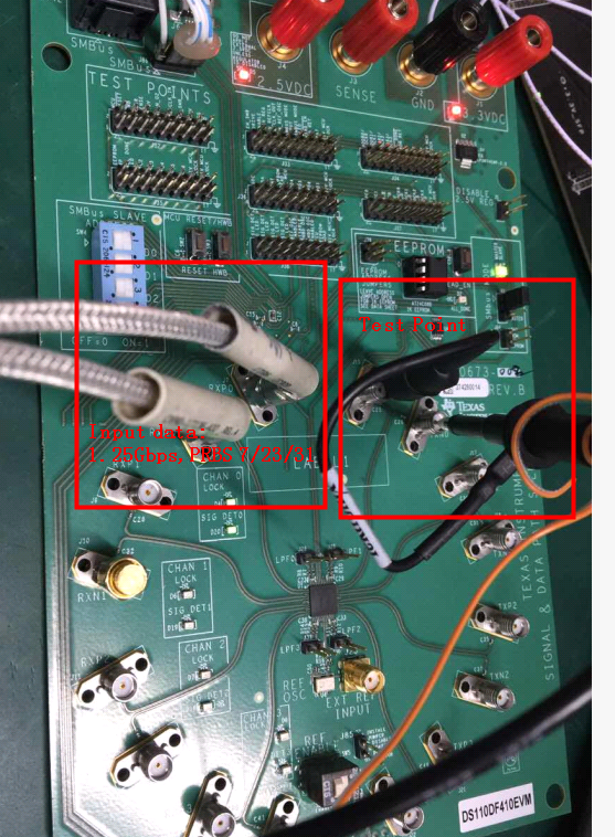

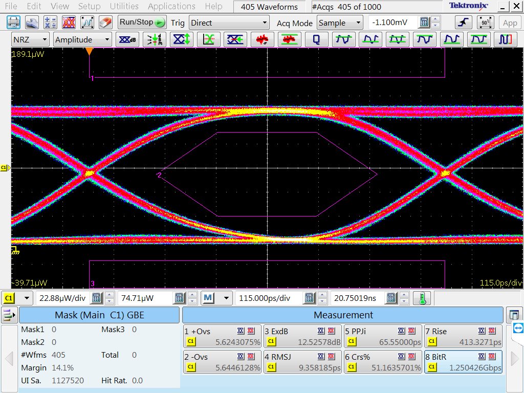

  • Greetings,
    We have tested it again, input data rate  is 1.25Gbps and pattern is PRBS 7/23/31;
    There is a video, in the video 8 seconds before we set output 10M clock is ok and last two seconds we set output I‘clock is fail
    There is any picture/video/log about the test, We can't find out what's wrong
    1E-49.cfg
    1E_40.cfg
    This picture is test DS110DF410 output  The eye diagram
    Best regards..

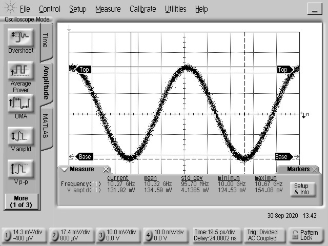

  • Greetings,
    We ran a test in lab -channel 0 - and please below note 10GHz eye diagram and register settings. We used the same register settings that we had recommended earlier.
    Regards,, NasserRX Recovered Clock CH0.cfg

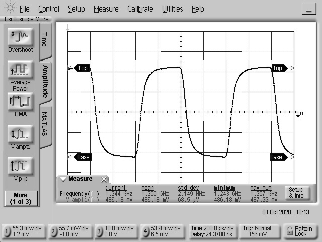

  • Greetings,
    Device can output clock either at 10GHz or 1.25GHz. Earlier, i showed 10GHz recovered clock and below is 1.25GHz recovered clock.
    Regards,, Nasser

    3) We want to the i-clock divider by 2(4 or 8 is ok).for example 10.3125Gbps data recovery 10.3125Ghz clock,we want the i-clock is 5.51625Ghz (2.278125Ghz or 1.289Ghz is ok) and the clock must synchronize with input data.
    4)earlier,you shared the Recovery 10Ghz clock,We noted the clock amplitude is only 130mVp-p, How to increase the amplitude through registers(compensation for high loss)?
    Best Regards..
  • Hi, see my inputs below to the four listed items.
    1. The retimer allows for the support of two separate VCO frequency groups simultaneously. Please refer to DS125DF111 datasheet Section 7.5.1.11 "Rate and Subrate Setting"
    2. The DS125DF111 has a signal detect status observation bit. It is channel register 0x54[7]
    3. There is no clear question here
    4.  The recovered clock amplitude is fixed and not adjustable
