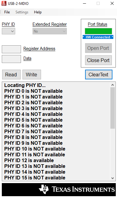

    I have one more question about PHY_ID. We have two similar designs: one uses DP83867IRPAP 64-pin package, and the other uses DP83867IRRGZ 48-pin package. Both designs use same resistor strap configuration. In both designs, RX_D0 pin is connected to GND through a 1K resister, and RX_D2 pin is connected to VDDIO through 1K resistor. Once power up, the expected PHY_ID should be 0x0C.
    We use TI Launch PAD and USB-2-MDIO tool kit to read PHY-ID once the board is powered up. The 64-pin board PHY_ID is available at 12, while the 48-pin board has no available PHY_ID, as shown in following screen shots:
    By the way, the test condition is the same, and two designs' schematic are almost the same.
    Could you shed a light for us about what will have effect on PHY_ID value? How can we get available PHY ID value?

  • Hi Jimmy,
    Regarding 48pin's phy id not showing up :
    I noticed that 64 pin version has a reset scheme attached to the resetn pin and that is not there with 48pin version. May be the 25MHz oscillator is not stablizing before the power ramp is stable and this may make the phy go into unknown state. Can we trying toggling the resetn pin (when you see no phy id issue) and then try to poll phy id? If the problem is because of clock stability during power-up, applying resetn should resolve it.

  • Hi Vikram,
    Our 48-pin design has reset circuit there. Do you think the reset circuit works?
    If we don't think 25MHz oscillator is stable at the time of power ramp up, the oscillator is stable at the reset button is pressed and released so the PHY-ID should be latched into PHY register. However, the PHY_ID is still not available

    For 48-pin design, we do see the 25MHz clock on clkout pin. Vbrias= 1.0017V,  Also we see the MDI signal using a scope:
    We do use same LaunchPAD kit for PHY register access for both 64-pin and 48-pin designs.
    Question here is why PHY_ID is not available in our 48-pin design. It should only relating to resistor strap configuration on RX_D0 and RX_D2.

    Looks like phy is powered up with clkout, rbias and MDI checks. Also you mentioned earlier that even by applying reset later in time (when input clock is stable) does not make phy id to appear. Only remaining thing that I can think of is that is there any difference in MDC/MDIO routing between 48 pin board and 64 pin device? Is there some other device connected to MDIO line which is holding the line to a low or high value? May be we can capture MDIO and MDC signals to see if they are toggling fine for the 48 pin device.

    Regarding 48-pin design:
    MDC/MDIO are connected to both MAC and LaunchPAD MDC/MDIO. But both MDC/MDIO signal are toggle, as shown in the scope:
    Above scope trace is recorded while USB-2-MDIO GUI scans PHY_ID.
    It is a puzzle of no PHY_ID value in 48-pin design.

    Thanks for sharing the waveforms. Looks like there is some toggling but we may need to look at the zoomed version to see the data. Can we get the zoomed in scope capture of MDC and MDIO for first 40 cycles of MDC clock when you read register 0x0001 giving phy_id = 00 through usb2mdio tool? This will cover one complete read cycle of register and will help us know how phy is reacting to read request.
    As MAC and PHY are connected together when you are accessing MDC, MDIO bus...so is it possible to power down MAC so that only effectively PHY is on the line.
    Yes it is puzzling to see that PHY is not responding to any phy address even when we have checked that PHY is powered up fine.
    Vikram
  • Hi Vikram,
    We have proved that our 48-pin board has valid PHY_ID using SMI bus tool developed by our SW team. The reason before no stable PHY_ID via TI LaunchPAD is there is another master on SMI bus, from MAC device. Now, only MAC device is used, and no TI LaunchPAD involved. so stable PHY_ID can be obtained.
