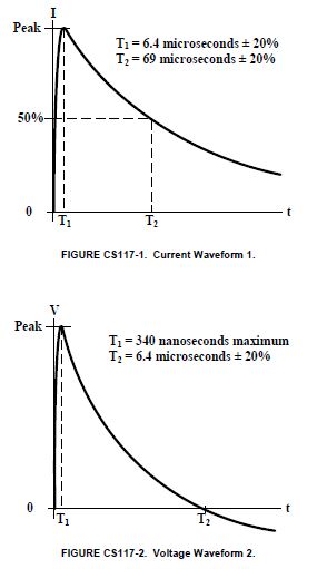

I have used AM26LV31E & AM26LV32E in my designs. I want to know whether these components are complied with either MIL-STD-461G or DO-160G standards? Especially Lightening tests, where Multiple stroke voltages & currents will be  induced on the cable bundle of RS422. Please suggest. Our design is refers to the Internal Equipment Levels in the table below.

    Multiple Stroke
    Applicability
    Test Description
    Internal
    Equipment Levels**
    External
    Equipment Levels**
    All equipment installations
    Waveform 2 (WF2)/ Waveform 1 (WF1)
    First Stroke
    VL = 300 V (WF2) IT = 600 A (WF1) IT = 60 A*
    Subsequent Strokes VL = 150 V (WF2) IT = 150 A (WF1)
    IT = 30 A*
    First Stroke
    VL = 750 V (WF2) IT = 1500 A (WF1) IT = 150 A* Subsequent Strokes VL = 375 V (WF2) IT = 375 A (WF1)
    IT = 75 A*
    Waveform 3 (WF3) –
    1 MHz and 10 MHz
    First Stroke
    VT = 600 V (WF3) IL = 120 A (WF3) IL = 24 A*
    Subsequent Strokes VT = 300 V (WF3) IL = 60 A (WF3)
    IL = 12 A*
    First Stroke
    VT = 1500 V (WF3) IL = 300 A (WF3)
    IL = 60 A* Subsequent Strokes VT = 750 V (WF3) IL = 150 A (WF3)
    IL = 30 A*

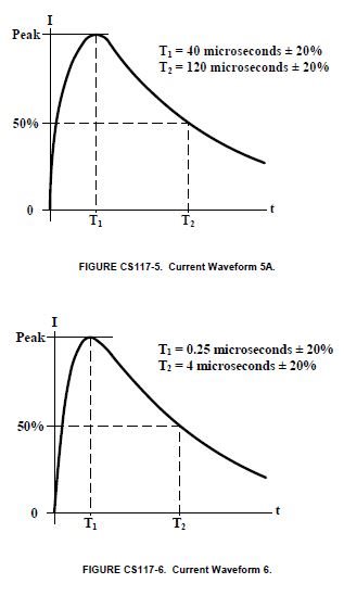

    Equipment installations routed in areas with composite skin/structure.
    Waveform 4 (WF4)/ Waveform 5A (WF5A)
    First Stroke
    VL = 300 V (WF4)
    IT = 1000 A (WF5A)
    IT = 300 A*
    Subsequent Strokes
    VL = 75 V (WF4)
    IT = 200 A (WF5A)
    IT = 150 A*
    First Stroke
    VL = 750 V (WF4)
    IT = 2000 A (WF5A)
    IT = 750 A*
    Subsequent Strokes
    VL = 187.5 V (WF4) IT = 400 A (WF5A) IT = 375 A*
    Multiple Burst
    Applicability
    Test Description
    Internal
    Equipment Levels**
    External
    Equipment Levels**
    Waveform 3 (WF3) –
    1 MHz and 10 MHz
    VT = 360 V (WF3) IL = 6 A (WF3)
    VT = 900 V (WF3) IL = 15 A (WF3)
    Equipment installations that utilize short, low
    impedance cable bundle installations.
    Waveform 6 (WF6)
    VL = 600 V (WF6) IT = 30 A (WF6)
    VL = 1500 V (WF6) IT = 75 A (WF6)
    Notes:
    *These current levels are intended for individual power leads or low count wire bundles. When multiple leads are tested together, this current shall be increased to the full bundle level or to the number of leads multiplied by the appropriate individual current test or limit level, whichever is less.
    **Amplitude Tolerance is +20%,-0% for all waveforms, except the tolerance is relaxed to +50%,-0% for the Subsequent Strokes. VT represents the test voltage level in volts and IT represents the test current
    level in amperes. VL (volts) and IL (amperes) represent limits intended to prevent over-stressing the EUT
    beyond the requirements.

    We would be injecting transients on shielded cable. But, I'm not sure about the transient levels reaching the device Pin. We are using TVS to protect the interface/device in our design. But, not sure whether TVS can save the device or not.
    We have to impose cable injection lightning requirements of MIL-STD-461G CS117. The severity of the strokes are given below.
    -Raghavendra
  • Raghavendra,
    Thanks for your information. I understand the severity of the strikes, however how much energy reaches the IC pins depending on several factors like the cable impedance, device input impedance, capacitor between the shield and the wire, capacitor of the wire. Maybe you can do some rough estimate based on a simplified schematic. After that, you might be able to choose the proper TVS diode. Here are some reference about diode selection.
