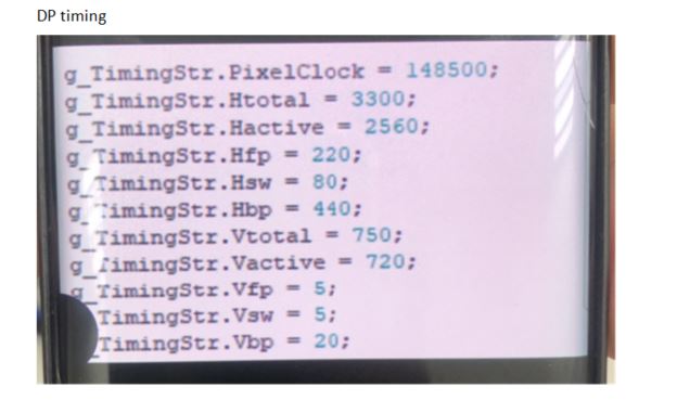

Below is the MIPI DSI input timing.
and below is the DP output timing we need.
Please help check our registers setting. if any wrong please let me know. thanks~

  • Hi Sir,
    I cannot see the picture in last post. so I add a attached file for timing spec.
    SN65DSI86 timing.docx
    It looks like you are programming the DSI86 Video Registers with the DSI interface video timing. You should program the DSI86 Video Registers with the Video format that is expected to be displayed on the eDP panel.
    If I looked at the HBP for the DP timing, it is decimal 440 which is hex 0x1B8. This is outside the DSI86 Video Registers programming field, is this the correct timing value? Do you have the actual EDID of the panel?

  • SN65DSI86_PANEL_VIDEOREGISTER_CALC.zipHi David,
    I think we need MIPI DSI's HBP is 220 of dual channel mode(CHA and CHB), and DP output is HBP = 440.
    So, If we set the HBP of CHA to 220 and dual channel mode.
    Does it mean that the HBP of CHB is the same as CHA and the value is 220.
    Attached file is our setting.
    Thanks for your help!

    The issue here is the DP timing, especially the back porch value. If the back porch is decimal 440, then this is larger than the DSI86 video timing register bit field and this particular panel can't be supported by the DSI86.

  • Delo
    The DSI86 will use the parameters in its Video Registers to determine the DisplayPort MSA parameters that are transmitted over DisplayPort every vertical blanking period. These MSA parameters are used by the eDP panel to recreate the video format provided on the DSI interface. So we should look at the eDP panel spec.
    The issue here is that the HBP is 440, this is larger than the maximum value can be programmed in register 0x34.
    When configured for dual DSI channels, the DSI86 will use VSS, VSE, and HSS packets from channel A. The DSI86 will use channel A events to recreate the same timings on the DisplayPort interface. The VSS, VSE, and HSS packets from channel B are used to internally align data on channel B to channel A.
    David
