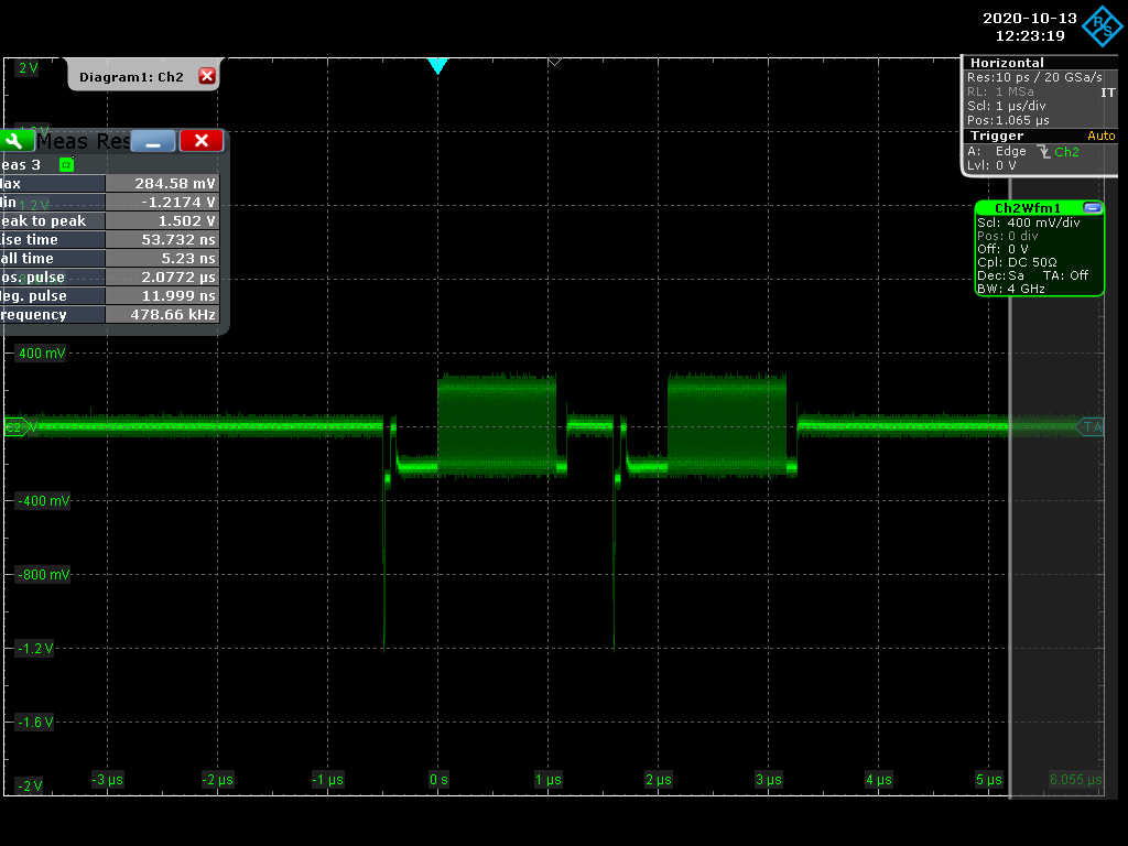

Any idea what happen to DS90UH940 and what we can do to recover it ?
We are connecting DS90UH940 to DS90UH925 .
Some times DS90UH940 CSI output will become abnormal if we keep DS90UH940 at power on and power off then power on the DS90UH925 . (See below for DS90UH940 CSI abnormal waveform)
When DS90U940 CSI output abnormal, we try below action it see if the CSI abnormal can be recovered
1. Pull low PDB pin to reset DS90UH940 ==> it works, CSI output become ok again
2. Digital Reset 0 DS90UH940 register 0x01[1] = 1 => it does not work, CSI output still abnormal
3. Digital Reset 1 DS90UH940 register 0x01[0] = 1 => it does not work, CSI output still abnormal
4. Reset the deserializer AEQ, (program the register bit 0x35[6] =1 and then 0x35[6] =0) => it does not work, CSI output still abnormal
DS90UH940 CSI clock NG waveform
DS90UH940 CSI D0 NG waveform

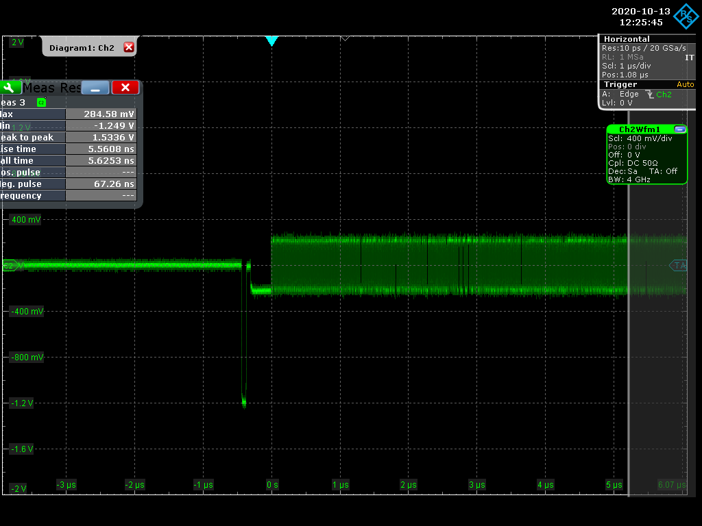

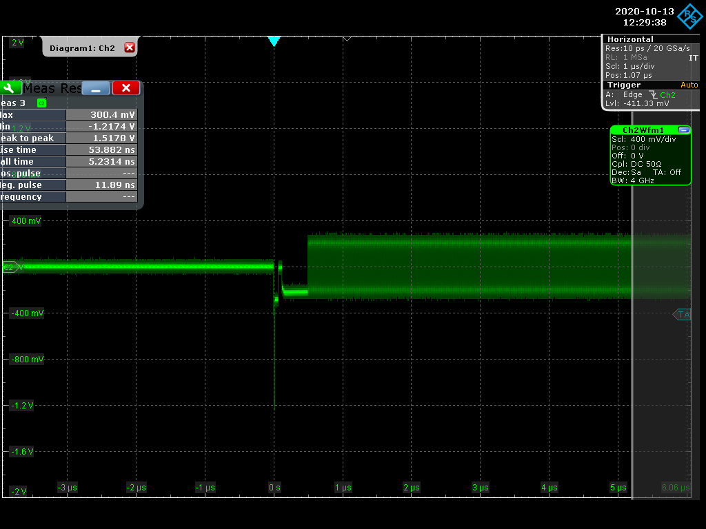

DS90UH940 CSI clock OK waveform
DS90UH940 CSI D0 OK waveform

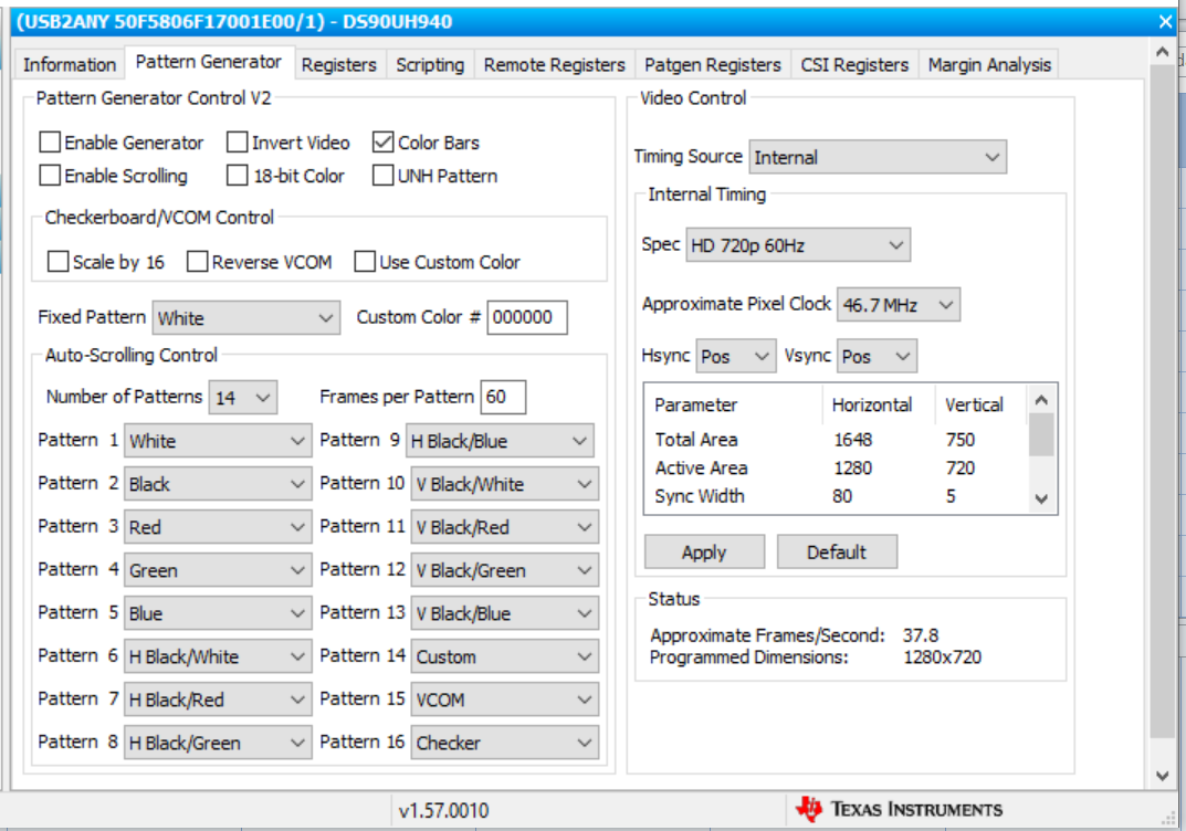

4. Enable and disable the pattern as below picture => OK
