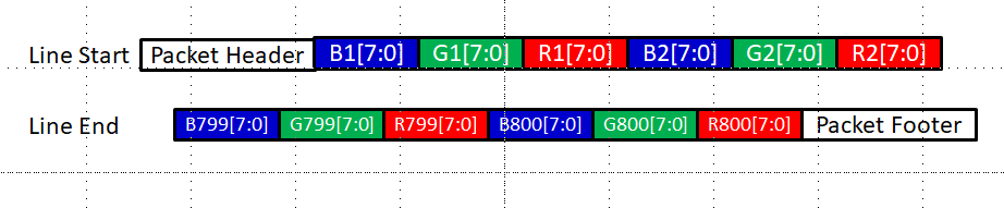

May I confirm DS90UH940-Q1 MIPI CSI RGB888 output format ?
is it follow below byte order ? (Packet header -> Blue color data --> Green color data --> Red color data -> Blue color data --> Green color data --> Red color data -> ..
The 940 device output follows the standard MIPI CSI-2 spec. The byte order you have listed is correct.
