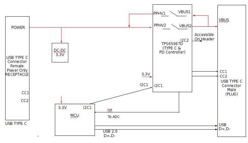

We are using TPS65987 in our android accessory design.
Following is the top level block diagram using TPS65987D.
1. We are drawing the power from type c Receptacle connector and passing power through the android smartphone/Tablet using type c plug connector.
2. We have to keep our accessory in device mode (UFP) as smartphone/Tablet will be Host for data transfer. Power role should be dual role for sink and source.
If power adapter is there on receptacle connector than we required to charge the smartphone and if adapter is not there we need to sink the power from the
smartphone.
3. So we would like to know in which configuration we can achieve this. Fast role swap is required to support this?
if yes than how can we achieve ?
  • Hi Paresh,
    What will you be attaching for the power receptacle? The power and data configurations should not be an issue but I am not sure if this will be compliant to the USB-IF specification document and requirements. Will this be mainly used to charge the Android smartphone?
    This type of design may not be feasible, but I will discuss with my team and get back to you next week.

  • Hi Paresh,
    I believe the power pass through may work but only for a limited case such as only 5V on PPHV by connecting an external Rd.
    Unfortunately, if you are having 2 USB Type-C ports on your system then you would need either 2 PD/Type-C controllers or a dual-port controller. I also don't think you could support FRS. For FRS, you would also need another independent power source to become the supply in the case when the other power would be removed.

  • Hi Hari,
    Input is 5V coming from the receptacle connector by connecting Rd on this.
    And if we remove power adapter than we are planning to sink the power from the android smartphone by using FRS or barrel jack event as evm has shown.
    In this case can we need second PD or other power source ?
    Also we would like to know the time duration for the barrel jack event to perform the operation  so we can add the capacitance as required .
  • Hi Paresh,
    If that is the case where you will receive just a constant 5V on PPHV, I think it could work. There may be some other factors to consider as well though such as the behavior of the Android smartphone and if it would source power. In this case, you may be fine without a second PD though but I would recommend testing this on an EVM first.
    For the FRS timing, I believe the signal will pull down on CC for about 60us to 120us. I would recommend reading the FRS Application Note and the FRS White Paper for more detailed information.

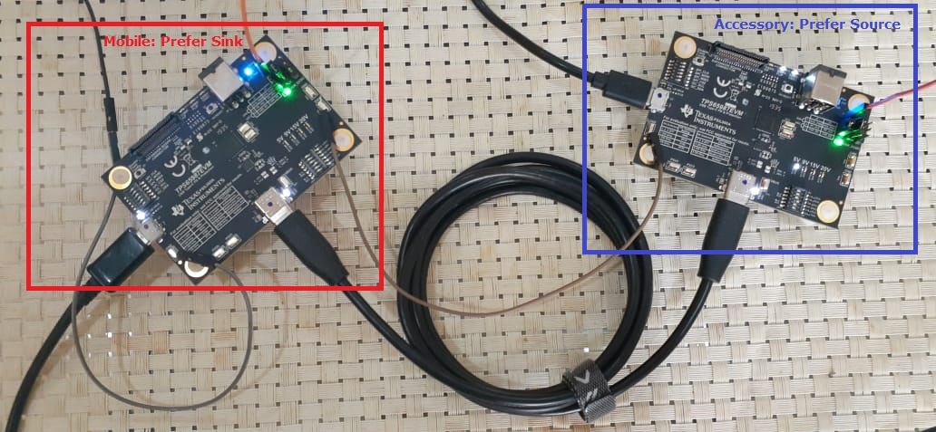

  • Hello Hari ,
    Working with Paresh on same project . We have few queries as mentioned below . Currently we have purchased 2 EVM for testing the below requirement .
    Requirement : Power Role Swapping ( FRPS & PRS ) feature without change in data role as described by Paresh in few queries back .
    EVM 1 :
    1) Data Role - USB Host / DFP Mode ( Fixed , No Change Required for our scenario )
    2) Initial Power Role - Sink
    EVM 2 :
    1) Data Role - USB Device / UFP Mode ( Fixed , No Change Required for our scenario )
    2) Initial Power Role - Source ( Shall be change / shall perform PWR Role Swap  based on Barrel Jack Event )
    In case of no Power at Barrel Jack - Shall act as Power Sink
    In case of Power at Barrel Jack - Shall act as Power Source
    Can you please provide default configuration files to accelerate our testing of the barrel JACK event feature on EVMs Setup .
    Thanks in advance .

  • Hi Hari,
    Please find attached project file for your reference.
    Following is  the observation when we test the FRS on evm.
    We have seen FRS timing 100ms to swap the power from source to sink when we remove the barrel jack.
    In this test we have used two evm board with FRS Configuration.
    As per datasheet it should be in micro Second timing FRS will take place.
    Please let us know if any change is required in project file to reduce this timing.
    mobile_pre_sink_FRS_1TX_1RX_FSRsupported_andvance.pjtacc_prefer_src_FRS_1TX_1RX_adv.pjt

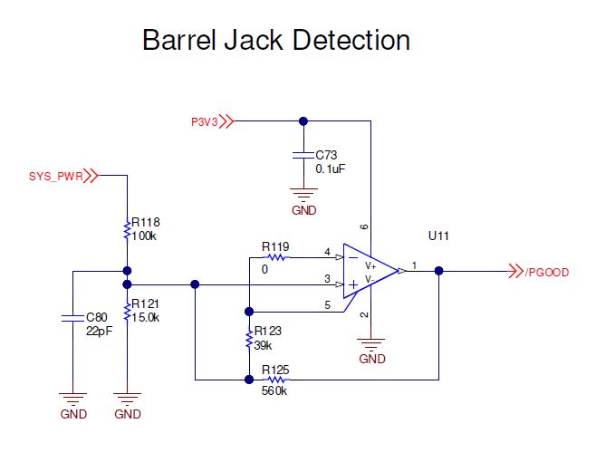

  • Hi Hari,
    Please find attached USB PD Log for your reference.
    Yes in evm there is a comparator circuit to detect the barrel jack connect and disconnect on GPIO21 so we have used GPIO21.
    Following is the screenshot from the evm schematic of TPS65987D:
  • Barrel Jack event:
    PGOOD is connected to GPIO21.

  • Hi Hari ,
    Please find attached log and image of evm schematic for barrel jack event.
    PGOOD is connected with GPIO21 for detect barrel jack.

  • Hi Hari,
    Following are the details for our setup to test with two evms:
    4010.acc_prefer_src_FRS_1TX_1RX_adv.pjt3034.mobile_pre_sink_FRS_1TX_1RX_FSRsupported_andvance.pjt
    Accessory Side: (Prefer as Source)
    1. Project File: acc_prefer_src_FRS_1TX_1RX_adv.pjt
    2. Port Configuration (0x28)
      - Port Configuration: DRP
      - Receptacle Type: Standard fully-featured USB-C receptacle
    3. Port Control (0x29)
      - PD mode: Normal PD Behavior
      - Process swap to Source
      - Initiate swap to Source
      - Process VCON swap
      - Initiate swap to UFP
    4. Transmit Source Capabilities (0x32)
      - Configured only 1 PDO with (5V and 3A)
    5. Transmit Sink Capabilities (0x33)
      - Fast Role Swap required USB Type-C Current: 5V, 3.0A
    6. PD3 Configuration Register (0x42)
      - Fast Role swap Supported
      - Fast Role swap init in mSec: 4 mS
    7. I/O Config (0x5C)
      - GPIO #21
        a. Mapped Event: Barrel Jack Detect Event
        b. GPIO Polarity: Direct-mapped Event
    Mobile Side: (Prefer as Sink)
    1. Project File: mobile_pre_sink_FRS_1TX_1RX_FSRsupported_andvance.pjt
      - Process swap to Sink
      - Initiate swap to Sink
      - Process VCON swap
    Please let us know if we have missed anything.
  • Hi Paresh,
    Thank you for the picture. I do not see a barrel jack on there, but it seems from the logs it is performing the PRS correctly.
    How do you test this setup? For example, are you powering the Mobile side and then you would like to plug in the Accessory side with the barrel jack and want to perform a PRS? This should be correct.
    Otherwise, this will not perform a FRS unless the barrel jack was already plugged in from the beginning, the mobile was the source and then suddenly it lost power in which case the FRS will be triggered. FRS only occurs when an external power source is removed, not necessarily provided.
    The USB PD Specification here will provide further details on the exact process:
    Thank you,
    Hari
