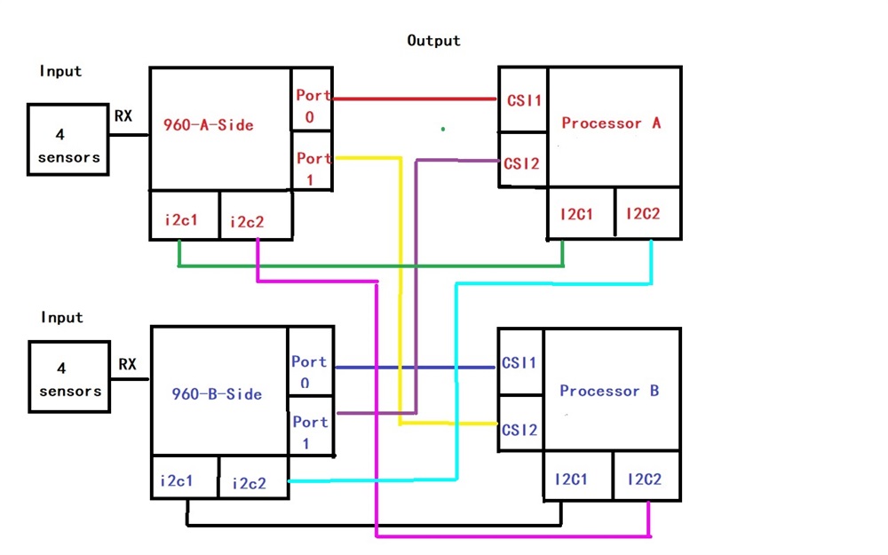

Recently, we are using 960 chip to light up the camera, the camera has been able to work normally.
I want to realize data sharing between different processors from the same camera module。
Our design is below:
Q1 :  Out design is it ok  ?

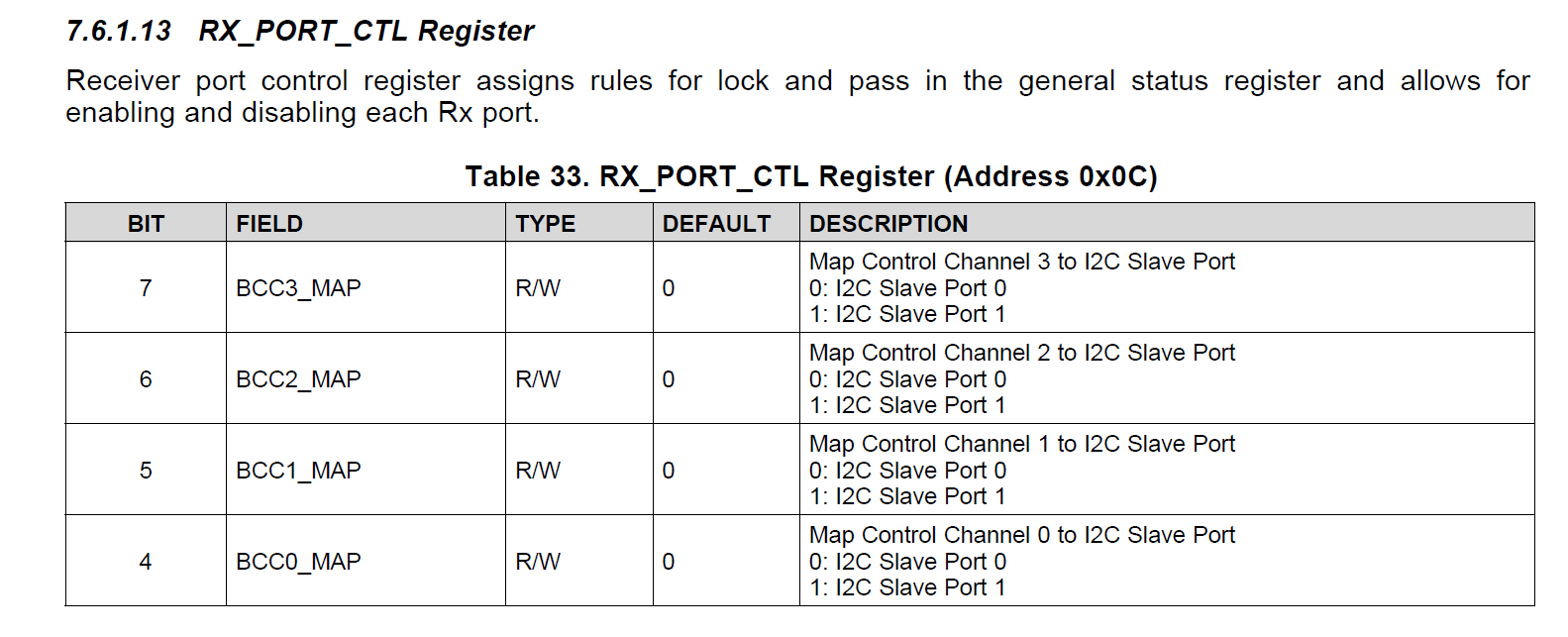

Q2:   Does this design only require one side of the processor to initialize the 960 chip ?  Does the  camera module can work properly  ?
