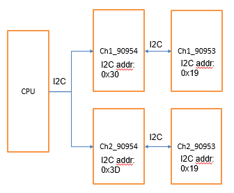

Dear team,
May I learn frim you how to read/write multi-camera by host(cpu) if they have same I2C address of 953?
block diagram as below picture showed.

Hi Ben,
Please refer to section 7.5.3 Remote Slave Operation and 7.5.4 Remote Slave Addressing in our DS90UB954-Q1 datasheet.

Hi Sally,
Thanks for your information.
Customer would like to ask if we have sample code for SlaveAlias setting or not.
Could you guide customer how to read/write SlaveAlias when multi-953 user case?
Ben
Hi Ben,
camAlias = 0x?? -> user define
camAddr = 0x?? -> fcheck camera d/s
serAlias = 0x?? -> user define
serAddr = 0x?? -> from IDX strap
devAddr = 0x?? -> from IDX strap

Hi Sally,
Customer cannot read back the right register value, could you help to guide customer how to fix this issue?
Please refer to customer's setting below.
Step1: CH1_write:
#90954 port 0 read/write
board.WriteI2C(0x60,0x4c,0x01)
# 90954 setup Ser ID and Alias
board.WriteI2C(0x60, 0x5b, 0x32)
board.WriteI2C(0x60, 0x5c, 0x32)
# 90954 setup Cam ID and Alias
board.WriteI2C(0x60,0x5d,0x34)
board.WriteI2C(0x60,0x65,0x34)
# 90953 write LOCAL_GPIO_DATA
board.WriteI2C(0x32,0x0d,0x0f)
Step2: CH2_read:
board.WriteI2C(0x7a,0x4c,0x01)
# setup Ser ID and Alias
board.WriteI2C(0x7a, 0x5b, 0x32)
board.WriteI2C(0x7a, 0x5c, 0x32)
# setup Cam ID and Alias
board.WriteI2C(0x7a,0x5d,0x34)
board.WriteI2C(0x7a,0x65,0x34)
# 90953 read LOCAL_GPIO_DATA
board.ReadI2C(0x32,0x0d,0x33,0x0f) -> I should get 0x07, but got 0x0f.
Note:
CH1_addresses:
camAlias = 0x34 -> user define
camAddr = 0x34 -> fcheck camera d/s
serAlias = 0x32 -> user define
serAddr = 0x32 -> from IDX strap
devAddr = 0x60 -> from IDX strap
CH2_addresses:
devAddr = 0x7a -> from IDX strap

Ben,
can you decode this test.log clarify "Customer cannot read back the right register value"? for example, which slave ID and which reg. can't be read?
the log mixed many other messages, we can't understand it clearly.

Hi Steven,
Please refer customer's code in 2020/12/20 of this post.
There are two 954 and each of deseri connect to one 953 chip.
According to the reference code in this post, customer have wrote the test commend.
They write CH1 comment as 0x0f in below.
Then read CH2 as below. They expect the value read back should be 0x07, but it's 0x0f which means both 953 have been write to 0x0f.
Could you help to solve this issue?
what is the command "board.ReadI2C(0x32,0x0d,0x33,0x0f)"?
and what is the "0x32" in you case, is it your 953 IDX? if yes, it is correct as you had write reg. 0x0D with 0x0F, so you can read reg. 0x0D as 0x0F returned value.

Note:
CH1_addresses:
CH2_addresses:
This is one basic function on I2C operation and can get this answer from d/s example or EVM user guide. btw, some IDX assigned is based on your system definition, so it is required that the board designer or system designer should know it well!
1. checking if local I2C can work or not? //if not, you can follow up the d/s request on idx setting request
2. check remote I2C accessment with below// sally had replied your message.
3. in your block pls use the 8bits IDX, you can refer to 953/954 on the IDX setting. in below example, Pls input your upper 954 idx 954_1 and bottom idx 954_2 based on your 954 IDX setting in your case.
Upper 954 I2C addr. setting:
board.WriteI2C(954_1,0x4c,0x01) //supposing camera is linked to port0 & 954_1 = IDX design in your case, referring to 954 d/s on the IDX setting to get the final value
# I2C passthrough and IDx setting
enable pass-through in 954's reg. 0x58[6], other bits are dependent on your system design // enable passthrough remote I2C
board.WriteI2C(0954_1, 0x5c, 0x34) // 953 camera which is linked to port0, its alias IDX is assigned as 0x34
bottom 954 I2C addr. setting
board.WriteI2C(954_2,0x4c,0x01) //supposing camera is linked to port0 & 954_2 = IDX design in your case, referring to 954 d/s on the IDX setting to get the final value
board.WriteI2C(0954_2, 0x5c, 0x36) // 953 camera which is linked to port0, its alias IDX is assigned as 0x36
upper 953 reading:
# read reg. 0x0D
board.ReadI2C(0x34,0x0D).
Bottome 953 reading:
# read reg. 0x0D
board.ReadI2C(0x36,0x0D).
