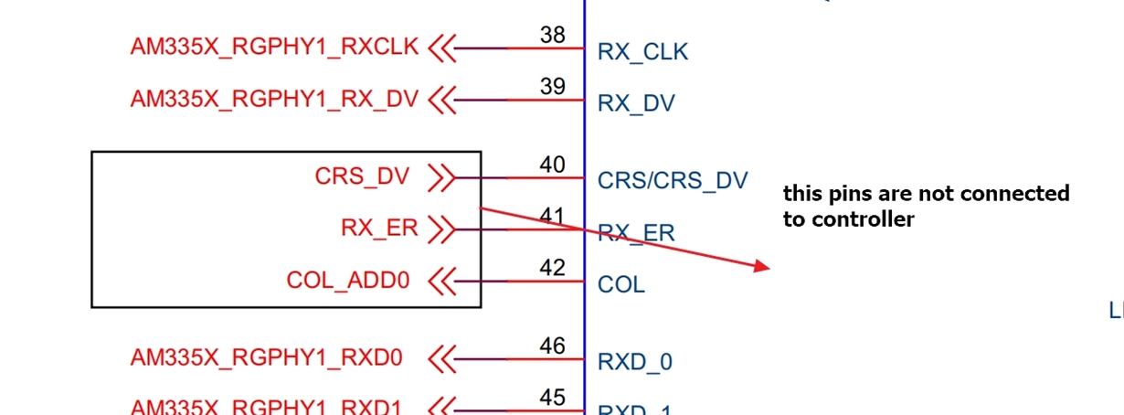

Present  OEM module design,  We have used dual "BCM54616S" Broadcom 10/100/1000 Phy chip with the copper interface.  This Phy did not require dedicated  COL, RX_ER, and CRS. So we used the COL, RX_ER, and CRS dedicated pins of the AM335x controller for some other applications.

    I would like to confirm the setup you are describing. The DP83460 CRS_DV, RX_ER, COL pins are available from the PHY perspective but these pins have been utilized on the AM335X's side?
    Anees - Yes, these pins are used for SPI and UART interface from the controller side.  please refer to the below images. These pins are not required on the Broadcom side.

  • Hi Anees,
    As stated above, in RMII the CRS_DV pin is needed in the DP83640. I expect the BCM54616S device was connected in RGMII or SGMII where there is no CRS pin.
    The DP83640 PHY cannot configure any other pin to carry the CRS signal, these pins and functions are defined by the RMII specification.

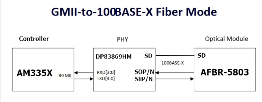

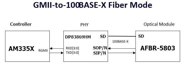

    Please check the  PHY chip-  DP83869HM part is suitable to interface AM335x with RGMII  and the PHY chip FIber Out /Input signal to the SC FO module ( AFBR-59E4APZ)   . Also, please refer to the below block diagram.

  • Hi Nick,
    No sir, we want to move the RGMII with Broadcom PHY chip to RGMII with TI  DP83869HM PHY chip. And we need to connect the  DP83869HM  PHY chip to the Broadcom SC FO module ( AFBR-59E4APZ). Please conform to the same.

    Ok, got it. We were confused about the part number:  DP83640 in your original post supports RMII. RMII requires a crs_dv signal. DP83869HM supports RGMII. RGMII does not use CRS_DV, RX_ER, COL signals. I have updated your original post based on your Dec 14 post.
    I would expect that you could use the same AM335x signals for RGMII connections to BCM54616S and DP83869HM. I am going to reassign this thread back to the PHY team so they can comment if they have additional feedback.

  • Hi Anees,
    Yes, the AFBR-5803 is a suitable SFP for the DP83869HM device.
    Justin
