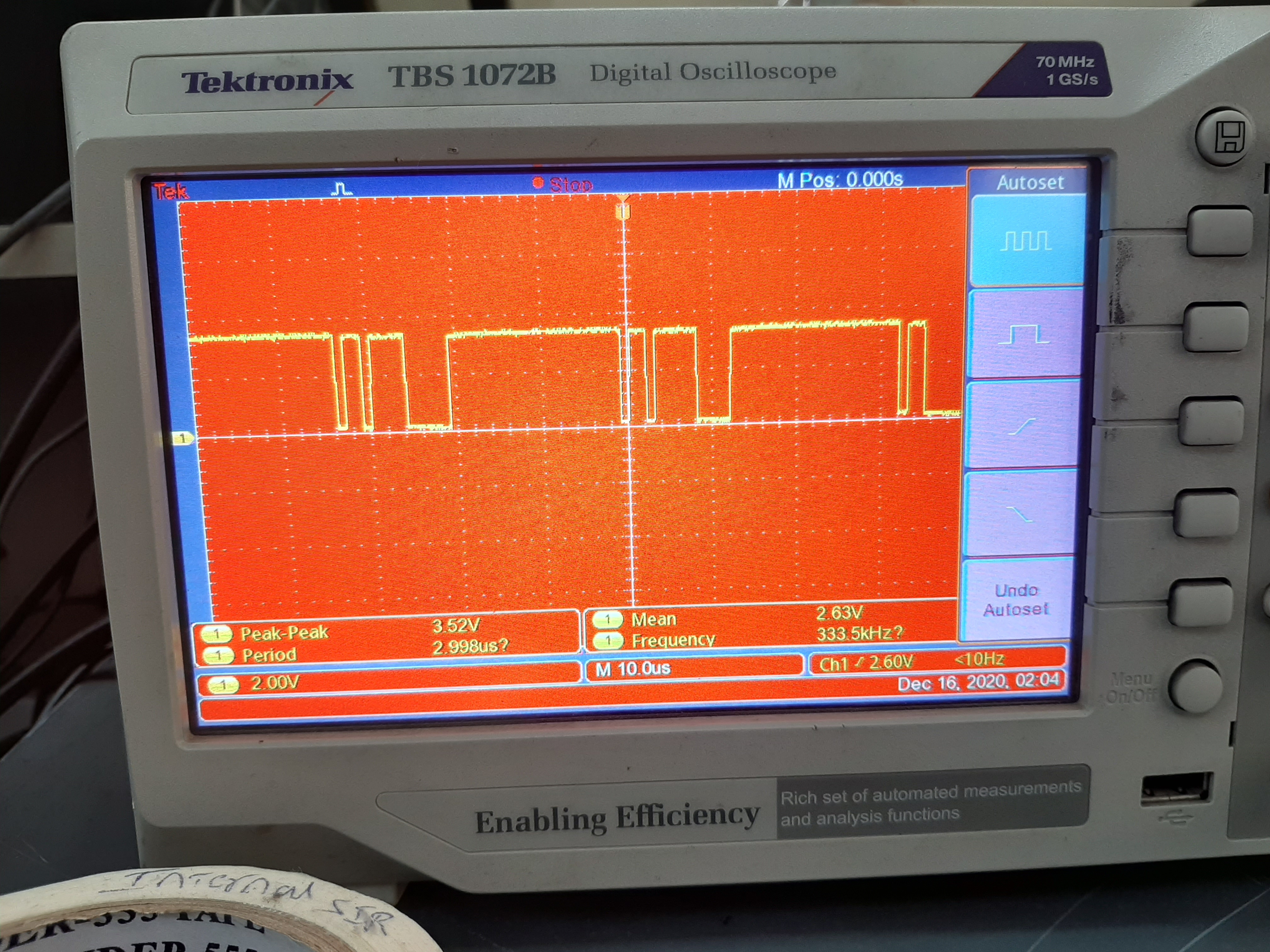

I am using DP83640TVV/NOPB with Sitara AM3358 processor in RMII mode. After connecting ethernet cable to laptop and connector, led link and led act are not glowing and Link status is coming zero after reading the Basic mode status register. After enabling auto negotiation, auto negotiation complete bit in BMSR is coming zero after waiting for 5-6 seconds.
For Completing auto negotiation link should be established, right?
Do I need to configure IC to established the link?
Without running any code, after connecting LAN cable to laptop and connector, led link should glow, right?
I am working from scratch on ethernet. I am attaching schematic for your reference. If any other information required please let me know.
Kindly suggest any solution to debug this problem.

    Can you send some scope captures of the signal on the MDI pins? What is the link partner you are using, and have you tried using a known good link partner?

  • Gerome,
    I am attaching scope captures of MDIO clock pin and MDIO data pin.
    I have attached PHY chip schematic in 1st post. Could you please check bootstrapped? I have connected ethernet cable to this PHY chip and on other end to my desktop. In my desktop RJ45 port is working port.

  • Hello Gaurav,
    The registers looked okay. I would like to move the focus onto the RJ-45 section. I don't see that schematic in the file you sent me, but can you probe for MDI signals off of the RJ-45 cable? You should be seeing auto-negotiation pulses when the other side of the cable is connected to the PHY, and vise versa if you plug part of the cable into your PC and probe off the other side.
    Also, can you confirm that the signal on pins 42-46 are going into high impedance pins on the MAC?
    Another note, your current limiting resistors for your LED's seem a little high. I would suggest using 165 Ohm resistors as current limiting resistors. For your parallel resistor on pin 27, the 2.2kOHM value is fine.

  • Gerome,
    Link has been established. It was a problem of capacitor.
