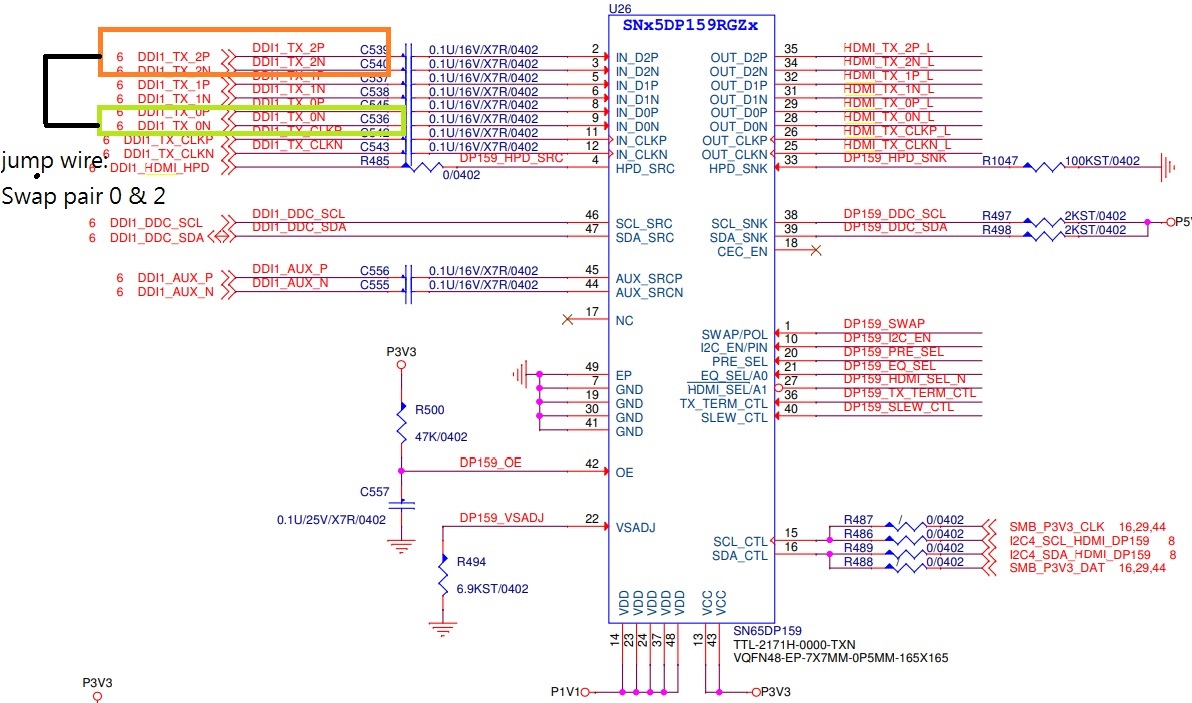

Intel cpu (Elkhart lake) has read EDID on monitor and output HDMI signals (from intel to DP159).
But the monitor still show "no input vedio signals", any suggestion for this issue?
By the way, two of TMDS pairs are swap connected but I already jump wired them.

    Can I take a look at your schematic and can you also mark on the schematic where you jump wired the fix?
    David
  • 0385.sch_DP159.pdfHi David,
    I attached files for schematics and jump wired for reference.
    If avaiable, could you help to arrange a FAE to our side for debug this issue?  8838.sch_intel.pdf
  • Shane
    1. I would remove R500 since the OE pin already has an internal pullup and change C557 to 0.22uF cap
    2. Please leave TERM, PRE_SEL, and EQ to be NC
    3. I would reduce the R494 to 6.4k
    Can you please verify the DP159_HPD_SNK is driven high. If DP159_HPD_SNK is driven high, can you please probe the clock output and verify the clock frequency?
    Can you also dump out the DP159 Page 0 and Page 1 registers? To dump out the Page 1 registers, please write 0x01 to register 0xFF first, and then dump from register 0x00 to 0xB1.

  • David,
        -->Rework done
       -->Rework done
      -->Rework done

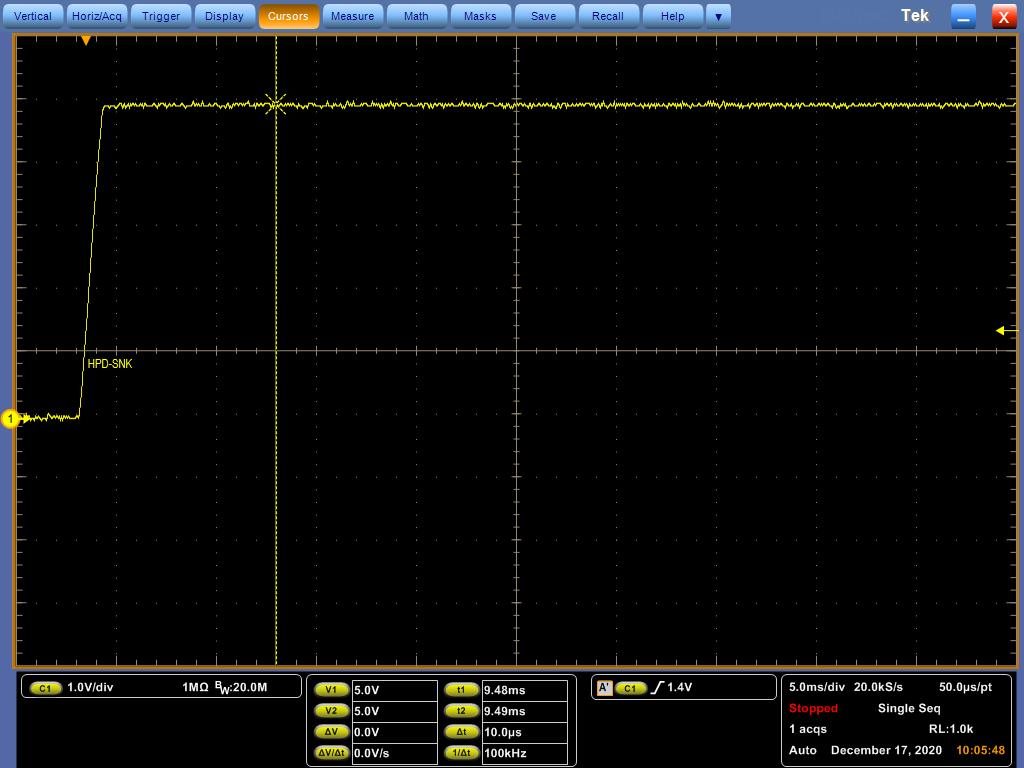

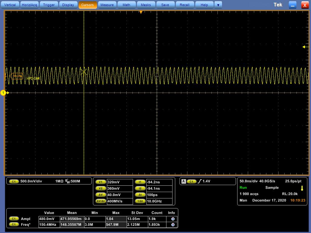

     -->Yes, HPD_SNK is driven high and clock output is about 148MHz. Please see the attached wavefoem.

    If you are seeing the clock output, to me the DP159 is working. I will double check the lane order between the Intel Elkhart Lake and the DP159 and the rework you did to make sure they are correct.
    If you change the resolution to 1080p or 4k@30Hz, are you able to see the clock frequency change as well?

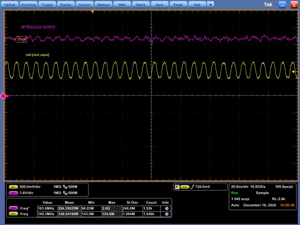

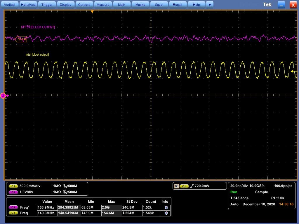

  • David,
    The clock out is Intel side, I re-measure the clock waceform for both Intel and DP159.
    No clock signals from DP159, please refer to attached waveform.
    Thanks!
    Shane
