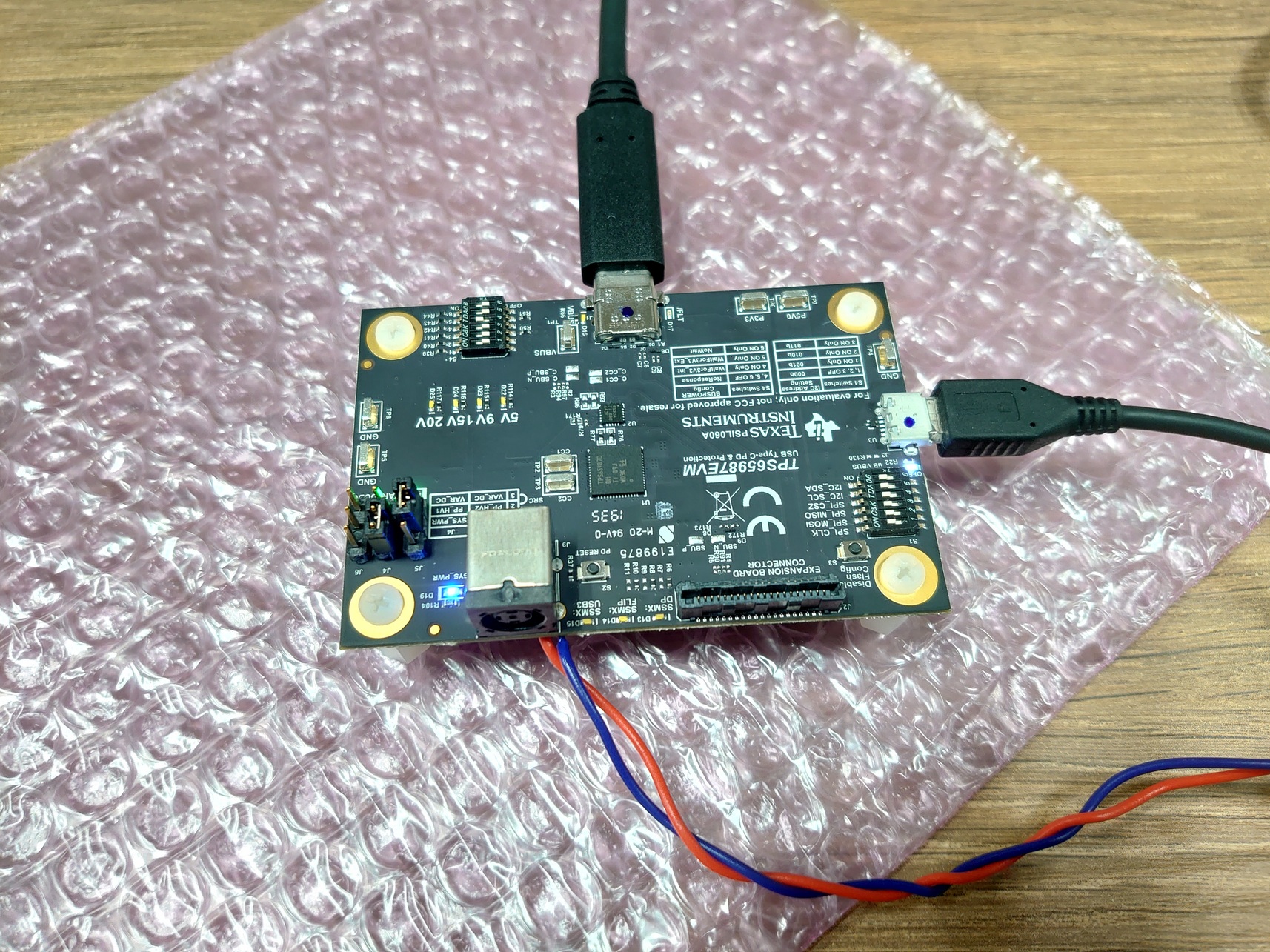

    I believe there is a duplicate thread on this: https://e2e.ti.com/support/interface/f/138/t/965614
    I tested you PJT file on the EVM and it is working (I had to modify the GPIO for Port 0 Source Negotiated PDO TTx to suit the EVM).
    I used the on board flash to test your configuration and I did notice that the PTCq command is indicating a configuration failure, but looks like the configuration has loaded. While this is being investigated, can you check on your side if the GPIO mapping is correct along with the type of mapping (binary encoded or direct)?

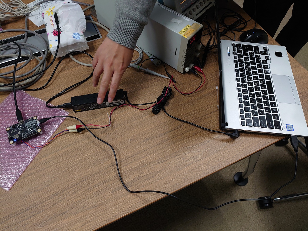

    Our setting is
    -20V input from outer source
    -Using on-board FTDI via microUSB
    But we can't find I2C device at all from PC GUI tool.Are you using AARDVARK or via microUSB.And please tell us other difference.(I attached our setting.)

  • I attached I2C log and pjt file when we try for uploading a patch bundle from an external host(Our host controller is MSP430) via I2C.
    Please review our log data for your comment.

  • I added I2C log with DRP mode.
    We confirmed CC abnormal status by checking HOST device side of log.Both CC1 and CC2 pull-up can be seen.
    When we attached AC adaptor,we should not see both CC1 and CC2
    pull-up.(Only debug-accesary mode)
    We think this means PD controller doesn't wake up correctly.
    Please review our log data,too.FCNT_DRP.pjt

    We observed CC1 and CC2 waveforms for EVM and FCNT's board.
    And we attached waveforms.
    Wa could controll via AARDVARK tool.
    We see the same waveforms CC1 and CC2 on our board,so from
    our Host device both CC1 and CC2 pull-up can be seen.
    Please inform us the possible reason.
