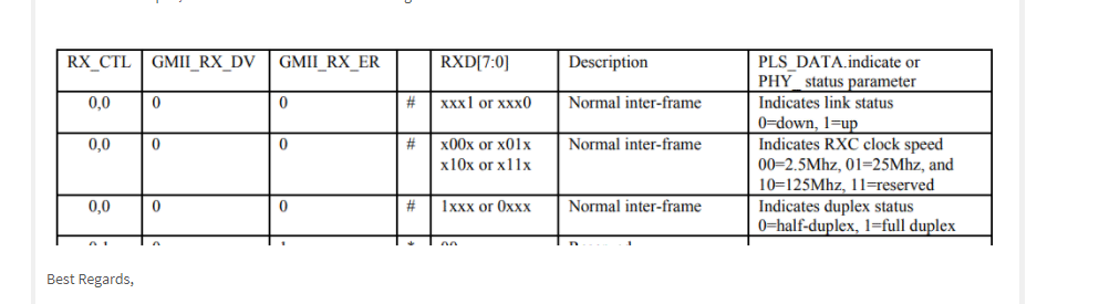

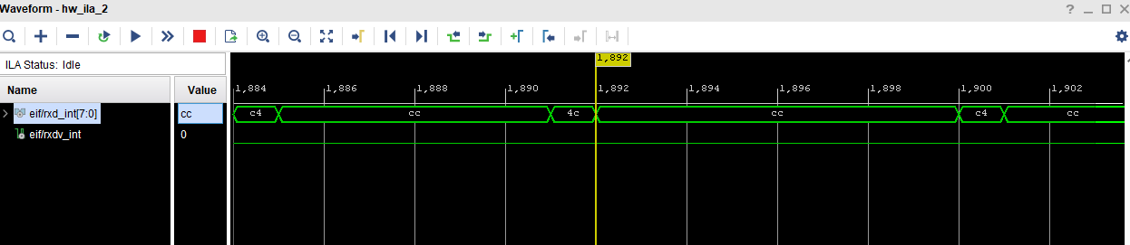

      Still no evidence of loopback, some things I have tried
      - My current implementation has 2.5ns of RX skew and programmed 2.5ns of TX skew through Phy registers.
      - Tried adding 5ns extra TX skew with Xilinx MMCM
      - Tried non loopback case to see if LED outputs will display TX activity (Link LED0 turns on when I try digital loopback), LED2 does not show TX or RX activity
      - Verified txclk, txen timing on scope (with added skew)
      - rxd path is showing both 0x4 and 0xc, 0x4 indicating 25 Mhz which is correct, but bit3 would be indicating the part switching in/out of full duplex mode????
    Thanks for any help
    George

  • Hi George,
    Can you please confirm what is meant by "rxd path is showing both 0x4 and 0xc"? Is this a register you are reading and if so, which register?
    Thank you,
    Nikhil
  • Hi Nikhil,
      I was referring to the RXD[3:0] RGMII data from the PHY.  I have yet to see RXDV assert but see 0x4/0xc returning from the Phy.  I got the below data from another forum post
    George

  • Hi Nikhil,
       That sequence results in the below trace.  I modified the 0x0000 write to 0x2100 for 100 MBps
       Getting 0xB when RX bus is idle, that indicates link up, 25 Mhz, full dup.
       The write to 0x0010, 0x5008 is something I have not attempted before.
       I don't see a TX data counter for this part so unclear how to prove that TX packets are arriving.
      Next steps?
    Thanks a bunch
    George

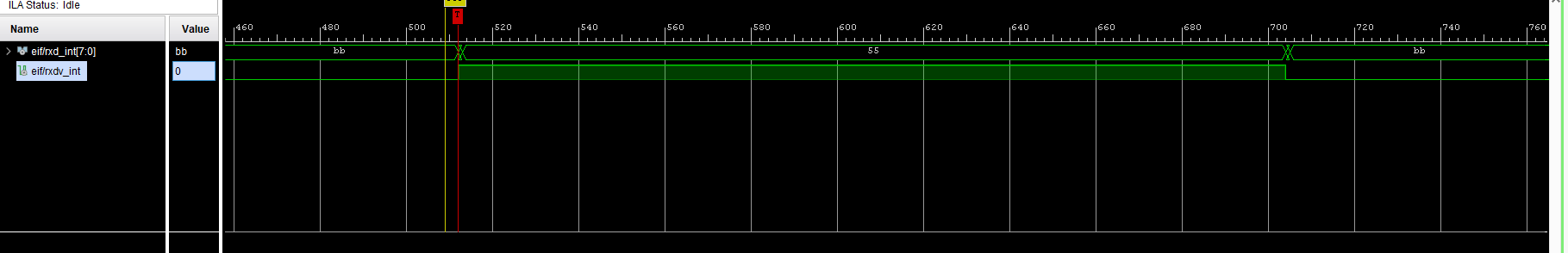

      The issue I'm currently having is that is that return data is always 0x55.  This occurs in PRBS mode or in loopback mode with PRBS off.  Different transfer lengths with PRBS off show matching between the TX data path and RX so that would indicate that the TXEN and RXDV skew timing is correct.  TX data and RX data have the same skew as TXEN and RXDV  so I would think that this is not explicitly an issue with skew.  Does the constant x55 data pattern (same pattern in PRBS or digital loopback) have some meaning?
    George

  • Hi Nikhil,
      Thank you and now I am able to RX data, however I'm still encountering issues
    - Writing 0x10 with 0x5008 (per suggestion above)
    - RX interface does not seem to be operating in RGMII, after testing loopback patterns and PRBS pattern, I'm not able to capture falling edge data
      - Have tried several skew values in register 0x86 [7:0], 0x32 = 0xd3 which should enable RX/TX delay and RGMII
      - Tried further skew using Xilinx MMCM, not able to affect RX data pattern
      - RX data always has 2 bytes of 0x55 preceding TX pattern (when not running in PRBS mode)
    Today I hope to get some of the RX data path signals on a scope to definitively determine if RGMII/DDR is working.
    Given that this part shares register set of a part with other interface options, is there some register setting I could be missing that could be confusing the RX/TX interface?  The only pertinent register I know of is 0x32 bit 7 =1
    George

  • Hi Nikhil,
      - For both PRBS mode and digital loopback mode, I see the lower nibble replicated onto the upper nibble in the RX datapath.  This happens regardless of RX skew setting or clock delay added via MMCM in the FPGA.
      - I have verified that for TX I see data bits changing on the rising and falling edge of the clock.  Data/clock is aligned coming out of the FPGA and Phy is set for 4ns of skew @25Mhz clock (100 Mbps setting)
      - I'm using ChipScope on the FPGA side to view data after the input DDR I/Os  That is where I'm seeing the upper/lower data replication.
      - Tomorrow I should be able to get some debug probes to take a look at the raw data out of the Phy.
    Since you indicate that 0x32 bit 7 is the only enable for RGMII (not sure why it would need to be enabled on a part that only supports RGMII) then it must be on my side.  Once I see the raw RX data signals I will know for sure if the RX interface is operating in RGMII mode.
    George
