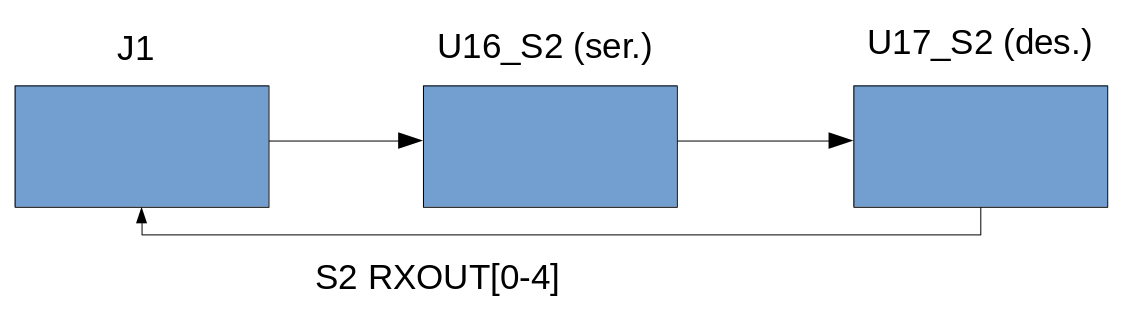

    Sorry if the schematic is unclear. Please find attached a picture representing our testing conditions.
    It is true that the board holds 4 serializers and 2 deserializers, because it is supposed to communicate with another board with 4 deserializers and 2 serializers. However, for testing purposes, we connected the U16_S2 serializer to the U17_S2 deserializer (they are at pag. 2 of the schematic).
    The serializer input comes from the J1 connector, and the deserializer output should come out of the same connector. However, we observe that when we correctly give inputs to the serialzier, we do not see a corresponding signal on the deserializer. Also, probing the serializer outputs, we do not see any signal transition.

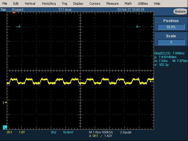

    Sorry for the delay. We tried to measure the ser-des power consumption but it was impossible since many other components share the same power lines. The only thing we can say is that they each draw about 25 mA when they are not receiving the clock and the data. About the input signal waveforms, you can find one attached (in the picture there is one of the two LVDS pairs).

    Please find attached the register dump of the ser/des pair and a picture of the noise on the power line. It is slightly above 100 mv, could this be the issue?

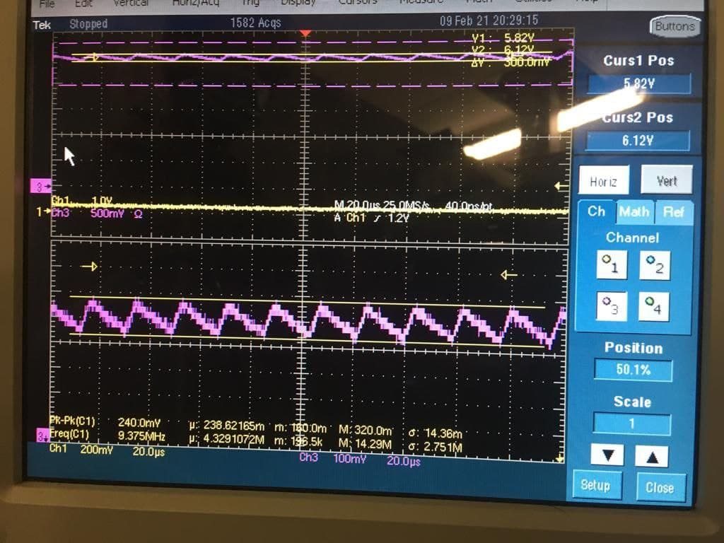

    We also checked better the power rails and we noticed a 50 KHz frequency noise (see picture) on the 2.5 V rail. This comes from the serializers/deserializers, since there is nothing else on that power rail and if we use the same power chip to power a resistor load we do not see the noise. We do not see this noise on the 3.3 V rail.

    The amplitude of that noise does exceed the datasheet recommended condition - are you able to reduce it? Also, does increasing/decreasing the frequency have any effect?

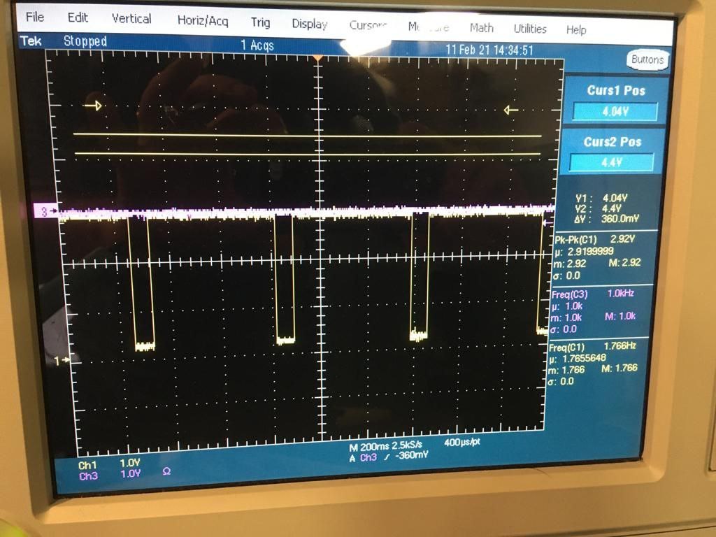

    We tried different frequencies and we noticed that with a 125 MHz frequency the /LOCK pin was toggling between 0 and 1 as in the picture.
