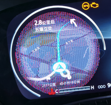

DS90UB940-Q1: blurred screen sometimes
Part Number: DS90UB940-Q1
Hi team,
customer use DS90UB949+DS90UB940. 949 is in head unit aide and 940 is in cluster side. sometimes it will have blurred screen issue. below is abnormal and normal display picture:
measure the LOCK and PASS pin is high. I attached the issue reg value and good display reg value of 940. please help to check.
comparing these two reg, I only find that the reg 0x3b is different. what's the mean of reg 0x3b? it doesn't show in datasheet of 940.
in addtional, this issue happens occasionally,reset the headunit or re-pulg HSD connector can recover display. Can you give idea how to next debug?
thanks in advance.
