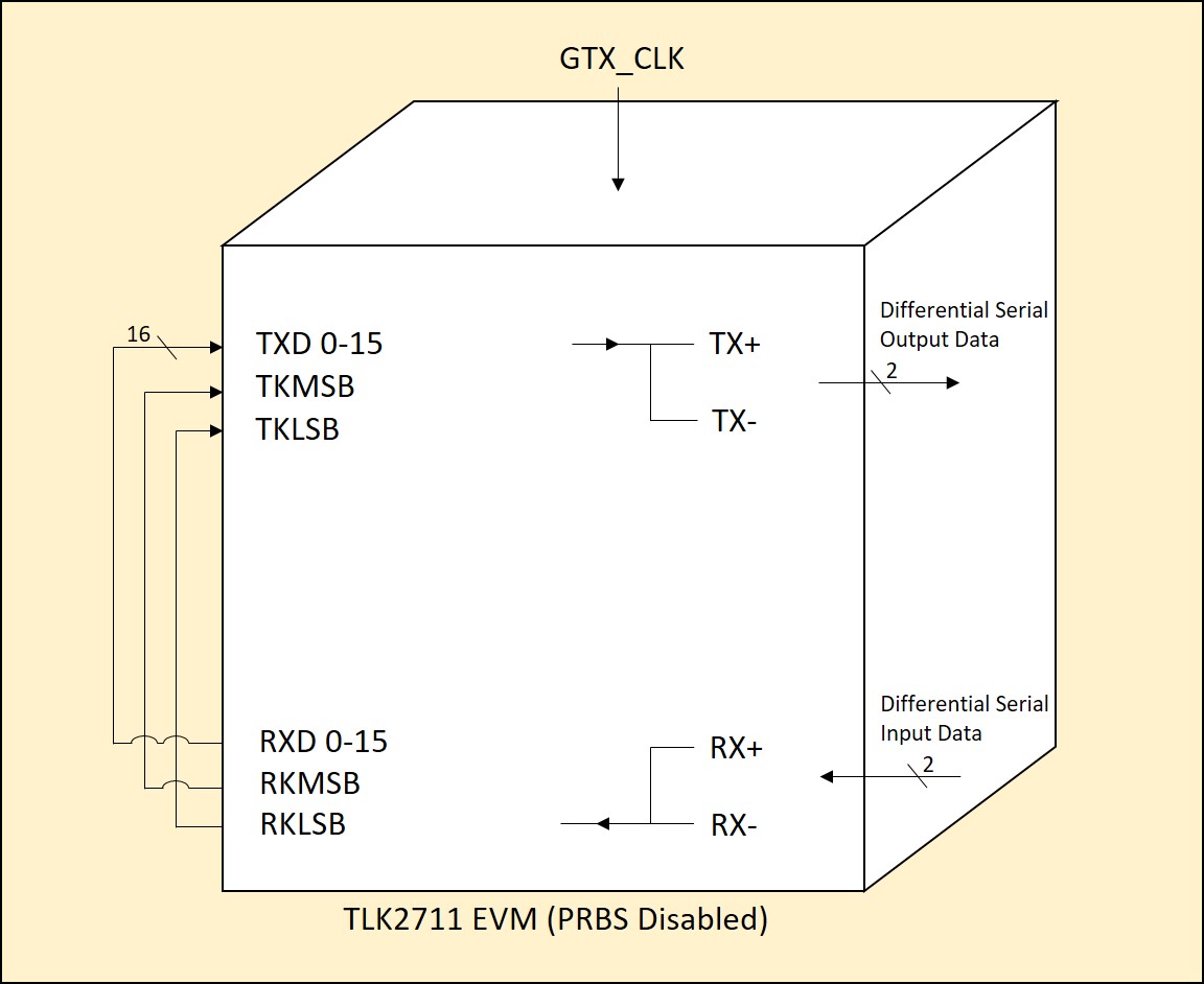

  2. Reference figure below showing planned use of TLK2711.

I have a FOLLOW-ON Question to Question #2:
Given the planned use of TLK2711 (See Figure above), AND assuming there is NO active data present at RX+/RX-, will the de-assertion of both LCKREFN and LOOPEN (as prescribed by Nasser above) still result in a successful power up (i.e. WITHOUT internal contention).

Again, I have a FOLLOW-ON Question to Question #3:
Again, assume the planned use of TLK2711 is as shown in the above figure, with valid data at RXN/P and both LCKREFN and LOOPEN de-asserted, is there a pin(s) on the TLK2711-SP that may be monitored that will tell me that the TLK2711-SP IS or IS NOT in this failed state?

  • Hi Michael,
    I believe the issue is that device receiver needs to see data transitions during power up. This can be accomplished - during power on reset - either through activating LOOPEN or if there is activity on receiver while LOOPEN is not asserted. Now getting back to the usage model you noted:
    1). Given LCKREFN and LOOPEN are not asserted AND there is no active data on RX+/RX- this may not result in successful power up. This is because device needs data transitions to get the PLL up and running.
    2).  With valid data on RXN/P and de-assertion of the LOOPEN and LCKREFN, transitions on stable RXCLK would indicate normal operating mode.
    Regards,, Nasser
