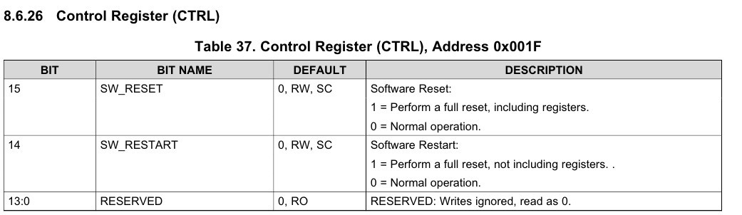

  • Hi Cecilia,
    I got an additional inquiry from customer.
    * Inquiry
    When network does not work after booting of system,
    If SW_RESET (BIT15) is forcibly enabled, network is restored normally.
    But, when SW_RESTART (BIT14) is forcibly enabled, network is not restored.
    When I checked description on the data sheet, there is only difference whether register reset or not.
    Could I get information which registers can affect to this issue (network is not work normally)?
    Could you please review and get me feedback?
    Michael

  • Hello Michael,
    Regarding reset :
    x1F[15] : Is a hard reset. It clears all registers and internal states of PHY to default state + restarts the link-up sequence.
    x1F[14] : Is a soft reset. It only restarts the link-up sequence.
